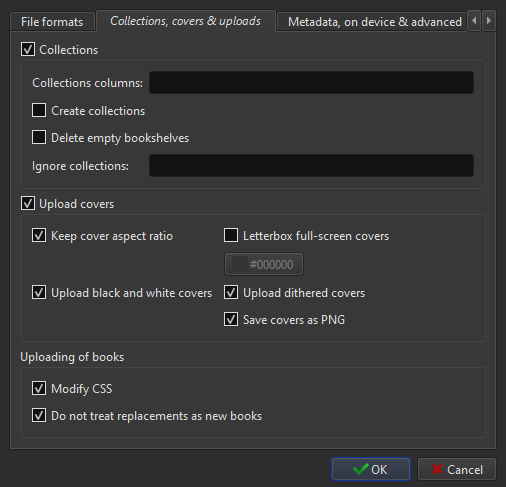

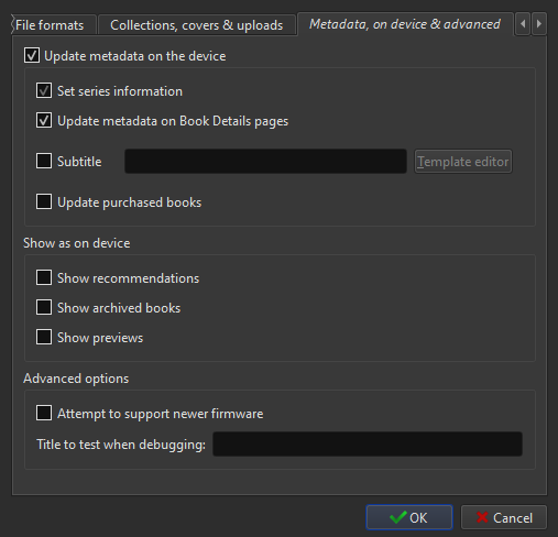

Hmm. I must be doing something wrong because I don't see an option to enable kerning in the driver settings.
Where specifically should I expect to find it? If I need to put it in the CSS file, then what CSS specifically is needed for just kerning?
Thank you!

I was thinking there was something in the CSS that the extended driver added for kerning and ligatures, but, there isn't. It might have been discussed in the drivers discussion thread. Or it was in the Kobo forum.
There is a patch to the firmware that can turn it on. I suspect the existence of the patch is why the CSS change is not being mentioned.
