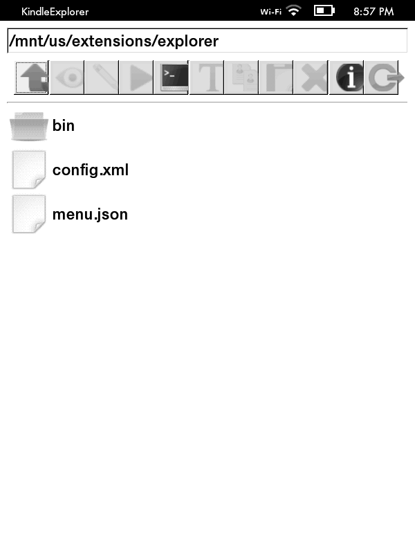

Originally Posted by anakod View Post
Please, check it in different Kindles, I run it only on my desktop.

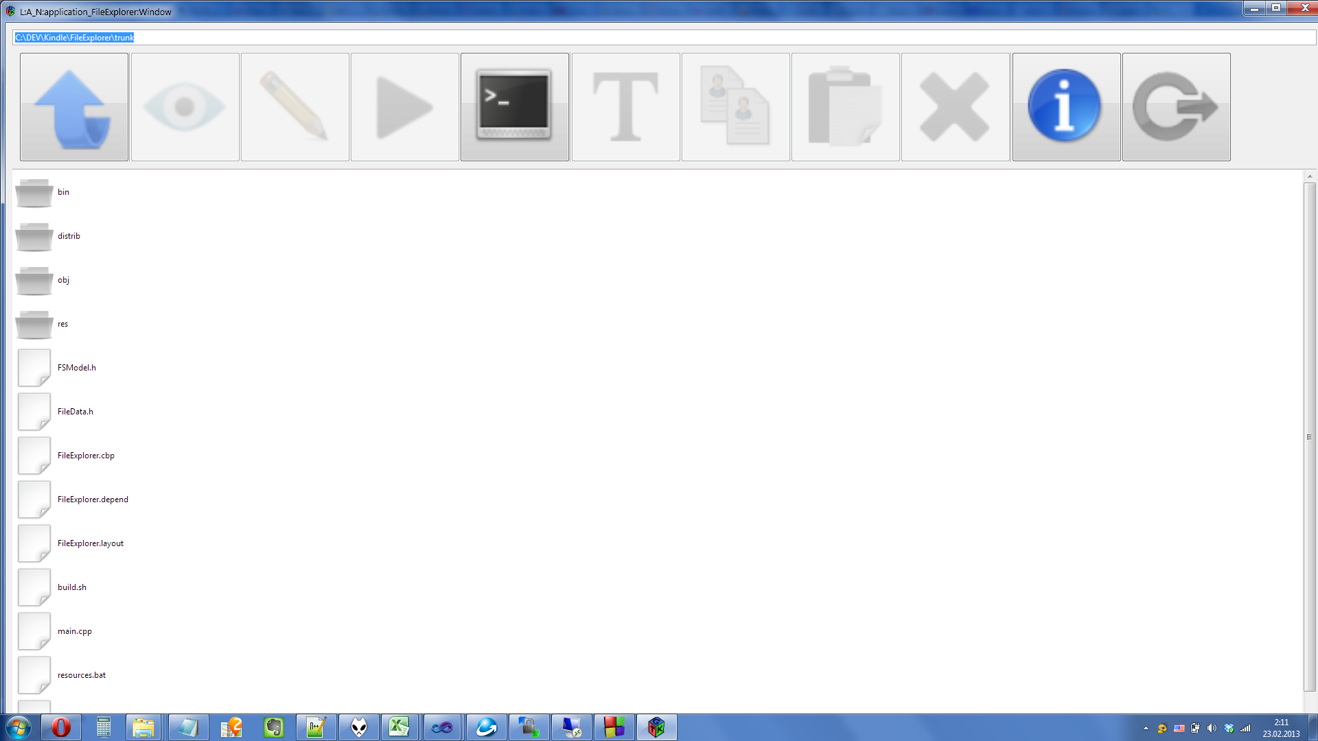

Buttons resize fine. It would be nice to resize images too, as on KT they are too large.

Question
Hmm, I'm resizing images. Don't undestend...
May be gdk_pixbuf_scale_simple doesn't work on Kindle?
