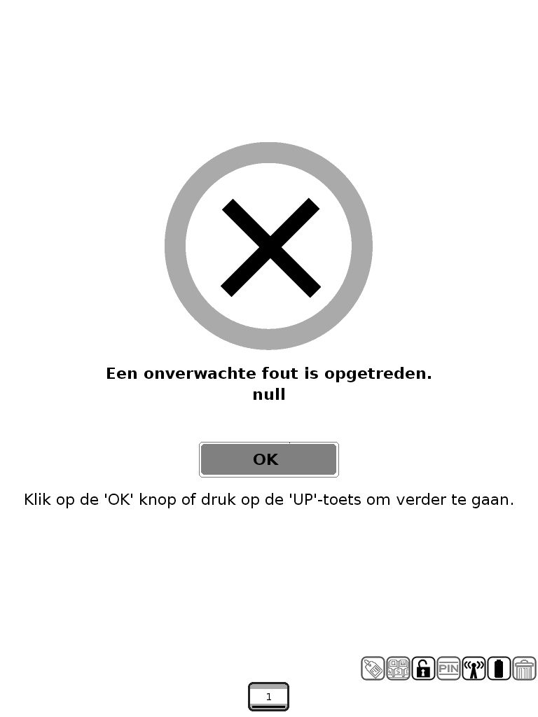

I tried to read the attached plucker-file with fbreader, but an error screen popped up (also attached).
Any clues?
The problem is that a .pdb file can contain several ebook formats and the standard registry associates this extension with the MobiPocket Reader (which can't read Plucker ebooks). I suggest updating the registry, as in Post 40, and then putting each plucker file into its own .zip file. FBReader should open the .zip and read the Plucker contents.
This particular Plucker file seems to just be a single HTML file plus images, and if that is the case a .zip of the original HTML+IMAGES would also work. The advantage of Plucker is that it can aggregate a full HTML tree into a single file.

Fantastic! It works!
Thanks!
