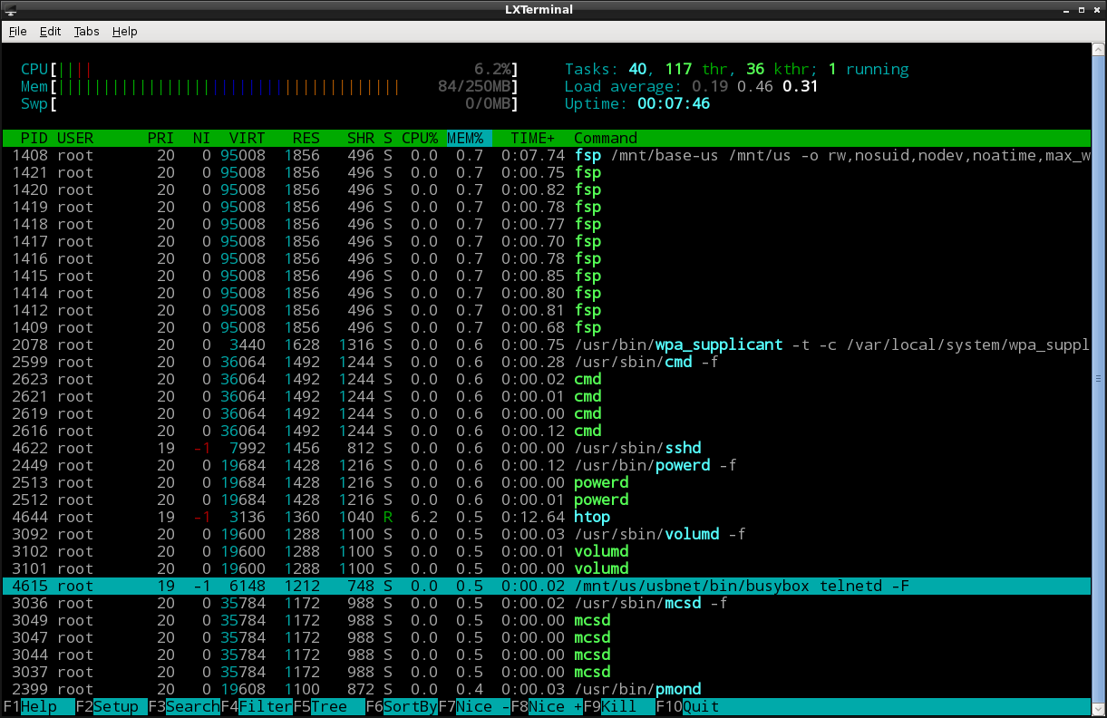

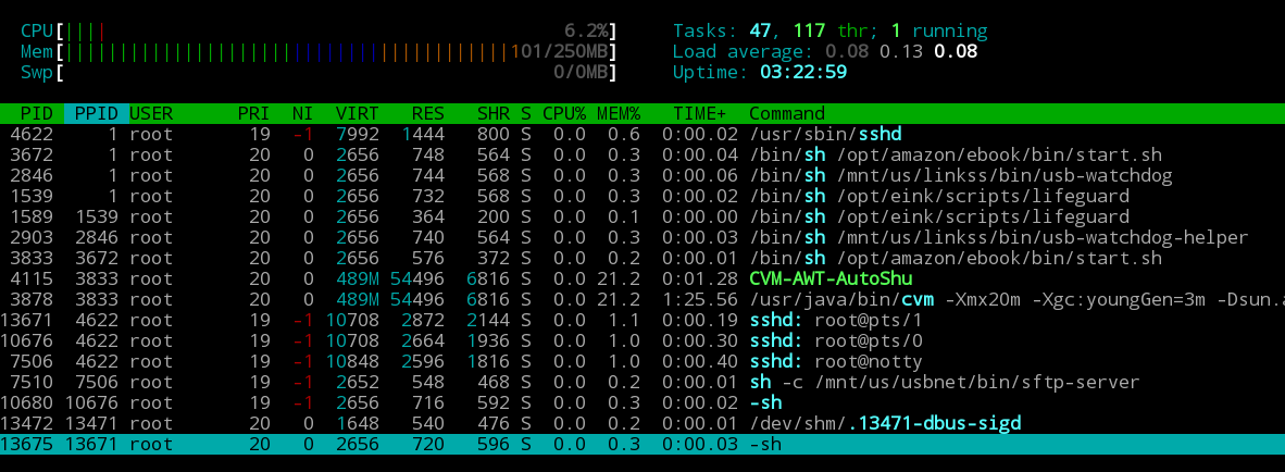

In other news I was CERTAIN the alias list just COULD NOT be this big... something should die horribly... or maybe the ram of the machine would be sucked into oblivion.
The machine hasn't been turned off for weeks so I'm going to bite the bullet and do a full restart (to give me a no-leak base memory reading) and see if something dies.
Wish me luck.
EDIT: Okay went through fine...
about a 90Mb footprint these days at boot? Is that right? anyone?

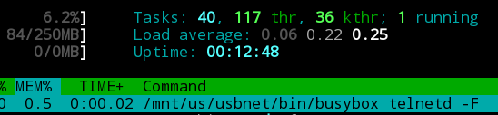

One suprise is highlighted in the picture.
Err. why is the new busybox, starting telnetd.
in fact. why is the new busybox doing anything at reboot?
has my wangle somehow convinced the system to preferentially deal out some of the STARTUP WORK to the new busybox?
sounds insanely dangerous and extremely cool.
well. it certainly WORKS and I see no actually difference YET in my performance, i.e it hasn't burst into flames...... yet.
Wish me luck.
Nice test - -
That the existing scripting would run under the new busybox.
Well, somebody had to try the re-boot function, some time.
Nice to know all of this work didn't turn in into a re-brick function.

Guess you left some skid marks on that part of the learning curve and maybe bump'd across the in-field a bit.
Why did telnetd get started?
Blame that one on lab126 slop.
An embedded system under development very often has telnetd running in the image as a development aid.
When ready for release - that telnetd may (often is) disabled.
How?
By removing the init rc.?? script to start it.
By removing the iptables port 21 "hole".
By removing telnetd from the system image.
We know that lab126 did #2 above - we can read the iptables rules.
Listing the old busybox features should tell us if they did #3 above.
What they evidently did not do was #1 above.
And when you provided (unintentionally) access to the new busybox with telnetd included, it started working again.
Duh...
Add a new input chain rule that does a -j accept for port 21 - then reload the iptable rules.
Whoot! You should be able to telnet into the box from **any** network connection (unless you qualify the source in the rule).
So much for the "I can't ssh into my K3" problem reports.
Who needs it? (ssh, dropbear, etc, etc).
Parts above are pure speculation - but it makes a story that hangs together.

A "chained continuation" has the same PID
A "child continuation" has a new PID
Can you set your (h)top to display the PPID (parent PID)?
Note: We pushed the "submit" button at the same time. There is a new post following the big one, before your reply that concerns testing.

*looks at picture one *
it's a tidied up and pared down view of htop with the noise removed.
we can see two sh processes - both mine - one for htop, one for the testing console.
a) note knc1's rightness:
me@dev ~ $ ssh root@k
# N O T I C E * N O T I C E * N O T I C E #
Rootfs is mounted read-only. Invoke mntroot rw to
switch back to a writable rootfs.
[root@kindle root]# su -h
BusyBox v1.20.2 (2012-09-03 02:06:04 BST) multi-call binary.
Usage: su [OPTIONS] [-] [USER]
Run shell under USER (by default, root)
-,-l Clear environment, run shell as login shell
duh. oh yeah. so we:
[root@kindle root]# su -l
*looks at picture two*
ah yes. a child is born, right PPID, new PID.
Let's test if the .alias was processed.
[root@kindle root]# su --version
su: unrecognized option `--version'
Happy days.
