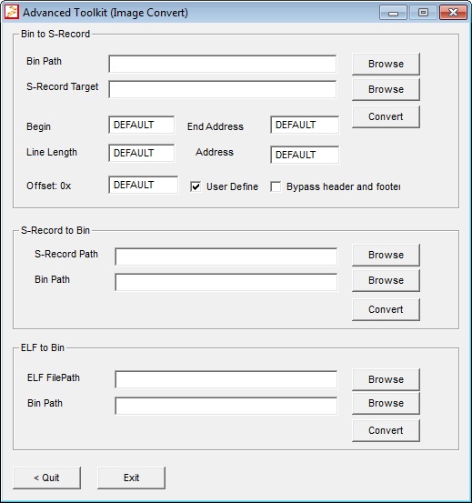

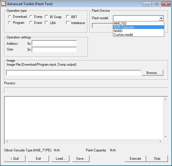

I also could be able to connect via ATK:
Image Convert:
Flash tool:
But it don't work when the kindle is in kernel panic state. It says:
Connection error. Please reset the board and make sure the board in bootstrap mode
Download failed!
