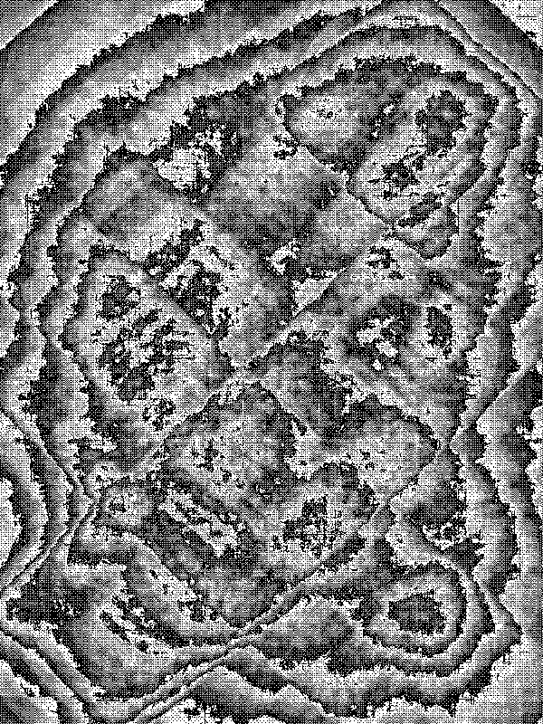

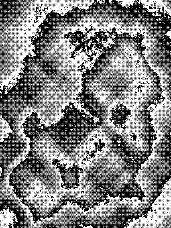

My eink ioctl() updates now work for 5.1.0 firmware, which uses a critical internal structure that changed layout but kept the same name, and broke compatibility with 5.0.x firmware. Worse, the eink header file changed and it is now incompatible with 5.0.x firmware. I removed the header files from gmplay-1.5, and that gmlib code will be used in future versions of all of my eink C code.
Old 05-10-2012, 02:43 AM   #50
kiri87
kiri87 knows what's going on.kiri87 knows what's going on.kiri87 knows what's going on.kiri87 knows what's going on.kiri87 knows what's going on.kiri87 knows what's going on.kiri87 knows what's going on.kiri87 knows what's going on.kiri87 knows what's going on.kiri87 knows what's going on.kiri87 knows what's going on.
Posts: 16
Karma: 25544
Device: Kindle 3
Here's a little demo using the code from the first post. I'm not sure if it's the right place for it, but the demo is too small to deserve it's own thread.
You really must see this running, the screens don't do justice.
[SPOILER]
With this being a "derivative work" from the first post source code, of course this is the right place for it.
It is running on my K5 -- it looks like I spilled liquid on the screen and it leaked into the eink.
Looks like a great enhancement to the "Your Kindle needs repair" message.
Maybe splice in a "fade to white, top-to-bottom" so it ends with the e-ink running out the bottom of the screen.
