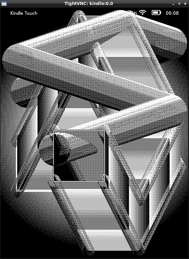

I just wanted to show support for Geekmaster here.
Excellent job on this. Some details on piping a video thru the dithmatron would be greatly appreciated. As an almost first time c coder I find the structure daunting but no doubt it will become clear with some actual elbow grease.
Compared with implementing Cross-platform tool chains this looks to be fun in the making.
Much appreciated.
I, for one, am definitely watching your work, with admiration.
If I can hookup a viddy in the sometime I will.
