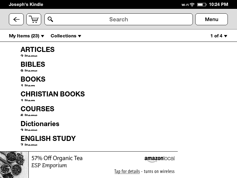

Thanks for ur help. I've done. but...

However, still I have a problem. Could u check the attached file that is an image I captured.
Do I need to remove the Ads?

Originally Posted by acajac View Post
However, still I have a problem. Could u check the attached file that is a image I captured.
Do I need to remove the AD?
Hmmm... yeah, that's pretty much what can be expected. There simply isn't enough space for everything, so things get squished together. I guess this is one of the reasons why landscape isn't officially supported on the home screen. I'm sure there's a way to fix this as well... but not right now

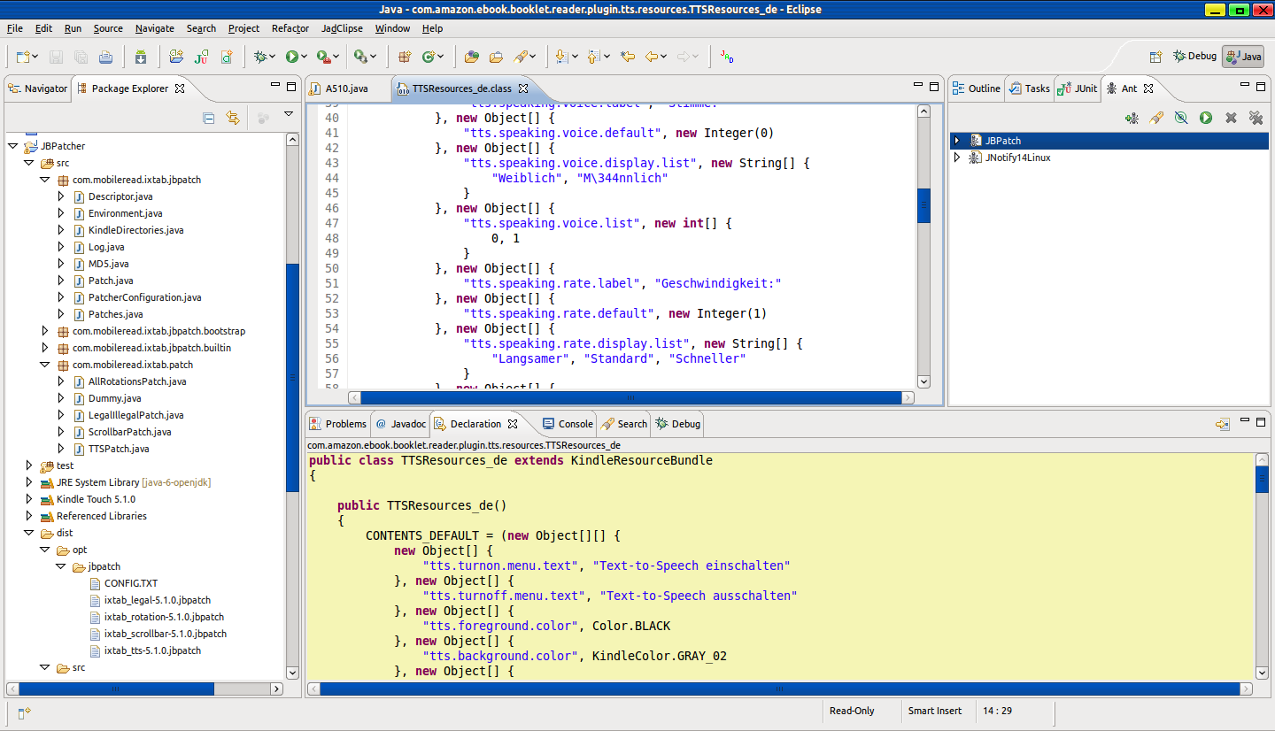

The very first step is to find which file we actually need to modify. A useful method in this case involves finding the class containing the string "Weiblich". To achieve this, it is very useful to copy all the jar files from your Kindle to your computer, and to extract them in a common folder. I leave this as an exercise to you. Once we have this, let's give it a shot:
~/kindle-touch/java/classes$ grep -r Weiblich .
Übereinstimmungen in Binärdatei ./com/amazon/ebook/booklet/reader/plugin/tts/resources/TTSResources_de.class.
The next step is to decompile that class. Because I'm lazy, I'm using Eclipse with the jadclipse plugin. Below is a screenshot of how the decompiled class looks; the things we're looking for are on lines 42-45 in the editor window.

Note how I was lazy and didn't include the MD5 checksum of the (unaltered) class in my code above. I'll fix that now, using the one from the warning message.
At the same time, I'll play around with the actual functionality a bit. In the source code of JBPatch, there is a class that I use to quickly test the effect of the patch I'm currently developing (test.TestCurrentGoal). Right now, I modified that file so its testAndDump() method reads:
//		BCClass cls = new Project().loadClass(new File(System.getProperty("user.home")+"/kindle-touch/java/classes/com/amazon/agui/swing/PagingContainer.class"));
		BCClass cls = new Project().loadClass(TTSResources_de.class);
		new TTSGermanDescriptionPatch().perform("cd9041a3105c19c2de0f61dd012872d3", cls);
		cls.write(new File("/tmp/test.class"));
You can use either method (first or second line) to load a class; it's usually easier to use the second variant, but in some cases, Kindle classes cannot be loaded into the host JVM, so then the first line is required. Anyway, all this code does is load the "target" class, apply the patch, and write it out to /tmp/test.class. You can then use "jad -o -a test.class" to decompile the result and to see whether it looks correct. This way, you can be at least reasonably sure that a patch will have the desired outcome when actually performed on the device, before even testing it there.
Back to our patch: in this particular case, we do not actually want to replace functionality (for examples on that, see essentially every other patch released before), but only two constant strings. Without further ado, below is the code to achieve that. Some useful pointers:
package com.mobileread.ixtab.patch;
import serp.bytecode.BCClass;
import serp.bytecode.lowlevel.Entry;
import serp.bytecode.lowlevel.UTF8Entry;
import com.mobileread.ixtab.jbpatch.Descriptor;
import com.mobileread.ixtab.jbpatch.Patch;
public class TTSGermanDescriptionPatch extends Patch {
	private final String[] ORIGINAL = new String[] {"Weiblich", "Männlich"};
	private final String[] REPLACEMENT_1 = new String[] {"Weiblich (englisch)", "Männlich (deutsch)"};
	private final String[] REPLACEMENT_2 = new String[] {"Weiblich (deutsch)", "Männlich (englisch)"};
	protected Descriptor[] getDescriptors() {
		return new Descriptor[] { new Descriptor(
				"com.amazon.ebook.booklet.reader.plugin.tts.resources.TTSResources_de",
				new String[] { "cd9041a3105c19c2de0f61dd012872d3" }) };
	public String perform(String md5, BCClass clazz) throws Throwable {
		String[] replacement = REPLACEMENT_1;
		Entry[] entries = clazz.getPool().getEntries();
		for (int e=0; e < entries.length; ++e) {
			if (entries[e] instanceof UTF8Entry) {
				UTF8Entry entry = (UTF8Entry) entries[e];
				for (int r = 0; r < ORIGINAL.length; ++r) {
					if (ORIGINAL[r].equals(entry.getValue())) {
						entry.setValue(replacement[r]);
						break;
		return null;
Decompiling the result of the patch suggests that it should be ok. We can simply copy the patch to the device now, and verify that it works as expected (it does).
The final thing to consider is that for this particular patch, we want to be able to support two UI variants ("female=english, male=german", and the other way around). A slightly unorthodox, but working, way, is to include this tiny bit of information in the patch filename itself: patches can access their own "id" (which is the filename), so that should do as a discriminator. This final version is not reproduced here, but already checked in.
For convenience, I'm attaching the resulting binary patch, ready for installation, as well.
I hope this was helpful to give some insight, and to encourage others to start looking around and developing some patches as well

@diba:
thanks for commenting... at least you're reassuring me that this doesn't go totally unnoticed
Yes, even in this rather simple case, it's unfortunately not as simple as editing some file with a text editor.
So first things first, you need to have the development environment ready for this: get a Java Delevopment Kit [JDK] (NOT only a Java Runtime Environment [JRE]) from http://www.oracle.com/technetwork/ja...ads/index.html
Since Oracle has bought Sun, the site has become a mess but you should still find your way through.
Second, you probably want to get Eclipse, which is an Development Environment for Java. Get it from http://www.eclipse.org/downloads/pac...pers/indigosr2
Third, if you have never used any of these tools, create a "hello world" project for yourself (I'm not kidding), and make sure that you get to compile and run a "Hello World" application.
Fourth (... and that is indeed a huge leap from "third"), make sure that you can import the project from git. That involves having git installed in the first place, and cloning and synchronizing to the remote repository from your local installation. The procedure to do so is not complicated, but it really depends on your local configuration, so I can't give any boilerplate instructions here.
Fifth , you have to make sure that the JBPatcher project actually has its dependencies satisfied. Essentially, that only means that you must have a "User Library" called "Kindle Touch 5.1.0", which includes all the jar files from the KT5.1.0. If you have a copy of your Kindle's /opt/amazon/ebook/ on your computer (strongly recommended), then that should do. You only have to set up that User Library once.
Once you have the JBPatcher project "error-free", you should be able to follow the instructions without any problem, and actually to write your own patches
