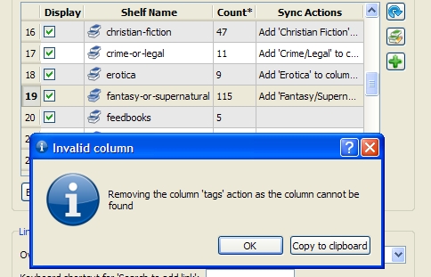

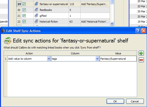

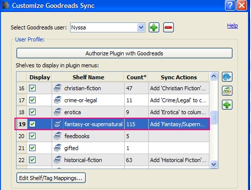

I've seem to have stumbled on to something else....
I went to edit one of the sync actions to make sure it was ok, but when I went to "Edit Actions" I got an error.
Please see images:
Image 1 - "Customize Plugin"
Image 2 - The error I received
Image 3 - The way I am mapping the tags & shelves
I double checked my mapping when I realized that my books were not being added to those shelves. (The Amazon shelf which is a Yes/No in Calibre works perfectly).
Sorry. I tried to get this up before you updated, but I had trouble with the images.

Hmmm... that one must have been in there for a while, I haven't gone anywhere near that code. I have just replaced the zip file on the first post I put up a few minutes ago (same 1.3.2 version number). Hopefully that should resolve that issue too.

You understand it is the "Edit Shelf/Tag Mappings" screen you should be going to, not editing sync actions for those shelves right?
Post the exact details of what you have setup (screenshots will help) - the contents of your Edit Shelf/Tag Mappings screen, are you using a custom column or the normal tags column, if a custom column what it has been configured as (it should be "Comma separated text, like tags, shown in the tag browser") and what your values are for that particular book in that column.

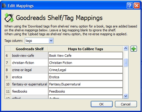

Here is my "Edit Shelf/Tag Mappings" set up. the only thing I changed was "tags" to "#store" when tapplicable (Book View Cafe & Feedbooks) in the screen shot. The rest were set on "tags" .
Edit: How do I reset the plugin? Maybe I messed up in the mapping somewhere, but I just can't see it.
Starting fresh might help. Would uninstalling then reinstalling the plugin, work?

It shouldn't really be necessary to "start again", you look to have setup lots of mappings etc so it would be painful to do that. Just FYI to do that the easiest way is to just delete or rename the Goodreads Sync.json file from your plugins folder.
You didn't say the datatype of your custom column etc. What I suggest you do is try the exact example that I described above in post #49. Create a fake book if you want to, link it to Goodreads, start with one simple tag on it as per that Science Fiction example and follow the steps exactly. If you can get that to work then you can experiment a bit more and see if you can figure out why others are not working. If you still can't get anywhere send me a PM with your email and I will send you a special debug build that will print some output to give the details.
