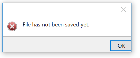

This is a clip of the error pop-up
Name:	save file error.png

Originally Posted by oenopion View Post
Hi Toxaris,
File sent via IM. I just tried it again, and it did do a save to my OneDrive default location. Then that unusual error popped up. Hopefully the log file shows where the error is.
Thanks for taking a look at this.
-O
Thanks for the log snippet, it helped me to pinpoint the location in the code that is generating the error. I still don't understand why this error pops up. The code basically checks if the file with that name exists or not. If not, it gives the error.
Now, I have a sneaky suspicion which I am going to test tomorrow (as I am going to bed in 5 minutes), but I suspect it is caused by an incompatibility between OneDrive and the .Net 4.0 framework. I suspect that not a normal filename is used which causes this. If this is the case, it should work if the file is saved at a 'normal' location. I will test if this is the case. If so, I have to think really hard about a workaround.

BINGO! I saved to a different location and it worked like a charm!
I think you're right, for when I save it to my OneDrive location, it actually first sends it to a weird temp location, with a temp file name, instead of to my C drive location. Then to the cloud and back to my C drive (I think?)
Anyway, for me this will work fine, since the OneDrive is more to keep all the ongoing writing backed up.
But let me know if you want me to try anything, and or send you any extra info.
Thanks again, Toxaris!
-O
Always good to hear when a suspicion is correct! I will think about a work-around for this issue. Can be difficult, since my development environment is a Win7 with Office 2007 (lowest supported version) and this is probably only the case on Win10 due to the integration with OneDrive. I will put it on the issue list, I will find a solution.
