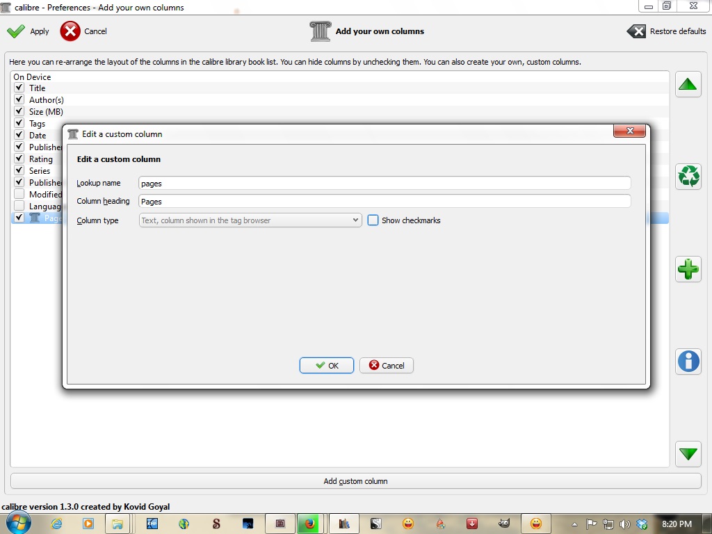

Old 09-19-2013, 08:42 PM   #573
crich70
crich70's Avatar
Posts: 11,311
Karma: 43996130
Location: Monroe Wisconsin
When I get to column type it's grayed out and when I click on Custom Column all I get is an empty drop down box that I can't edit.

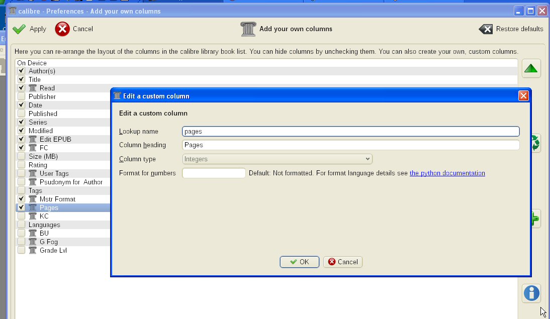

Here is the screenshot of my 'pages' col. Note the formats box
Mine looks a bit different for some odd reason.
Name:	Calibre columns.jpg
Old 09-19-2013, 09:32 PM   #576
Posts: 31,731
Karma: 64144480
You need to delete that column:
You accidentally made it Text Type and you can't change a column type once made, only add options that apply
As indicated in the first post you have to select the proper type (highlighted in red below) of column when you first create the column. This means you need to follow theducks advice and create the column anew.
Creating a Count Custom Column:Follow these instructions to configure a page count column as per screenshot 3 below. Perform similar steps for a word count column.
Add a custom column with Preferences->Add your own columns. I suggest the following values:
Lookup name: pages
Column heading: Pages
Column type: Integers
Formatting: {0:,}
For a readability statistic, an example is as follows:
Lookup name: gfog
Column heading: Gunning Fog
Column type: Floating point numbers
Formatting: {0:.1f}
