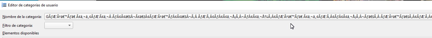

I usually use the Utility GUI Tool "Copy User Category from Source Library to Target Library", until version 1.0.167 I had no problems, but in version 1.0.170 it doesn't work, at least to me, all the tests I did using Caliber 4.8. I attached some images so you can see what happens. Tell me if you need other data.
Apart from this matter, could an option to copy all categories at once be added to this utility, in the future, so as not to have to copy one by one. This would be wonderful.

My JS test categories had no diacritics, such as Spanish accents. Hence, I did not encounter any copy-category testing issues caused by changing JS to be compatible with Calibre 4.99+ that uses Python 3. My fault. I will add some diacritics to a test user category, fix it, and upload the new version of JS later today.

The "Copy User Category to another Library" GUI Tool uses JSON, which changed just enough recently to unintentionally cause a copied UC to be "renamed" into garbage characters if the original name had non-English characters. The copy worked fine, but the UC name was garbled. Fixed.
Tested in both Calibre 4.8 and Calibre 4.99.3

I tried this new version and it works perfect !!!

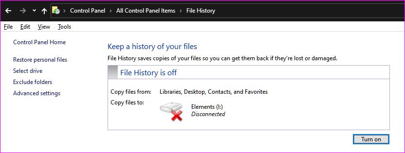

Question, do you have problems with creating restore points and using previous versions of files? I was under the impressions (after trying Windows 10 many times) that you needed an external drive always connected to your computer to enable that feature.
This was why I stayed with Windows 7. I noticed that restore points and previuos versions of files weren't being made unless the external drive was connected.

File History and Restore points are different beasts.
RP is for OS changes and usually fires off on any program install the invokes UAC
OTOH File History is a safety net, and wants to keep files elsewhere.
You can change that place, as long as it is external
