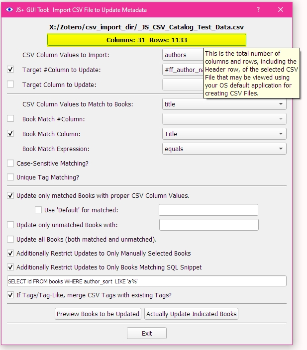

Version 1.0.166 Enhancements to GUI Tool "Import CSV to Update Metadata".
Version 1.0.166 -2019-10-28 Enhancements to GUI Tool "Import CSV to Update Metadata".
See the attached image showing the new pushbutton.

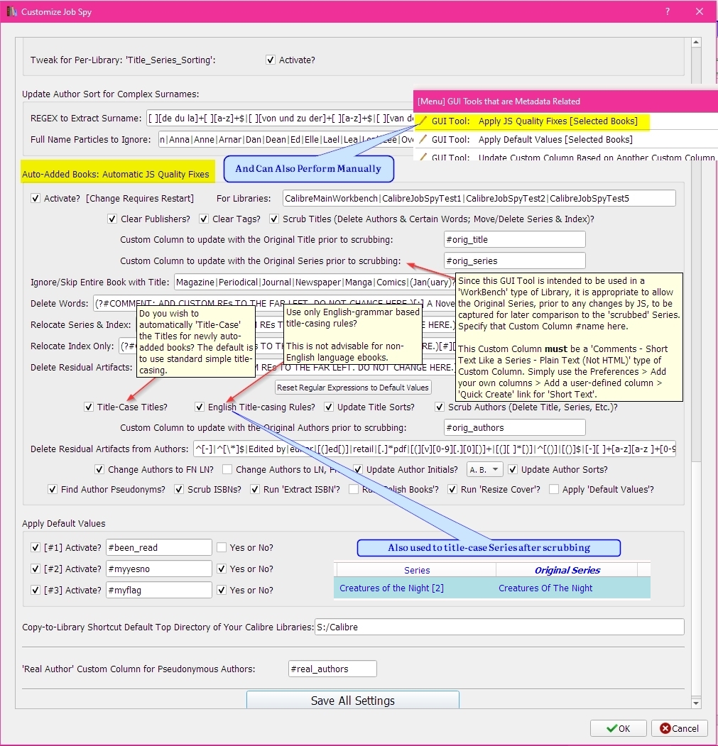

JS Quality Fixes: Future Enhancements
If there is a space before the words "The", "And", "Of", and "To" I don't want them to be title cased
Yes, and the advanced title-casing logic in my Q&S add-on/plug-in does that (and much more) based on English grammar rules, since Q&S is designed specifically for English (only). However, JS does only a simple title-casing like standard Calibre does since the English grammar rules often break non-English titles, which is unacceptable. What I will do is copy the Q&S logic to JS, and then add an option to use either it or the standard (simple) title-casing.
Books with "&" in the title or series have been getting the symbol deleted.
Remember that the #orig_title column has each book's original title before changing. It exists so you can easily see before then after fixing. I put the #orig_authors and #orig_title columns next to the real columns. When I move the fixed and clean books from my WorkBench Library to my pristine Library, those custom columns are excluded automatically by another JS tool's customization option to do so.
I will add an #orig_series column capability too. I have never needed it.
The "&" symbol in a matching pattern is likely deleted by one of the regular expressions defined in JS Customization. I used over 500 test books with trashed-out metadata of all types to build those rules, plus hundreds of "clean" books to refine the rules. Nevertheless, sometimes a book gets "overcleaned", which is why I have the #orig_authors and #orig_title automatically populated if you define them per JS Customization so that they can easily be copied over the "overcleaned" values.

Version 1.0.167 -2019-11-02 Enhancement to GUI Tool "Import CSV to Update Metadata" to save the last 12 CSV files' options for future automatic loading when the respective CSV is again used; Original Series custom column option added to Customizing for JS Quality Fixes; English title-casing option used for both Titles and Series added to Customizing for JS Quality Fixes.
See the attached.
DaltonST

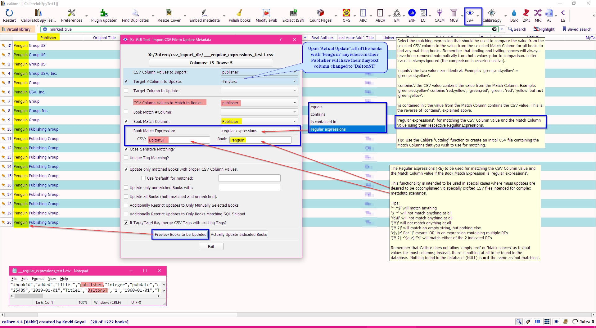

Version 1.0.169 Enhancement to GUI Tool "Import CSV to Update Metadata"
Version 1.0.169 -2019-11-25 Enhancement to GUI Tool "Import CSV to Update Metadata" to add new matching expression of "Regular Expressions", including a new CSV Matching Regular Expression and a new Book Matching Regular Expression.
See the attached image.
DaltonST

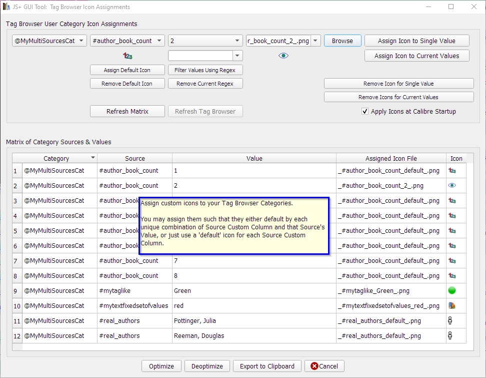

@DaltonST
Q about Customize Tag Browser Icons:
Is it not possible to assign icons to subgroups?
Thanks!
gerhaher is offline   Reply With Quote
Old 11-28-2019, 01:01 PM   #548
DaltonST
Deviser
DaltonST's Avatar
Posts: 2,265
Karma: 2090983
Join Date: Aug 2013
Location: Texas
Originally Posted by gerhaher View Post
@DaltonST
Thanks!
See the attached example.
Icons can be assigned by Category, Source and Value. If a subgroup is defined as a Source, then you can assign an icon to that "subgroup". If a subgroup is a Sub-Category, then, no.
Standard Calibre only allows you to assign icons at the Category level, and nothing below that at all.
DaltonST

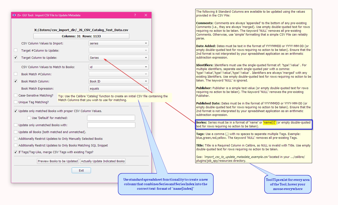

Import metadata - series_index
I'm trying to rebuild my main library from raw sources. I'm exporting mobi-asin, title, authors, series, series_index to csv, then using GUI Tool "Import CSV to Update Metadata" to match on mobi-asin. Is there any way to update series_index in the library from the csv file?
jjmgreen is offline   Reply With Quote
Old 12-04-2019, 10:59 AM   #550
DaltonST
Deviser
DaltonST's Avatar
Posts: 2,265
Karma: 2090983
Join Date: Aug 2013
Location: Texas
Updating Series[Index] via CSV Tool
See the attached image. ToolTips are required reading.
DaltonST
DaltonST
Thanks - will play with custom column to create a <series>[<series_index>] datum to export for metadata transfer
