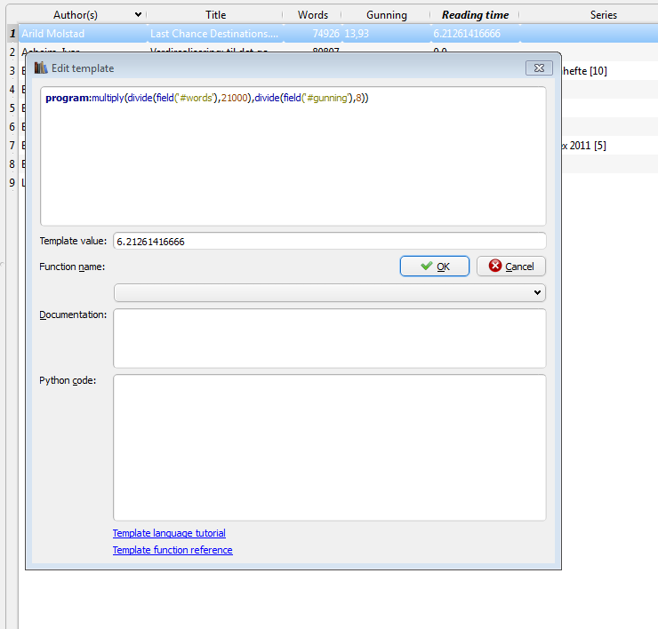

Originally Posted by zoorakhan View Post
TLDR: How to make a custom column that takes value of a custom column (word count) divides it by a constant (3600) multplied by another constant (my WPM i.e. 350). Then the value produced is to be multiplied by value produced by dividing the value in another custom column (Gunning Fox Index) multiplied by another constant (Index Correction Factor, which is to be 8 in my case)
The calibre template language should be more than adequate to do these calculations.
Create a new custom column called Reading time or something, choose "Column built from other columns" as type. In the template field, use
program:multiply(divide(field('#words'),21000),divide(field('#gunning'),8))
I hope I got your formula right. 21000 is your base WPH speed, and Gunning index is divided by 8 to get your gunning factor. To tweak it, the easisest is to double-click a field in the column "Reading time", and you can change the formula while seeing a live preview.
Change #words and #gunning according to your custom column names.
You'll probably want to format the number, to get two decimal digits you can wrap the template in format_number, ie
program:format_number(multiply(divide(field('#words'),21000),divide(field('#gunning'),8)), '{0:.2f}')
Hope this helps
1. Formula encountered a error because I had word count column set up with thousand separators (eg. 123456 is shown as 1,23,456). Had to erase the format for numbers for that column and values showed up like magic. (it was magic for me as i had struggled for multiple hours with import list plugin method. your method was much more noob proof)
That is probably because the field is delivered to the function as a string, but because of weak typing it is treated as a number by the divide function. If your formatting for the words field was {0:,}, you can keep the separator for display but replace the comma in the formula in this manner:
program:format_number(multiply(divide(re(field('#words'),',',''),21000),divide(field('#gunning'),8)), '{0:.2f}')
