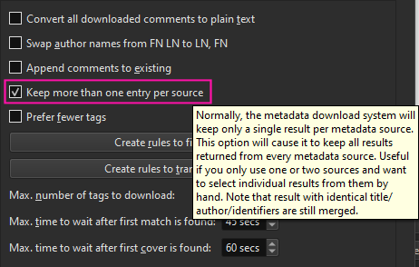

Google and Amazon seem to be different results, as there is only one author on Google and two on Amazon.
IMHO when Calibre finds optimal matching, it merges all information into one large entry.
Note the "See at" entry on the right side of your screenshots:
  • When found it on Google, we see that it's Google.
  • When found it on Amazon, we see that it's Amazon.
  • When found in Goodreads, we can see that all information has been merged.
See hint for the main options when fetching metadata.

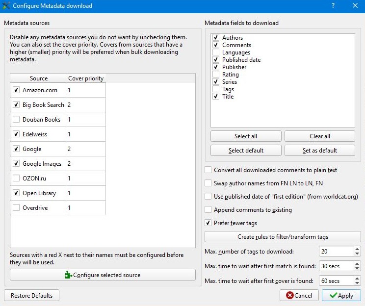

I've been mistaken, it was on the general metadata prefs page as shown here
I'd assumed that with Goodreads carrying both dates that it was a control for Goodreads Metadata Source. My Error.
I found thisin the changelog where that option has been removed from Goodreads in general. I'd previously always gotten the edition-specific date from Goodreads into the pubdate column and had used a separate column for the year of first publication of the work. I have to assume this change was the culprit.
For an example, when I'm looking up John Berger's Ways of Seeing via the ISBN '9780141035796' Goodreads Metadata Source pulls the date 1972, where the corresponding Goodreads page lists the first published date as 1972 while this specific ISBN was published in 2008.
If the ability to prefer either the first published date or the edition-specific date could be added to the plugin I would be appreciative but as it hasn't came up once in the time since I also appreciate the limits on the time and energy of people who maintain these projects.
Last edited by issybird; 01-11-2021 at 05:12 PM. Reason: Oversize image. Please read the guidelines.
rglrglrgl is offline   Reply With Quote
Attachment 184692
That explains it. From memory, Worldcat was removed as the free version of the API was either removed, or restricted in ways that made it impractical for calibre (though I might be mixing that up with another site).
I suppose this hasn't come up as most people are more interested in the first published date. It shouldn't be hard to do. I'll put it on the list of things to look at the next time I need to touch the plugin.
