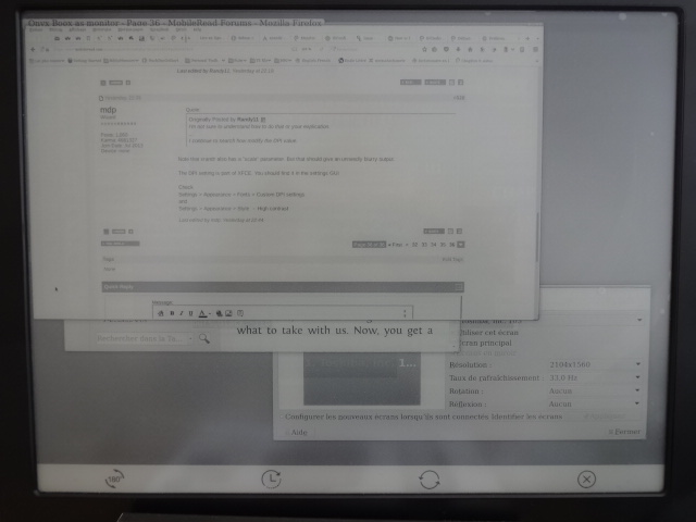

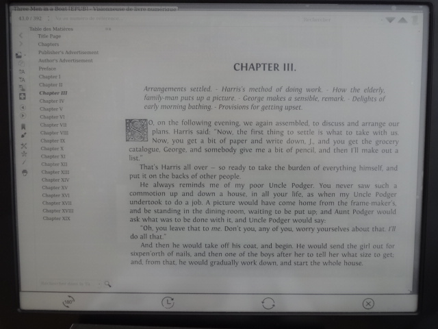

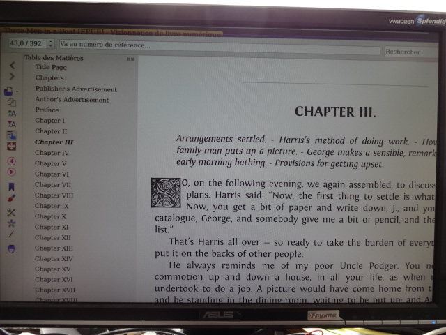

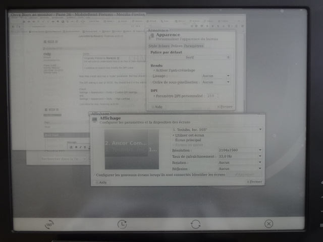

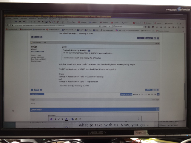

Thanks ! I've found the settings, but it's not very useful because if I can read on the Max2, the font is too big on the LCD screen as you can see on the pictures : Max2/LCD and screen configuration taken on the Max2.
It could be interesting to can change the DPI value or resolution only for one screen...
