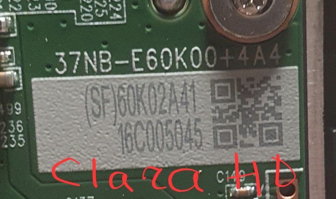

Kobo Clara HD
https://fex.net/uk/s/cblkc2a
Kobo Clara HD 8GB image
Mixeveh is offline   Reply With Quote

Originally Posted by Mixeveh View Post
https://fex.net/s/ed8tmyb
Kobo Clara HD 8GB image (new link)
I took a look at your image which is in a 3,111MB .rar file. Some items I noticed
  • at location 0x200 in the image, your serial number is present
  • the FAT32 partition was not cleaned up before the image was created
  • the image has NickelMenu, KOReader, Plato and KFMON installed.
I set the serial number at 0x200 in the image to N249123456789 and wrote the image to a temp block. I then copied the visible contents of the FAT32 partition to temp storage, zeroed the partition and copied the visible contents back to the partition. After doing this I checked and wrote a new copy of the disk image. Using 7Zip to compress the image into a .zip file gave me a 484MB file which is a lot smaller than the 3,111MB .rar file.
The zipped image file can be downloaded from koboclarahd_8GB.zip if you care to.
Wiping the FAT32 partition removes a lot of deleted/orphaned data which removes the ability to use an undelete utility to recover deleted books, etc. and allows a archive utility to store that space very efficiently.
