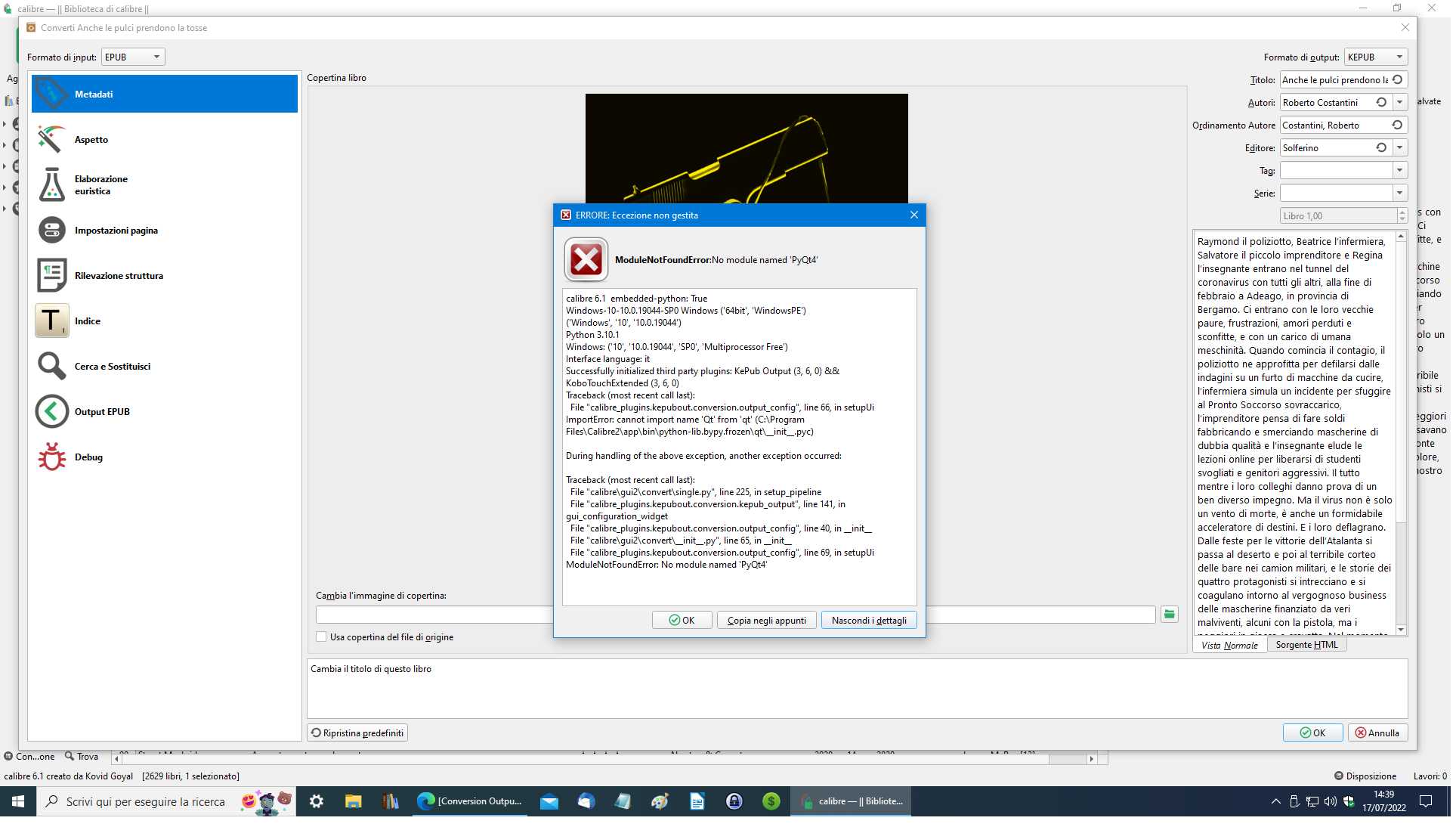

Conversion to kepub is working fine here with calibre v6.1. And it was with calibre v6.0.
What exactly triggered this? Do you have kepub as the default output format? Was it when the conversion dialog opened? Or when you select the kepub options? Or something else?
When the conversion dialog window open the default output format is epub.
When I select kepub this message error appears
calibre, version 6.1.0
ERRORE: Eccezione non gestita: <b>ModuleNotFoundError</b>:No module named 'PyQt4'
calibre 6.1 embedded-python: True
Windows-10-10.0.19044-SP0 Windows ('64bit', 'WindowsPE')
('Windows', '10', '10.0.19044')
Python 3.10.1
Windows: ('10', '10.0.19044', 'SP0', 'Multiprocessor Free')
Interface language: it
Successfully initialized third party plugins: KePub Output (3, 6, 0) && KoboTouchExtended (3, 6, 0)
File "calibre_plugins.kepubout.conversion.output_config ", line 66, in setupUi
ImportError: cannot import name 'Qt' from 'qt' (C:\Program Files\Calibre2\app\bin\python-lib.bypy.frozen\qt\__init__.pyc)
During handling of the above exception, another exception occurred:
File "calibre\gui2\convert\single.py", line 225, in setup_pipeline
File "calibre_plugins.kepubout.conversion.kepub_output" , line 141, in gui_configuration_widget
File "calibre_plugins.kepubout.conversion.output_config ", line 40, in __init__
File "calibre\gui2\convert\__init__.py", line 65, in __init__
File "calibre_plugins.kepubout.conversion.output_config ", line 69, in setupUi
ModuleNotFoundError: No module named 'PyQt4'

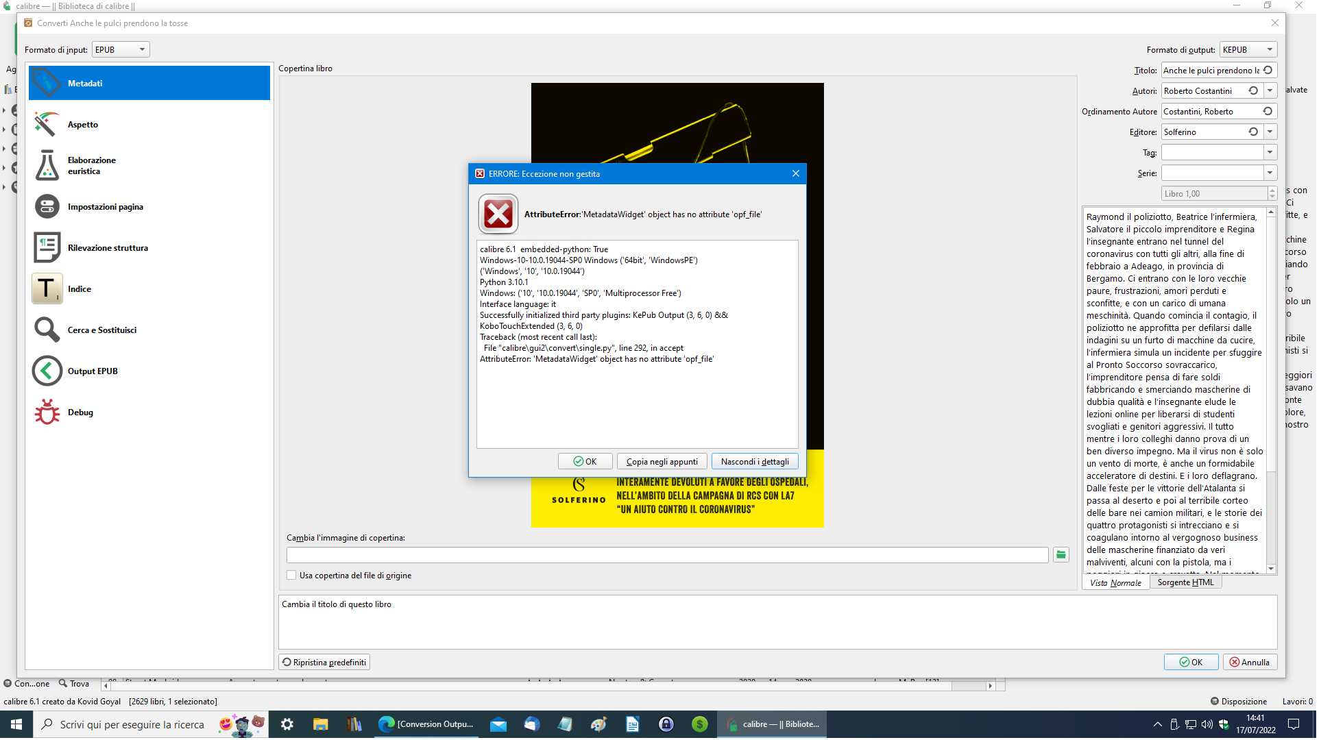

Then I click anyway on OK and this new message follows
ERRORE: Eccezione non gestita: <b>AttributeError</b>:'MetadataWidget' object has no attribute 'opf_file'
Python 3.10.1
File "calibre\gui2\convert\single.py", line 292, in accept
AttributeError: 'MetadataWidget' object has no attribute 'opf_file'

Sorry, I am not sure what you are saying. Has this occurred again with a different temp directory? Or have you changed it back to Windows default and it is happening again? In either case, if you are getting permission errors again, Windows might have decided the new calibre version is needs the permissions applied. I haven't had a problem here, but, I have changed where the temp directory is for Windows.
I tried changing a few times the temp directory also in different hard disks.
Now the problem is still there but not with every book but randomly.
This is the debug log of a session where I try to convert different books.
Some success other fails.
Here is the calibre log.
PS; sorry for my english

@giododa: What exactly are you trying to do? Step by step directions. PyQt4 imports are only attempted when PyQt5 imports fail; PyQt5 has been present since calibre 2.0 and Kovid said that PyQt6 will automatically be imported when trying to use PyQt5 in calibre 6. I've tried some things involving the conversion GUI in calibre 6 and I can't reproduce this error.

When I try to convert a book in my library (epub) and I select kepub in the output format the error message popup (see image)
Then I kit OK to close the error message and hit OK in the conversion window and another error message appair (see image1).
I have reinstalled yesterday Calibre latest version and KepubOutput plugin.
