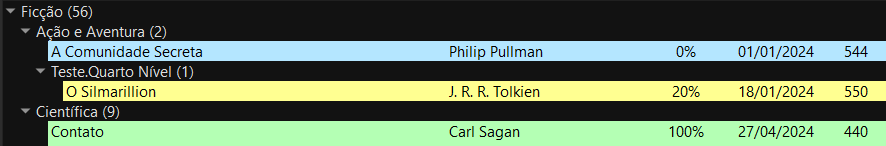

Originally Posted by sandrilea View Post
I am delighted that you can have more than one genre level. Is it supposed to work with three levels?
Yes, up to three levels.
When I tried it, there was just the word for the subgenre with the number zero in parenthesis in genre view and the book with this genre won't show up.
When you have more than 3 levels, the remaining levels are grouped with the third level. Something like this:
The complete tag is 'Ficção.Ação e aventura.Teste.Quarto nível'.
If this is not the case for you, send me your database file (json), so I can take a look and figure out what's going on.

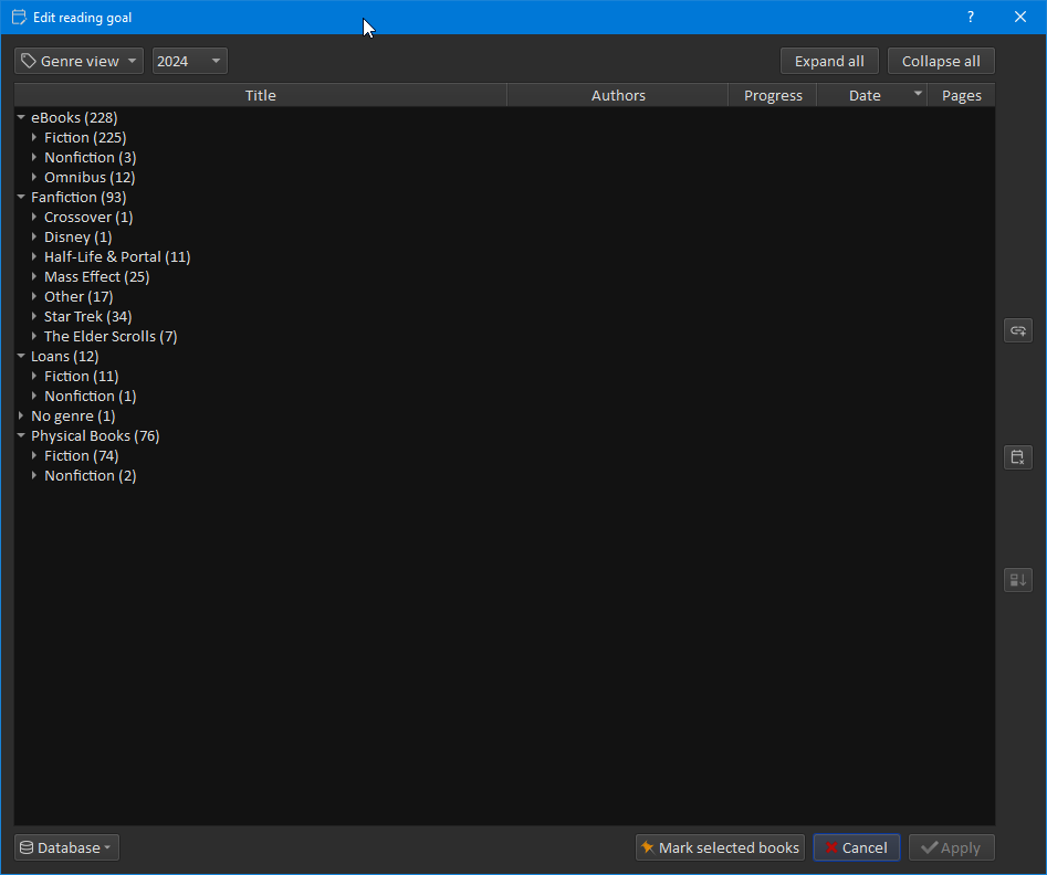

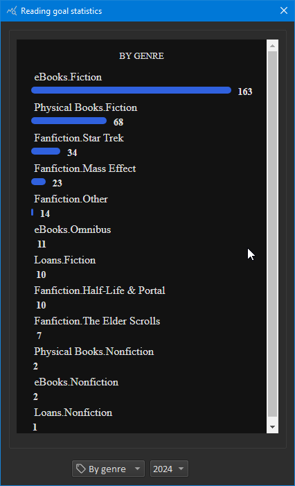

Old 08-25-2024, 04:24 PM   #509
ownedbycats
Custom User Title
ownedbycats's Avatar
Posts: 11,526
Karma: 81412473
Join Date: Oct 2018
I've got a question. My column "genero" (for genre classification) is created like this: "{tags:re( / ,.)}", as my tags are split by " / ". When I show the statistics, however, I get something like this: Mistery.Cozy 36. How can I show it in a hierarchical way?
Hierarchy works in Edit, but not Statistics. I suspect there's technical limitations for this.
Name:	2024-08-25 16_21_47-Edit reading goal.png
ID:	210412   Click image for larger version
Name:	2024-08-25 16_22_04-Reading goal statistics.png
Old 08-25-2024, 06:03 PM   #510
thiago.eec
Posts: 1,311
Karma: 1436993
Join Date: Dec 2016
Location: Goiânia - Brazil
Yes. The hierarchy view is just for the Edit Reading Goal dialog. In the Statistics dialog we have size limitations, also the problem with the graphics starting/finishing with an offset, that would make them look weird to me.
P.S.: @ownedbycats, one question about your statistics window: can't you resize it to lose the scrollbar? It is supposed to be freely resizable and to remember the geometry, but maybe there is glitch that I don't know about.
