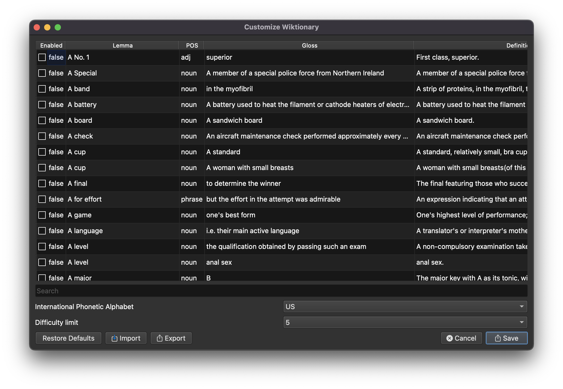

Now I just need to figure out how to generate it with "level 1" difficulty. I have previously connected a kindle and hit the customize word wise, I'm not sure how to use this feature honestly.
That's for Kindle books, you need to click the "Customize EPUB Wiktionary" button. In this window, you can set the difficulty limit to 1.
Name:	Screen Shot 2022-10-07 at 07.28.37.png
