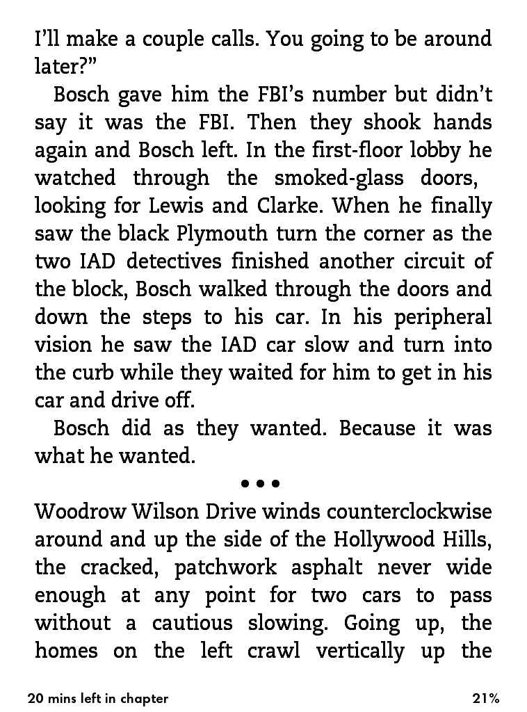

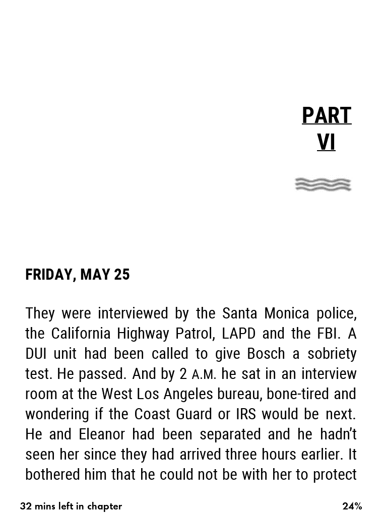

Thank you @NiLuJe I got Bookerly & Roboto Sans installed, Roboto is a huge improvement over everything else I've seen on a Kindle!
Now, while I have you here... Lol, can you tell me if it's possible to hack the margins on my PW1 with 5.6.1.1 firmware, without first seeking a degree from MIT? I've searched and searched, but to no avail.
ID:	163968   Click image for larger version
