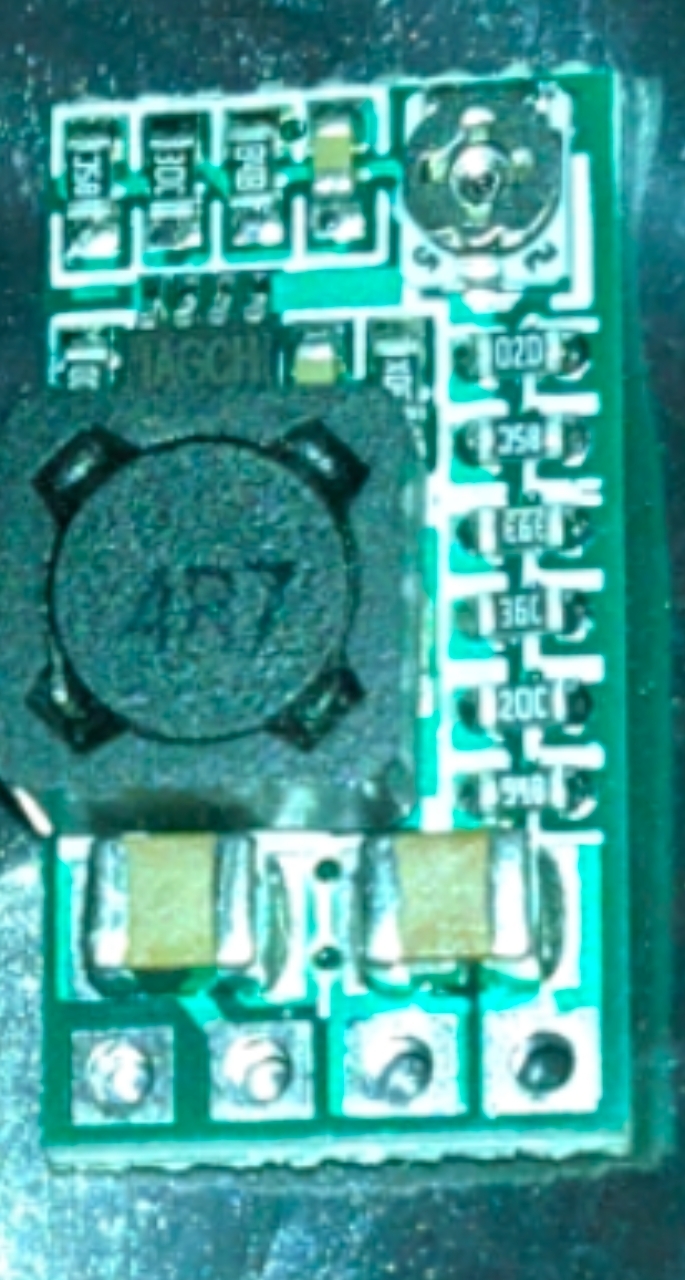

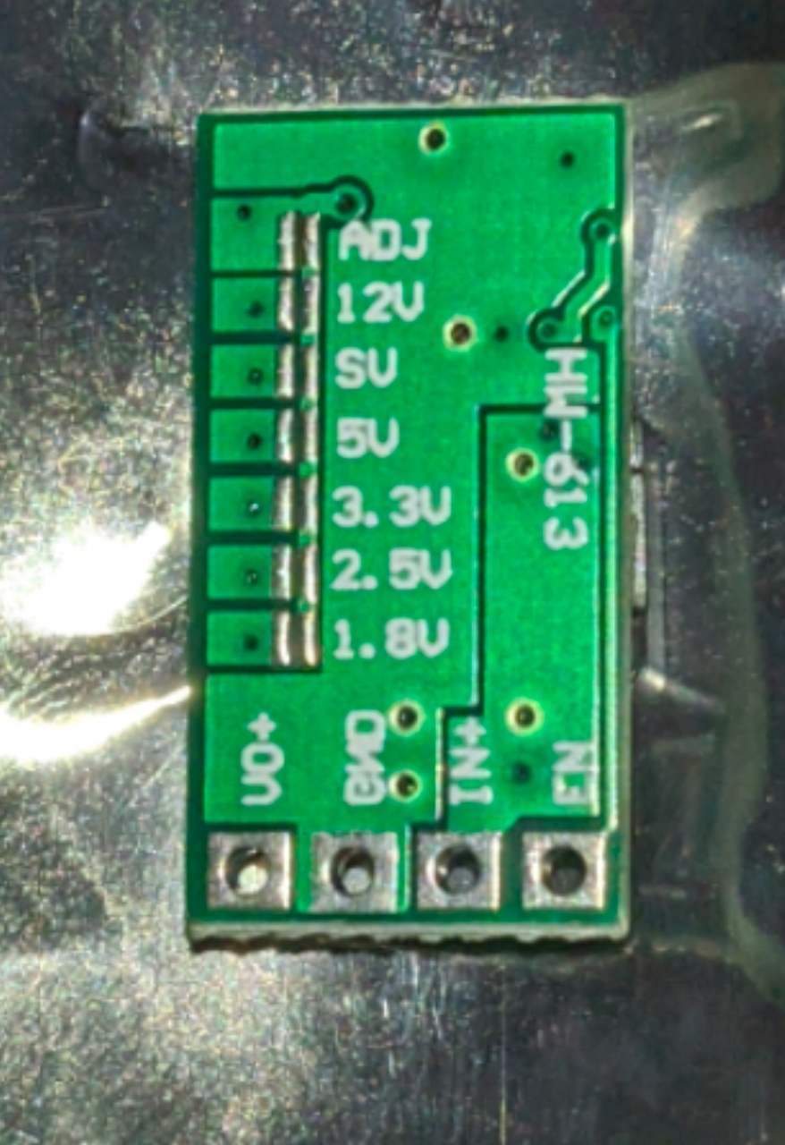

Help with a prolific cable!!!
I couldn't get a ftdi cable in my local market, unfortunately the online prices were way too expensive due to the shipping+customs it was triple the price of the actual wire/connector board. Either ways, this is what I could manage to get from my place.
It's a counterfeit PL2303 XA/HXA (HX rev A) cable. Yes, it's not even the original one because it's also a discontinued piece. With some googling I managed to get the cable working fine at least.
My only issue is that the cable documentation states the power supply output to be 3.3v to 5v. There's no 1.8v through it. What should I do about that? The seller told me to buy another module which lowers the voltage. But I don't know how to make the connections on it.
Could someone help me with that?

I don't see where you say what Kindle model this is intended for. But recent Kindles are likely to require 1.8v. Some people have said that 1.8v models are tolerant of using 3.3v UARTs (serial port adapters). But you risk hardware damage if you try that.
You could purchase or construct a level shifter, voltage divider, or even pair a zerner diode with a pull down resistor to translate 3.3v logic to 1.8v. But as you can buy proper 1.8v hardware for $2 - $10 shipped, wouldn't that be a better approach? $10 or less on Amazon. As low as $2 on Ebay or Alibada but quality control and shipping times are not good at that price point.
edit: Looking at your pictures, the relevant question seems to be how to use the pictured board? Didn't it come with any documentation? It appears to be a cheap Chinese buck converter. A search for "HW-613" would probably pull up a manual. But it's pretty straightforward all the same. You will need an input voltage that is at least ~2v DC higher than you expect out. It's not entirely clear what the max voltage rating here would be. I wouldn't trust it with more than 15v in.
VO+ voltage out, positive DC
GND ground
VI+ voltage in, positive DC
EN enable port
Adjust output voltage via the pot in the upper right hand corner. Or for a fixed voltage, cut the trace to the pot, labelled "adj" and bridge (solder) the two pads next to the silk-screened voltage desired.

@Junket ahh, my bad. It's for Kindle 8th gen. Kindle Basic touch (KT3)
And apparently, living in Asia, anything I buy from the US/UK online merchants the shipping + custom charges make the equipment triple the amount of it's original price. Unfortunately, it'll also take several days to arrive here.
I tried the local market but they had nothing for 1.8v and even the online merchants here sold the 3.3v or 5v devices. Needless to say, I already tried my options. And then, I'm also not keen on spending $30 on a $80 device.
Either ways, as far my understanding of devices to, and I could search online. I think I already found my solution. But was wondering if anyone else could shed some light on it perhaps.
https://forum.allaboutcircuits.com/t...ection.162322/
https://www.aliexpress.com/i/32819071159.html (check the comments/reviews)
That cleared up my own doubts somewhat. I guess, the rest is just trial and error unless someone gives an assured answer to it.
