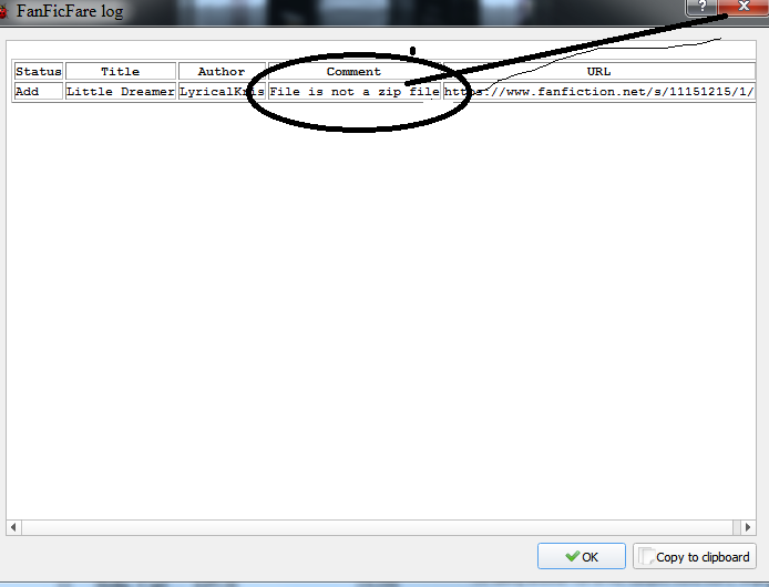

Im updating my fic and I keep getting this File is not a zip file?
how do i fix this?
how do i fix this?
Before you do that, is the epub readable?
Is your disk full? (We've seen that before.)
Do you have FFF's auto-convert feature turned on while convert is set to output epub by default? (FFF should recognize that, but I've seen it be a problem before.)

I just deleted the file and redownloaded. I thought maybe the file was corrupt.
No the auto-convert is not turned on. and my disk is not full.
It worked when i redownload. Im not even sure why it happend
