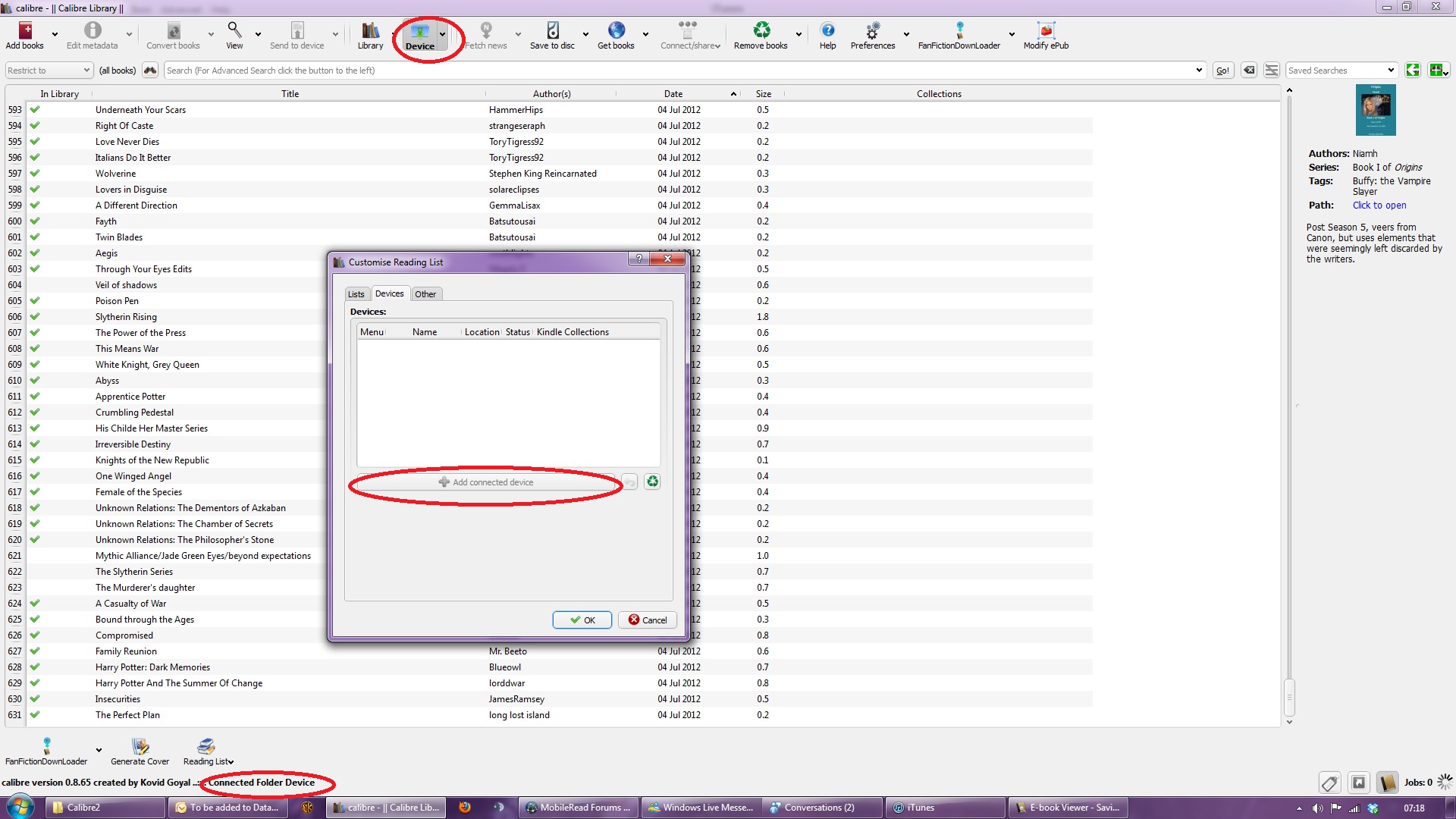

Old 08-21-2012, 06:24 PM   #486
Mieeka
Mieeka began at the beginning.
Posts: 23
Join Date: Aug 2012
Device: Iphone
Originally Posted by kiwidude View Post
Works fine for me . You can see it in my screenshot on the first post. Add connected device will be disabled if either (1) you are not currently connected to anything, or (2) you have already added the currently connected thing to the list. Try using Send to Device on a book while you are connected to make sure the folder is indeed "connected" and working correctly, and then go back into the Reading List configuration screen to the devices tab.
Hi Kiwidude,
I'm also having this problem after moving my itunes library to a new disk, the sync became disabled and isnt acknowledging the itunes library was connected.
I removed the device from the list in order to re-add it only to find the !add connected device button is now disabled
Screenshot
Mieeka is offline   Reply With Quote

@Mieeka - welcome to MobileRead.
In that screenshot you aren't actually *connected* to the folder, so the button will naturally be disabled (as it says it is "Add to connected device"). Exit the dialog, connect to the folder, then go back into that dialog and the button should be enabled.
kiwidude is offline   Reply With Quote

Hi kiwidude,
You are correct that i'm not attached to a folder - however i AM connected to iTunes (bottom left of the original screenshot you can see it says connected Itunes) and as you can see it doesn't recognize this as a device. I can however manually send files across. Itunes used to be recognized as a device, its only since I've moved my library that it has stopped recognizing it.
Likewise if i attach a android smart-device using the new WiFi functionality or to a folder (screenshot attached) this also doesn't recognize the connection.
Name:	connecting to folder.jpg

Ok, I missed the ITunes thing, since the other user described connecting to a folder and you said you had the same problem .
I am not at all surprised the Android thing doesn't work, since that didn't exist when the plugin was created.
I know there was some iTunes related changes a little while ago to calibre, perhaps that changed something breaking this plugin? Is iTunes connectivity working for anyone else - I don't use it myself. I will take a look at some point...
