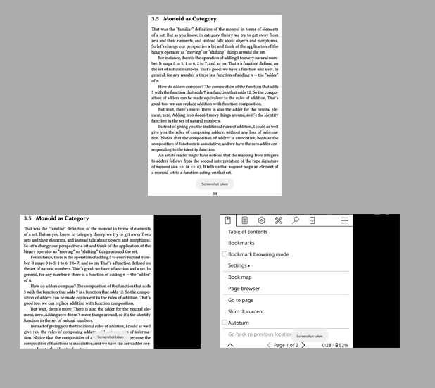

Is orientation supposed to work in Nook Glowlight 4 (4e in my case)?
The device is 1024x758 and works perfectly when not rotated, but rotation to 90 or 270 reveals the following
  • The layout is rotated
  • Looks like the new width and height is not taken into account, the width of the page stays the same (758) and the rest is filled with black
  • It's impossible to activate bottom menu (at least to try to adjust) since the tapping in usual bottom area leads to page flipping.
  • The screenshot composite illustrates what I described + how the main menu looks when activated
Thanks.
The rotation is broken on a few devices since https://github.com/koreader/koreader/issues/9446
Will be working again with https://github.com/koreader/android-...ncher/pull/439
In the mean time those with affected devices that rely on hw rotation can use v2023.05 or previous releases.
If v2023.05 doesn't fix the issue, then the device is broken beyond repair and the only solution is to disable hw rotation completely and fallback to software rota (KO is rotated, system is not). In that case please read and comment in https://github.com/koreader/koreader/issues/8482
Thanks, after your information I dug into the sources and found that hasNativeRotation for Android just checks for API version so probably indeed the hardware rotation is used. I tried to apply the following patch (either with 1- or 2- prefix)
local frBuffer = require("ffi/framebuffer_android")
frBuffer.setRotationMode = function(self, mode)
end
to the mixed results. KoReader successfully felt through to the software rotation for a last opened epub file, but failed to achieve the same for a pdf file (the symptoms are the same as I posted before) and (for example) for the file manager failed for all cases. It felt like this function override didn't live for long and later was again returned to the primary value.
By the way, maybe its reasonable to provide something like "always use software rotation" in the settings? The mode for epub that worked with the above patch seemed to work correctly.

               viewport.x, viewport.y,
               viewport.w, viewport.h)
    self.bb = self.full_bb:viewport(
        viewport.x, 120,
    self.viewport = viewport
    self.full_bb:fill(Blitbuffer.COLOR_WHITE)
    self:refreshFull()
end
Any help would be appreciated,
thanks
Matthew Roloff is offline   Reply With Quote
