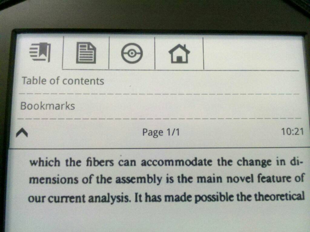

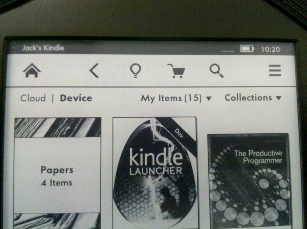

And, finally, as the PW has only one physical button, you are forced to exit Komic using the exit button, aren't you?
Yes, I go to the reading menu, then back to home, then exit. The only button locks the screen. The PW generally uses soft menu buttons at the top of the screen:
Home screen. The house icon also appears when reading, and always goes to the home screen.
Koreader's menu (another JB app). Its home button goes back out to its file selection page, which has a separate exit button.
