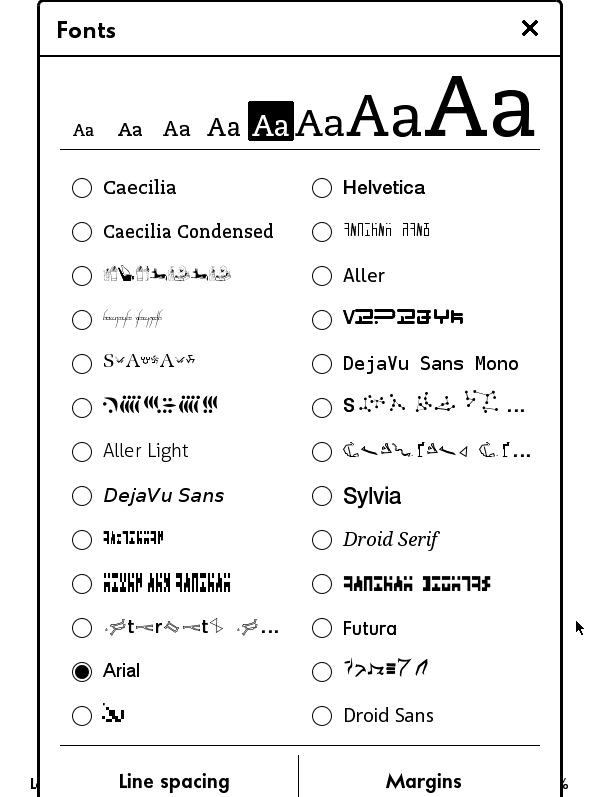

Originally Posted by icantbebothered View Post
Arial font for kindle attached. Just copy it to mnt/us/fonthack.
Pictured.
ID:	103782   Click image for larger version

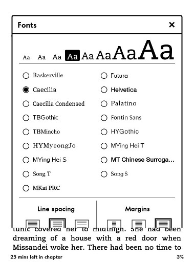

I've created an empty folder in the root of the Kindle's directory called USE_ALT_FONTS
And another folder named fonts in which I copied and pasted the four ttf files of the font into:
Fontname Bold Italic.ttf
Fontname Bold.ttf
Fontname Italic.ttf
Fontname.ttf
I ejected my Kindle and did a restart. When I tap the "Aa" button I can see the font I installed with a bunch of other fonts
Plus, I can't see the italic/bold/bold italic version of the font.
Edit: I saw this picture online and these are exactly the fonts that automatically appeared on my Kindle.

Are you saying that you cannot see the bold/italic font in the font list or that bold/italic are not working in an ebook?
The font list only displays the Fontname once. The code in the ebook determines whether the fontfile used is regular, bold or italic.
The four font files have to be named in a specified way for the Kindle to understand them:
i.e.
Fontname_Regular.ttf
Fontname_Bold.ttf
Fontname_Bold Italic.ttf
Fontname_Italic.ttf
I have used an underscore but I understand you can use a hyphen instead.
I did notice that after I had added my own fonts several other new fonts appeared in the fontlist which I didn't remember seeing previously.
Moonraker is offline   Reply With Quote
That the bold/italic is not working.
Do I need to add hyphens?
Also, some fonts have an ota extension instead of ttf. Can I use them?
Gazella is offline   Reply With Quote
The way I understand it is that the Fontname must be separated from the Fontstyle with either a hyphen OR an underscore.
Try the underscore first. I have underscores and my fonts that I added to my Kindle are working correctly.
Regarding the .ota fonts. I believe these are fonts designed for the Blackberry so they are unlikely to work. Perhaps someone more knowledgeable than me will comment.
