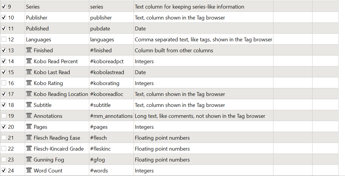

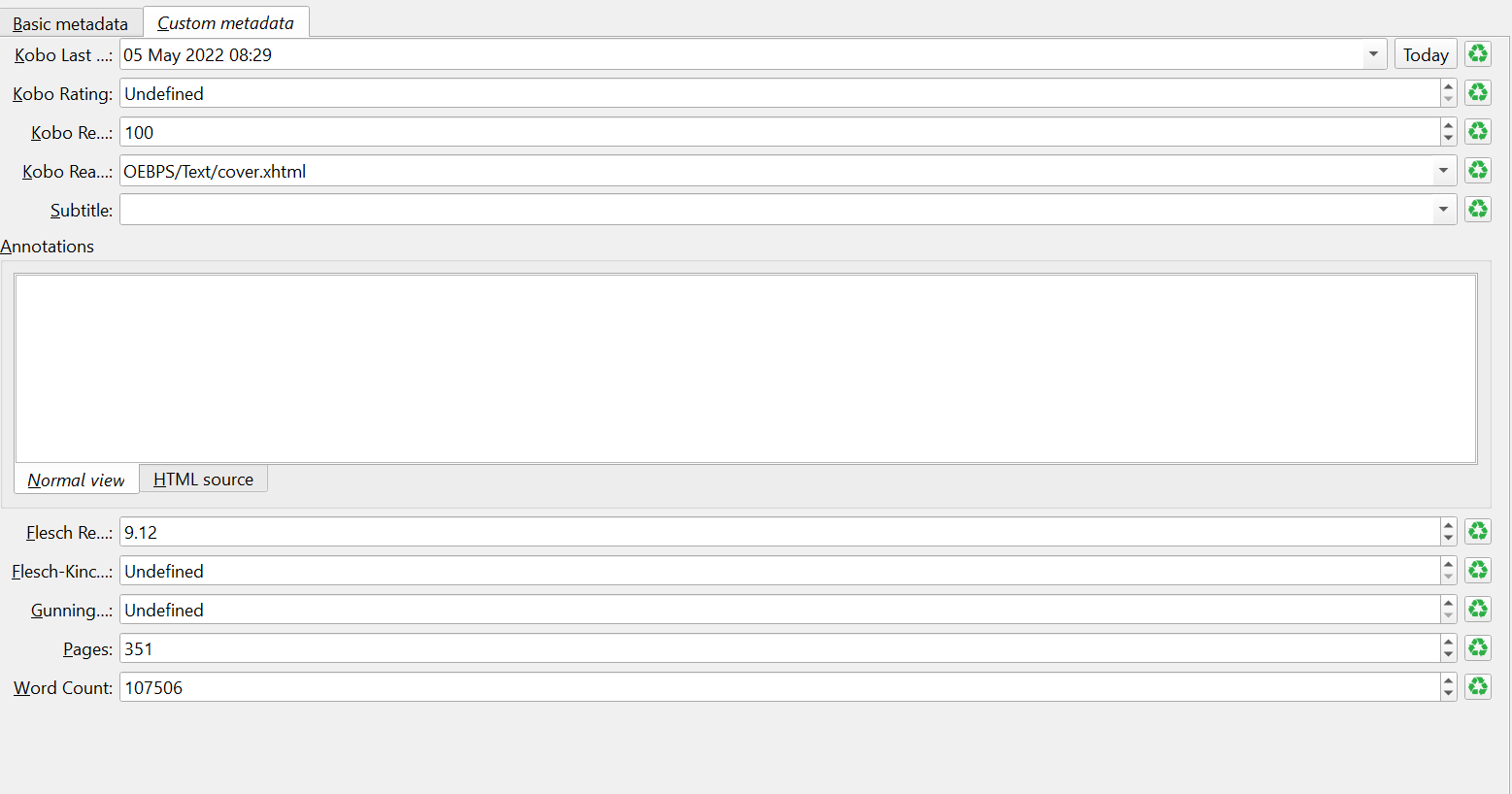

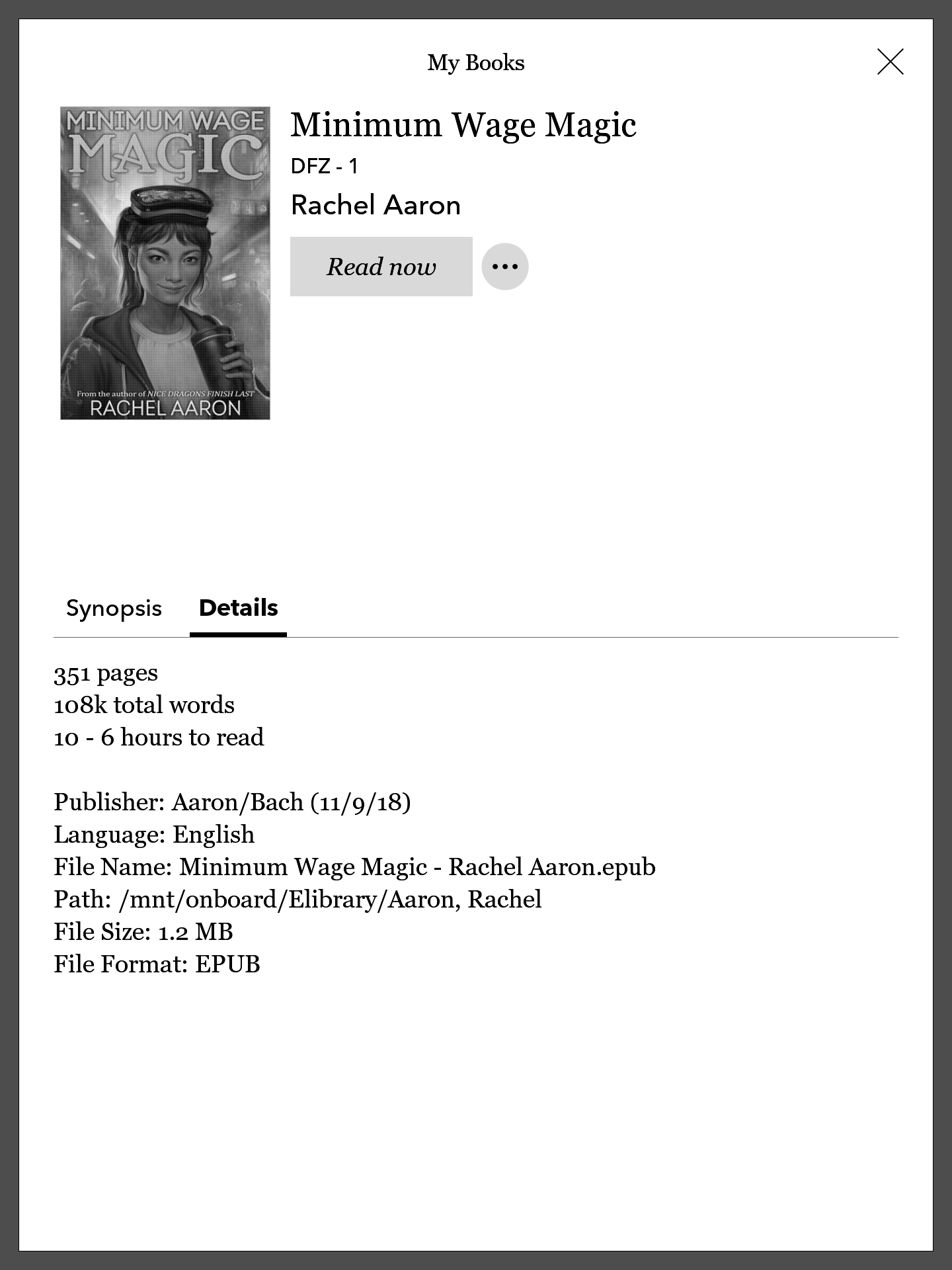

Originally Posted by Deobulakenyo View Post
I tried to add pages and word count to books so they will appear in the details tab on my Libra 2, but after connecting to calibre, and updating metadata, still no book pages and word counts are in my books on my device.
I attached screenshots. Please tell me where I did wrong.
Thank you

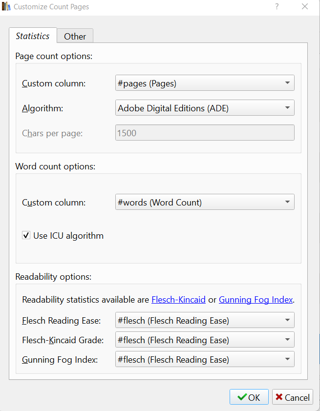

I configured the Count Pages plugin and ran it on a few books. I then added the program$$ entries to the appropriate areas in the KoboTouch driver (I don't use the KoboTouchExtended driver but it shares that code with the KoboTouch driver so should behave the same). After doing this, I connected, let calibre update the metadata and after safely ejecting, when I looked at the details of a book, it shows the pages, total words and hours to read. See the attached images for more information.
Edit2: One other item I was looking at caused me to have some uncertainty about the way the times are calculated. As near as I can tell, using the mod function would return the remainder of dividing the # of words by 12 (lower) and 10 (higher) which might explain some of the odd times I was seeing. I changed the calculation to program:round($$#words/24000) and program:round($$#words/20000). While not nearly accurate, at least the values don't look like I've been choosing random numbers.
ID:	193671   Click image for larger version
ID:	193672   Click image for larger version
ID:	193674   Click image for larger version
ID:	193676   Click image for larger version
ID:	193677   Click image for larger version

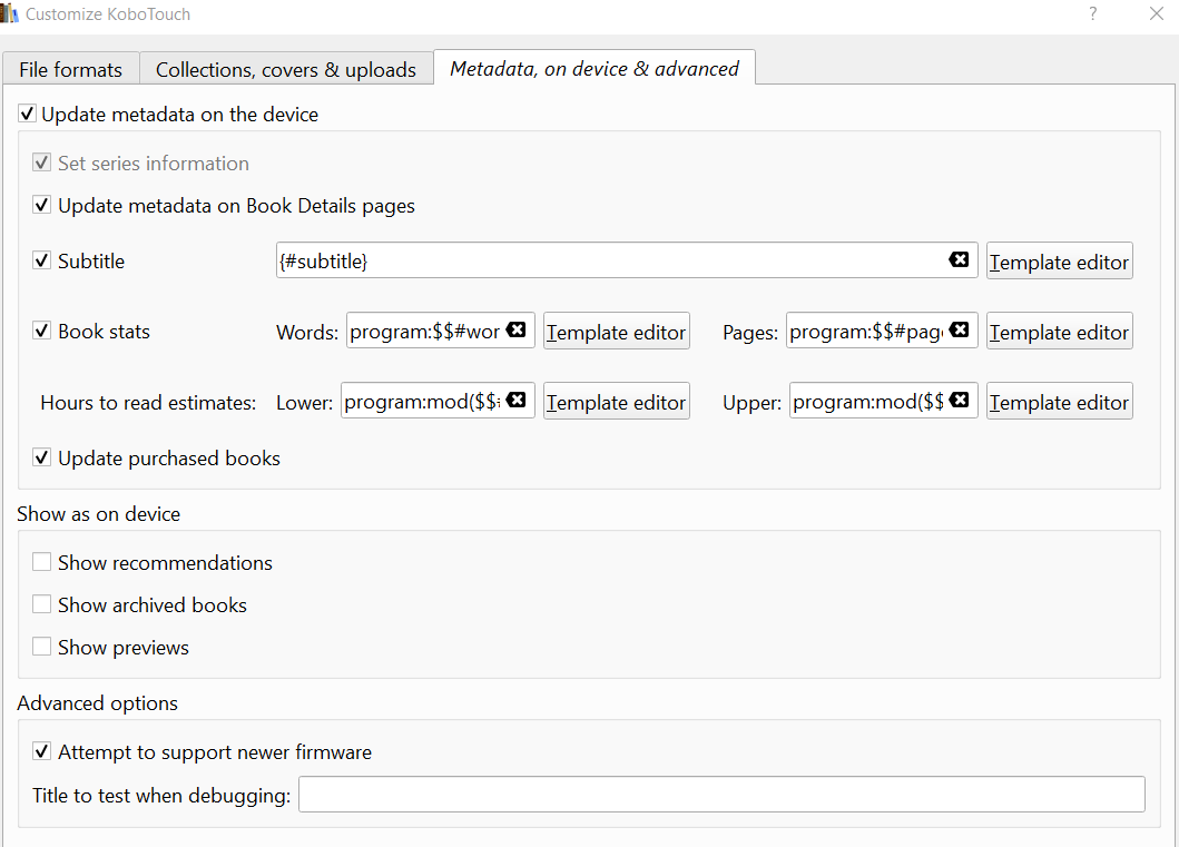

Thank you for the reply and the screenshots.
To tell you the truth, the customizations in calibre are really difficult for me. I am really not techy and have zero sense of basic programming and coding.
Everything is Chinese to me at first. Since I am more a visual learner, and I can't find youtube videos on setting up some settings, it is really a grasp in the dark for me.
Going back to my problem, I followed your examples except the READABILITY OPTIONS and the Flesch Reading Ease and the Flesh Kincaid Grade and Gunning Fog Index, which I have no idea what they are for. Are they necessary for the goal i intend to have (having the word and page counts)?
Also, do i need to create custom columns as well for the reading estimates for the lower and upper templates OR do I just need to input the:
program:round($$#words/24000) in the lower template
program:round($$#words/20000) in the upper template
Thank you very much!
Edit: Word count and page counts now appear on my device. Reading estimates are still missing.
Last edited by Deobulakenyo; 05-07-2022 at 10:20 AM. Reason: Posted that page and word counts now appear

You just need to input the templates into the lower and upper template. The reading estimates are calculated from the word count column.
Again, thanks to your screenshot, page counts and word counts are now displayed on my libra 2.
I used your template exactly as is but no matter what i do, the reading estimates do not appear on my device.
To make sure i am doing it right i even used the kobo touch (NOT EXTENDED) plugin to input the templates just to follow your example but still fails. I also tried the kobo extended driver and fails again.
What i don't understand is the upper trmplates on word and page counts work but the estimates fail even though thry are in the same plugin settings.
I will try your suggestion on a new book.
Thanks again.

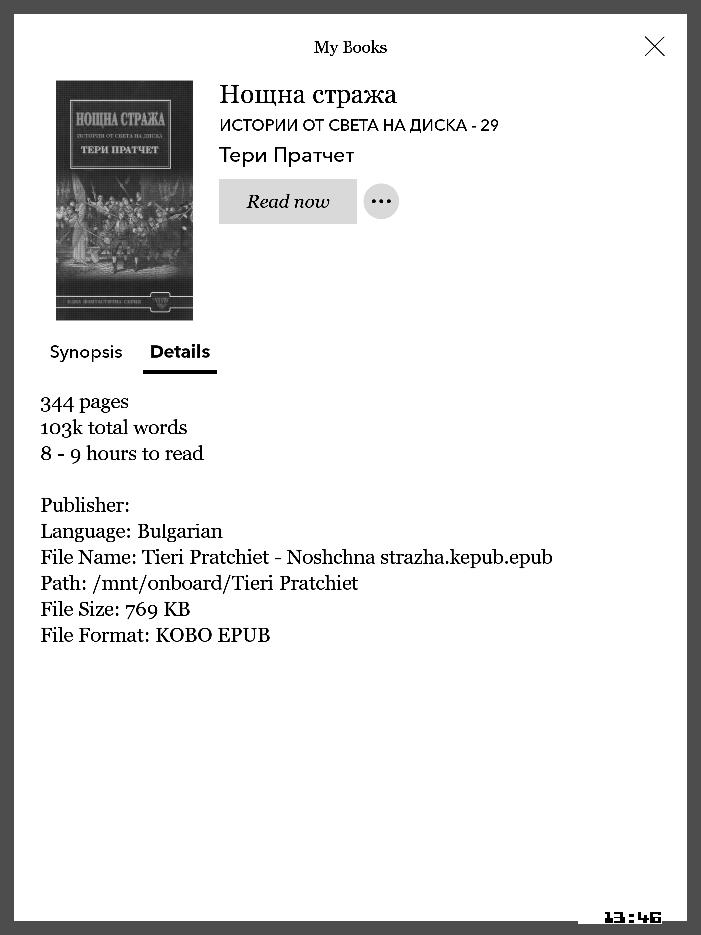

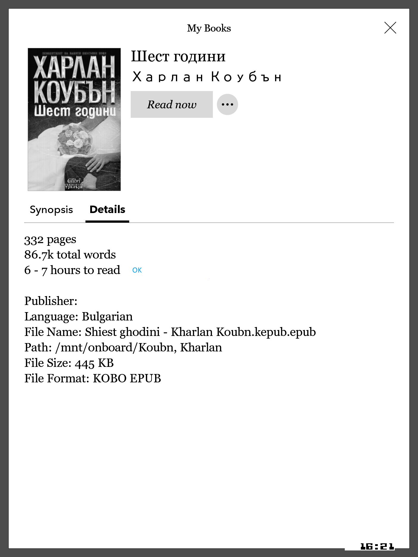

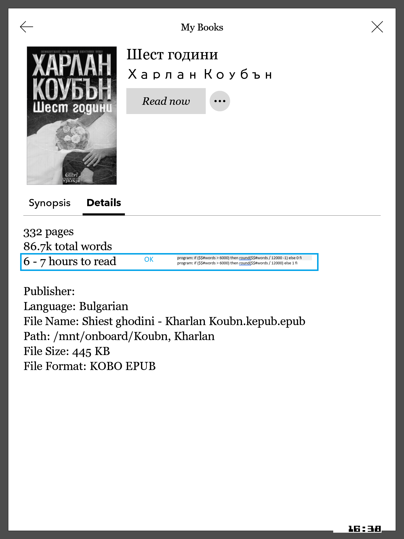

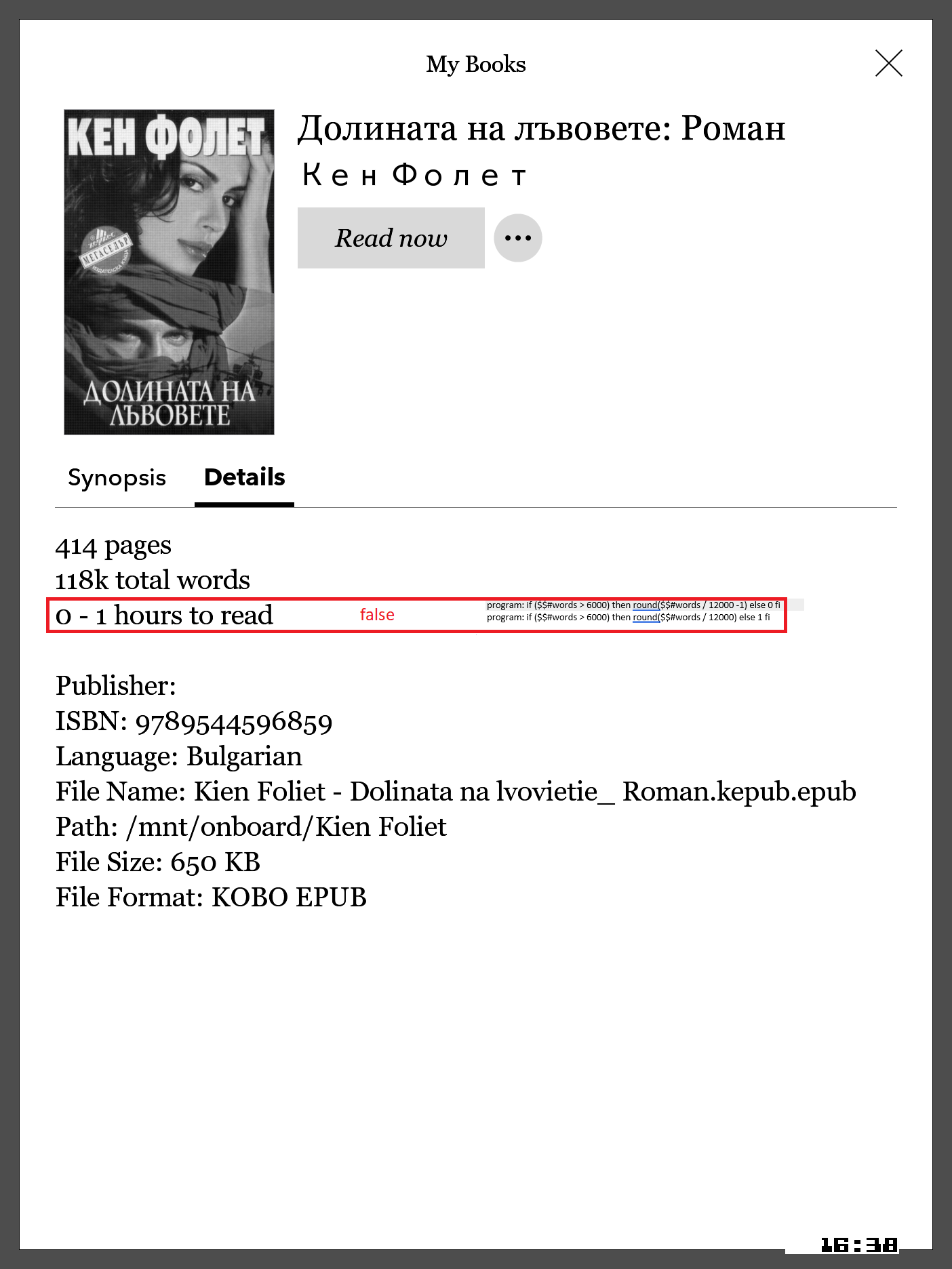

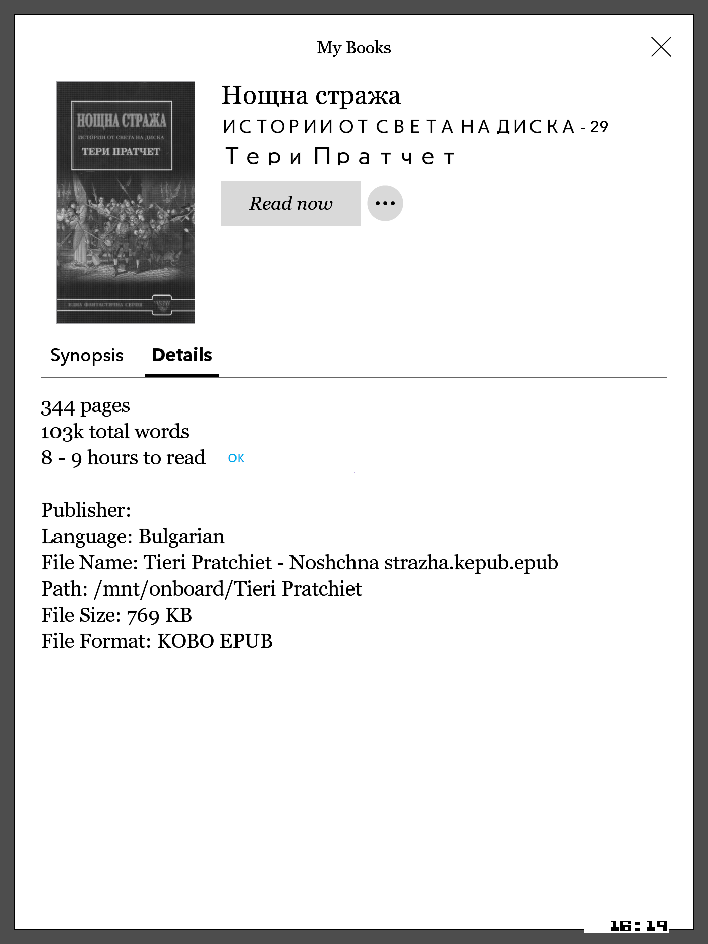

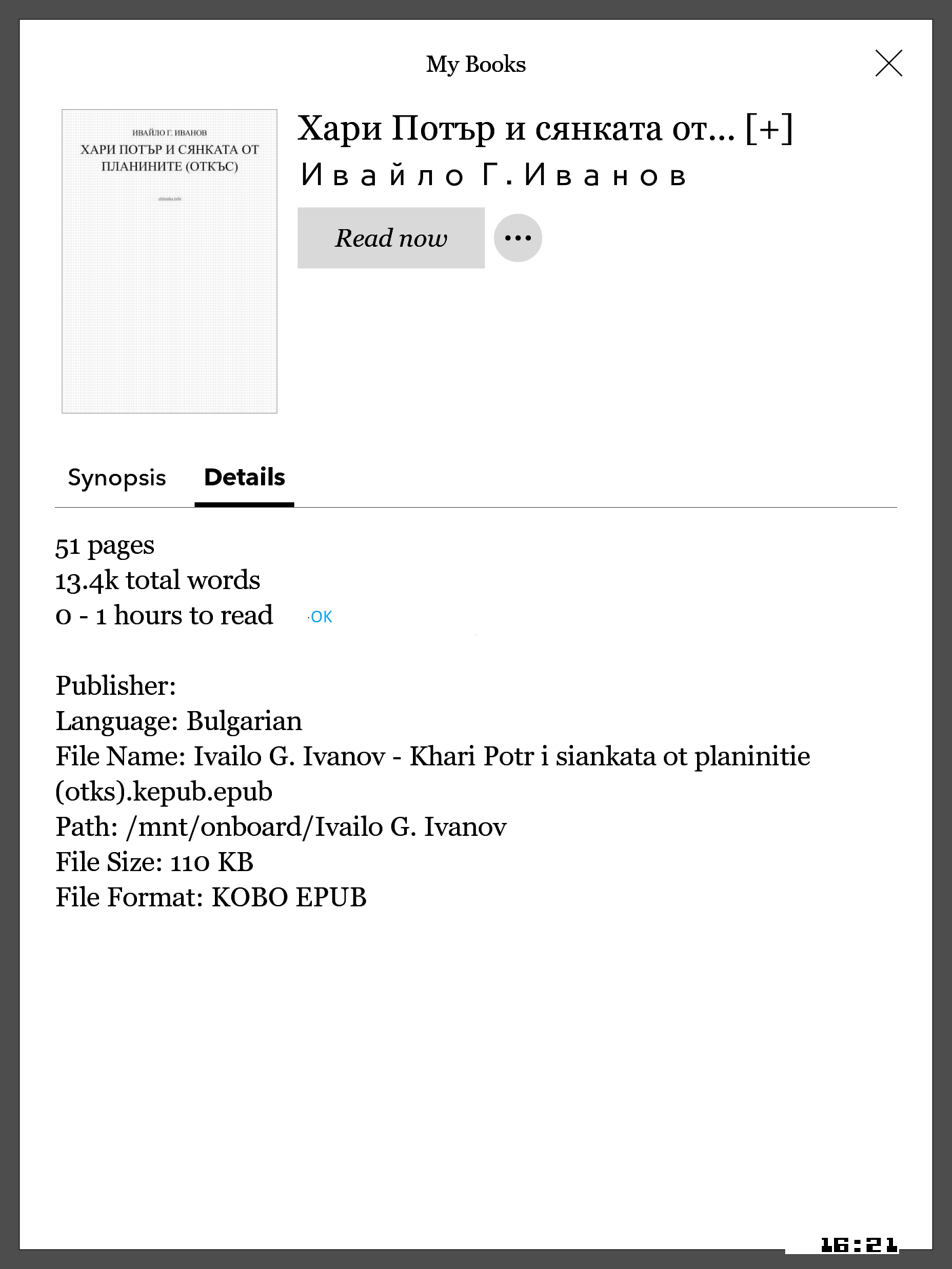

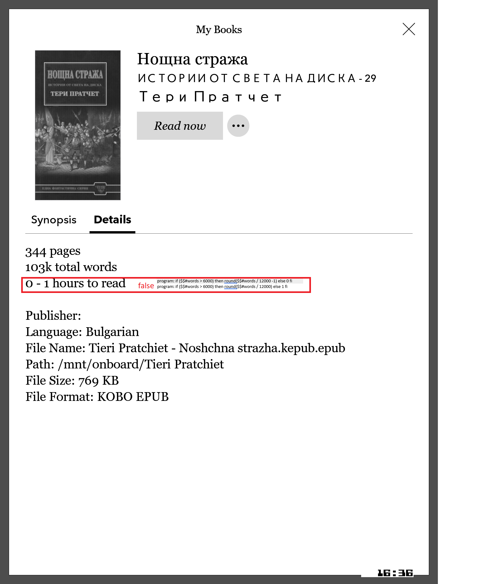

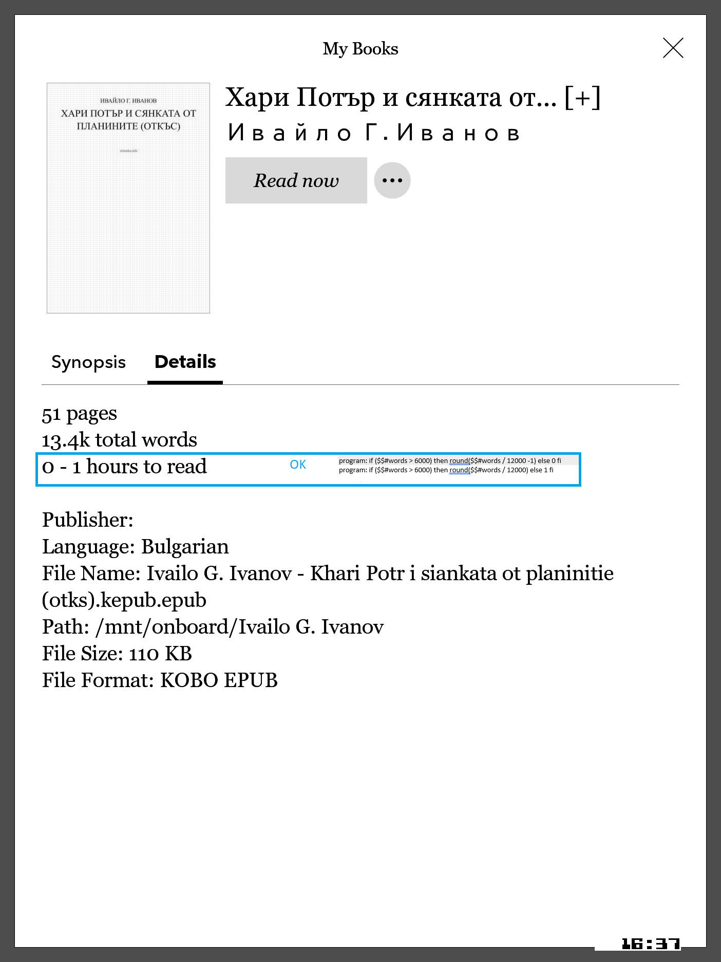

Friends,
So far, I have introduced the following templates into the settings of Kobo Touch extended, for book stats:
For LOWER program:round(($$#words / 12000) -1)
For UPPER program: round($$#words / 12000)
And everything works beautifully - on the second Calibre connection, the statistics are displayed for each book (for me they are just kepub).
However, I want to add a bit of extra logic. Since reading time doesn't affect books containing less than 6000 words, the smallest time in that case becomes a negative integer
and, as a result, reading time is not displayed.
So, my question is if such logic can be introduced: if the words are below 6000 - then minimum time to be 0 hours, and maximum time to be 1 hour. If the words are more than or equal to 6000, the above calculations to be applied.
I.e. something like this:
For LOWER program: if ($$#words > 6000) then round($$#words / 12000 -1) else 0 fi
For UPPER program: if ($$#words > 6000) then round($$#words / 12000) else 1 fi
I've tried it, but it seems like there's something i'm not doing quite right. I will be happy if someone helps.
Thanks!

Is the spacing/spaces important in the template? I noticed you have a space before 'round' and before and after the diagonal slash.
I asked because i can't make the reading estimates appear no matter what i do.
Edit: works now. But is it normal that the reading estimates display "0-12 hours" for a book that has 141,000 words? I was thinking it should be "11-12 hours"

Originally Posted by Svens View Post
Friends,
For LOWER program: round($$#words / 12000) -1)
For LOWER program: if ($$#words > 6000) then round($$#words / 12000) -1) else 0 fi
The point of using a template is that you can add code. My examples were just that, examples. Simple things that I used to test. I understand enough about the calibre templates, that I didn't need to do more.
As to what is wrong, you need to tell us. There is an error the template for the Lower estimate, but, I don't know if that is the actual issue or not. This has an extra parenthesis in it. If you used the Template editor it would show an error and try to tell you where it is. But, the correct template should be:
if ($$#words > 6000) then round($$#words / 12000) - 1 else 0 fi
Looking at these, I don't know what you are trying to do. The value for the estimates is supposed to be minutes. Which the device displays a hours. I am pretty sure that zero and one will be displayed as zero by the device or not display anything.
Everything is fine now.
If i use Steven's template, the estimates always start at 0 to whatever figure the words divided by 12000 is.
So i used 12000 for lower estimate 9000 for upper estimate and i get decent numbers now. When the words are less than 9000 i get an estimate of 0 to 1 hour reading.
I took 7 screenshots.
On the first 3,i'm using the following templates:
program: round($$#words / 12000 - 1)
The results for reading time on those 3 screenshots are correct. They match the data on the sites and are realistic.
On the next 4 screenshots,i'm using the following templates:
program:if ($$#words > 6000) then round(($$#words / 12000) - 1) else 0 fi
Here, the results are very contradictory - some are OK, others are totally wrong. And I can't understand why.
By the way, the values of the estimates sent to Kobo are in hours, not minutes. Judging by all the screenshots and results, the data being sent to Kobo, is directly in hours. That's why in the templates, i'm experimenting with 1 and 0.
Cheers!

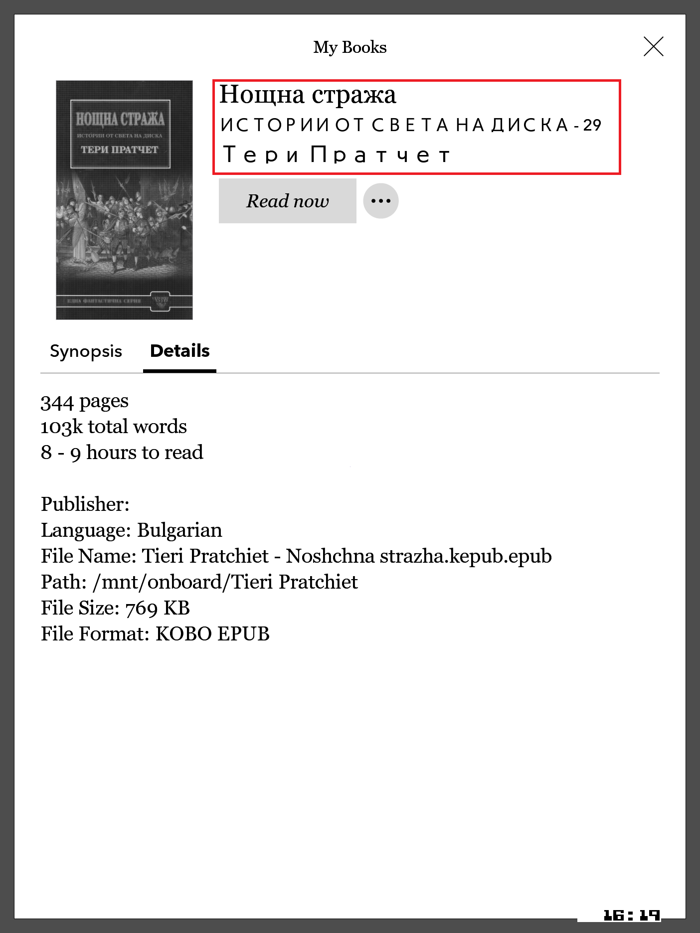

@Svens
Would recommend replacing the Avenir system font with another version (you can take it from Nook). It does not support Cyrillic, so Japanese fonts are used to display the authors. And it looks disgusting.
Semwize is offline   Reply With Quote
Old 05-08-2022, 12:49 PM   #465
Svens
Svens began at the beginning.
Svens's Avatar
Posts: 41
Join Date: Apr 2019
Device: Кіndlе5,NGL,PB650, KPW3,KPW4,KPW5, Kobo Aura One
Originally Posted by Semwize View Post
@Svens
This is a very good idea, but I'm not sure I'll succeed. It will probably be under Linux, and Linux is not my strength.
Edit:
With the help of Semwize I replaced the Avenir system font and now everything is much better.
Thanks!
