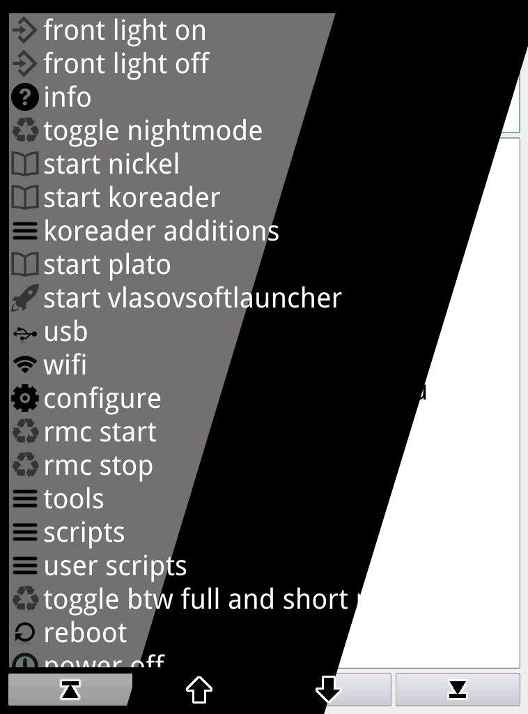

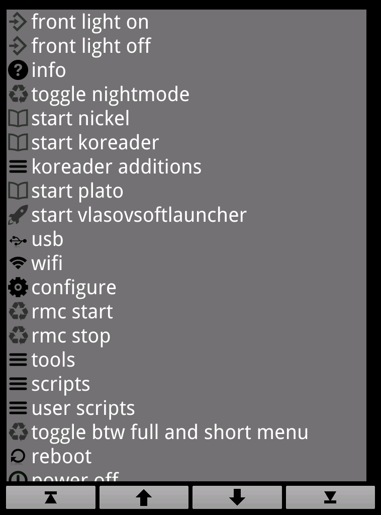

This is what I can get right now. Either the background color is gray, or it is black, but then you cannot see the navigation buttons at the bottom of the menu and also of the message screen. I think I would prefer the gray version because of the buttons. What do you think? I would like to implement only one version in order to keep it simple.
I did the changes to the most recent version of files that I have on my test device. Frankly speaking, I cannot remember how much changes we did to your copy of KSM, and whether my new files are compatible with what you have. I would therefore upload the whole package and suggest you install it over yours. But keep a copy of your current version, so that you have a backup if the new version does not work on your device. Would that be ok with you?
ID:	166508   Click image for larger version

Old 09-26-2018, 04:46 PM   #460
boriar
boriar ought to be getting tired of karma fortunes by now.boriar ought to be getting tired of karma fortunes by now.boriar ought to be getting tired of karma fortunes by now.boriar ought to be getting tired of karma fortunes by now.boriar ought to be getting tired of karma fortunes by now.boriar ought to be getting tired of karma fortunes by now.boriar ought to be getting tired of karma fortunes by now.boriar ought to be getting tired of karma fortunes by now.boriar ought to be getting tired of karma fortunes by now.boriar ought to be getting tired of karma fortunes by now.boriar ought to be getting tired of karma fortunes by now.
boriar's Avatar
Posts: 407
Karma: 314204
Join Date: Jan 2015
Device: bq Avant XL, Kobo Aura H2O, Onyx Boox M96C Plus
@tshering
whoa!!!! I really like your nighmode! I like the grey version but better a little more dark.
If you need some testing I'm ready
boriar is offline   Reply With Quote

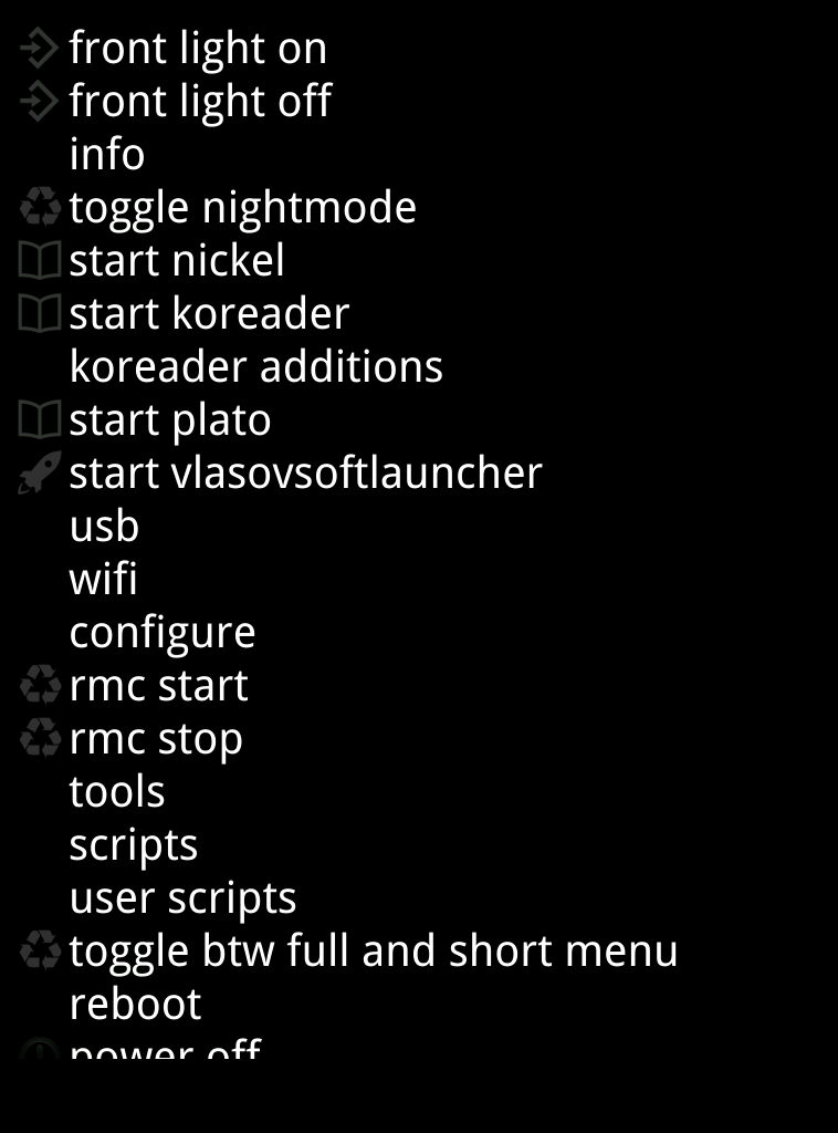

Personally I prefer the black, and for the buttons, would it be possible to have white buttons filled out with black (see attached) a 1 or 2 pixel border should already make it possible to view them no matter what.
Addition: the same goes for the icons. I tried finding out where they are stored, but it seems to be into one of the binaries.
I can't exactly remember all the changes we made for the Clara either, but I'll run a diff between my version and ksm09+update1,2. I can copy update 2 over 1 to make it work, right?
