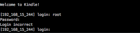

After entering diagnostics menu and trying to log in with my generated password, it still returns me an "Incorrect login". Made sure I did type the actual serial number and password... I
pd. I'm on firmware 5.11.2

I do not know if the routine you are using for "password from serial number" is working for that fw version on that device.
Your best bet is to use KindleTool (which can generate the diags password from the serial number).
NOTE: Your PW3 is a "dual boot" system.
I do not think the "diags" system should be showing 192.168.15.244, that is almost always the "main" system's address.
And of course, the "main" system has logins disabled for all users of "main".
Which looks just like what you are seeing.

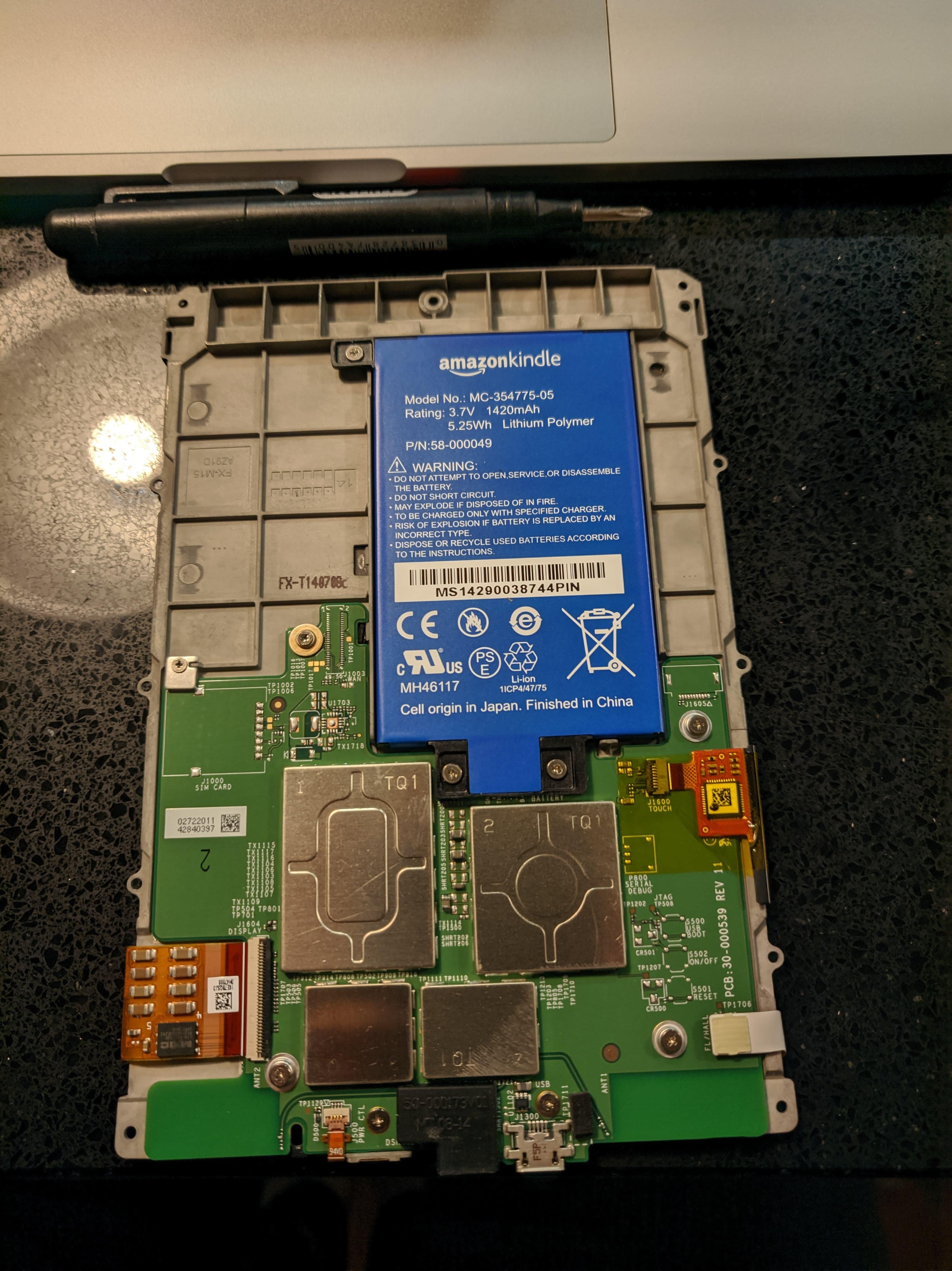

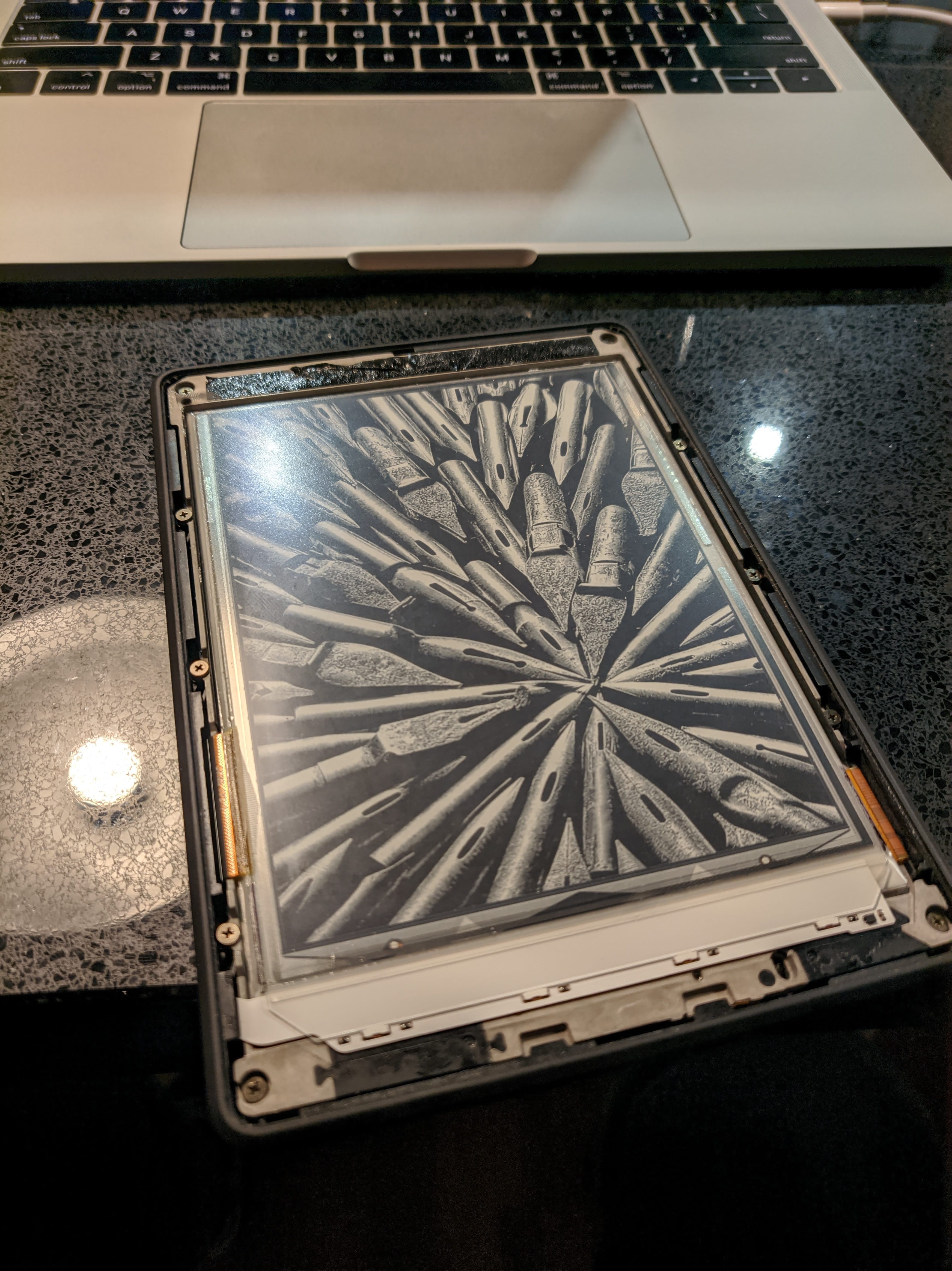

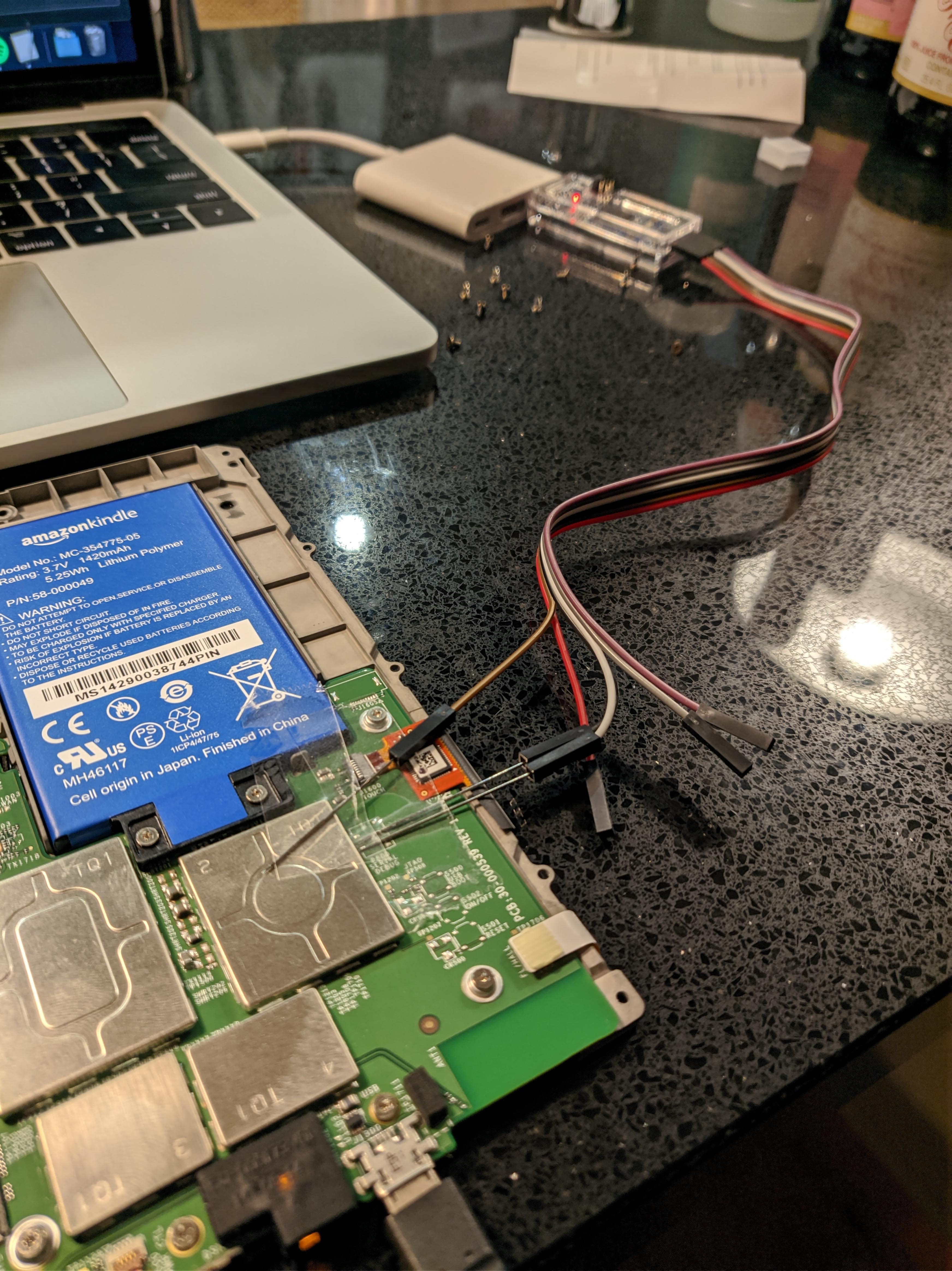

Hi guys just wanted to share with everyone how I did the serial port jailbreak without soldering.
I used this adapter (DSD TECH SH-U09C2 USB to TTL Adapter Built-in FTDI FT232RL IC for Debugging and Programming) from https://www.amazon.com/gp/product/B07TXVRQ7V which allows you to easily convert to 1.8v.
I connected the RX and TX to the TX and RX on the kindle by inserting a sewing needle into the dupont cables provided by the adapter and taping them to the board. I also taped the GND to the metal plate.
You can see how I did it in the photos. Hope this helps for people who are not comfortable with soldering!
