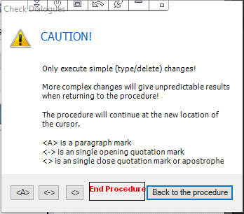

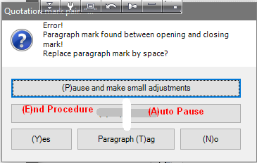

Suggestion for Dialogue Checker
On most occasions when I use the dialogue checker I end up using the "Pause and make small adjustments" option for every error.
So I am wondering if there could be an option to automate that - the option would be on the Error Dialogue - it would mean forgoing seeing the actual error message, but I never read it anyway - my eyes go straight to the highlighted text.
Once you hit the (A)uto Pause then for this run of the dialogue checker you won't get any more error dialogues like the one above. Next time you use the Dialogue Checker you would get the error dialogues... until you select (A)uto Pause.
You would still get this dialogue
Note the additional button End the Procedure - dialogue error correction can be very tedious.
Anyone else think this would be useful.
