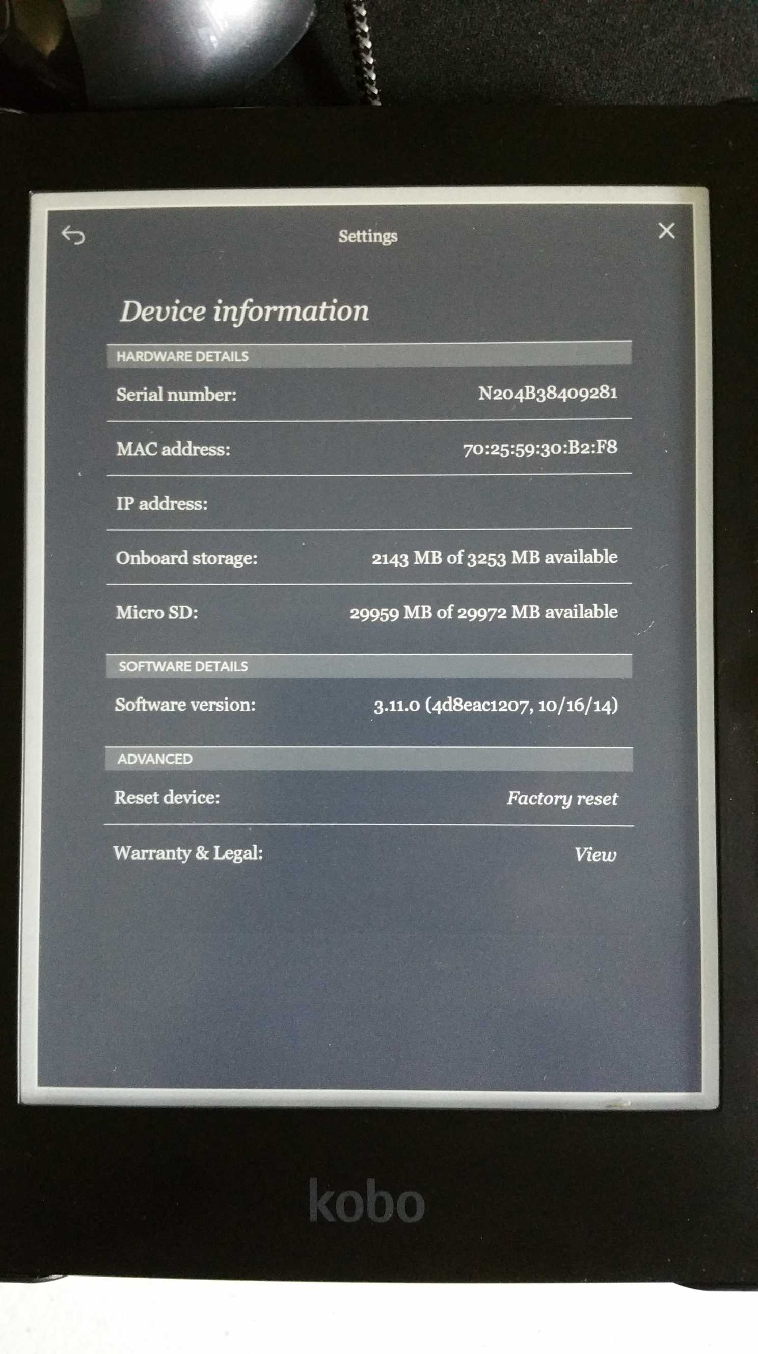

Confirmed to be working on my Kobo Aura HD (firmware 3.11.0, patched with kobo patcher). I didn't configure anything. Just copied .tgz from install to the .kobo directory. Now, it works perfectly.
Name:	kobo night mode 3.11.0.jpg
