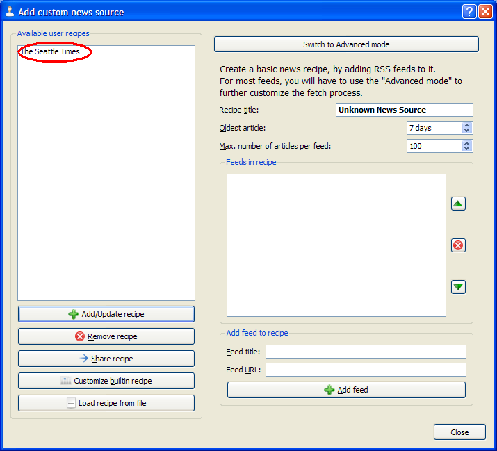

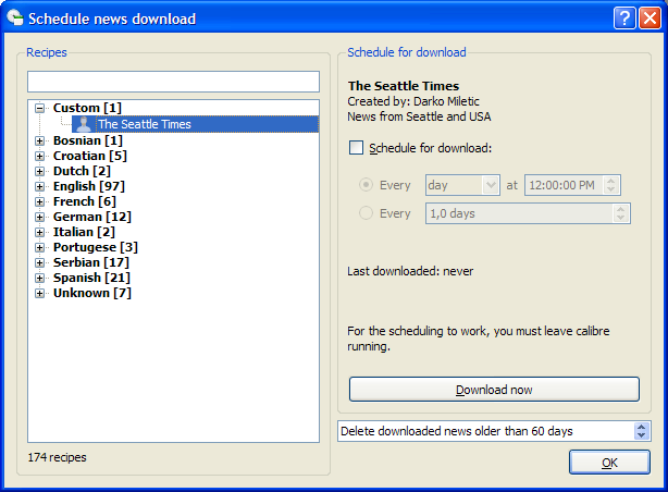

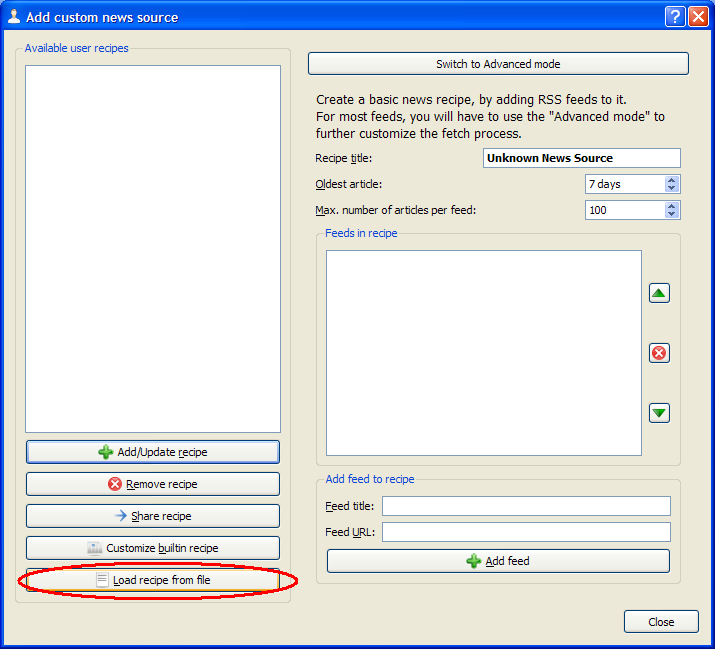

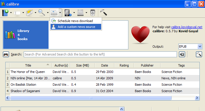

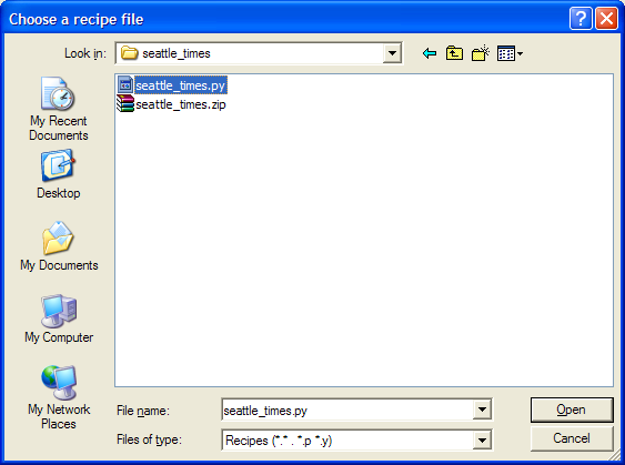

Old 04-17-2009, 03:32 PM   #442
kiklop74
kiklop74 can program the VCR without an owner's manual.kiklop74 can program the VCR without an owner's manual.kiklop74 can program the VCR without an owner's manual.kiklop74 can program the VCR without an owner's manual.kiklop74 can program the VCR without an owner's manual.kiklop74 can program the VCR without an owner's manual.kiklop74 can program the VCR without an owner's manual.kiklop74 can program the VCR without an owner's manual.kiklop74 can program the VCR without an owner's manual.kiklop74 can program the VCR without an owner's manual.kiklop74 can program the VCR without an owner's manual.
kiklop74's Avatar
Posts: 800
Karma: 194644
Location: Argentina
Device: Kindle Voyage
See images:
ID:	27671   Click image for larger version
ID:	27672   Click image for larger version
ID:	27673   Click image for larger version
ID:	27674   Click image for larger version
