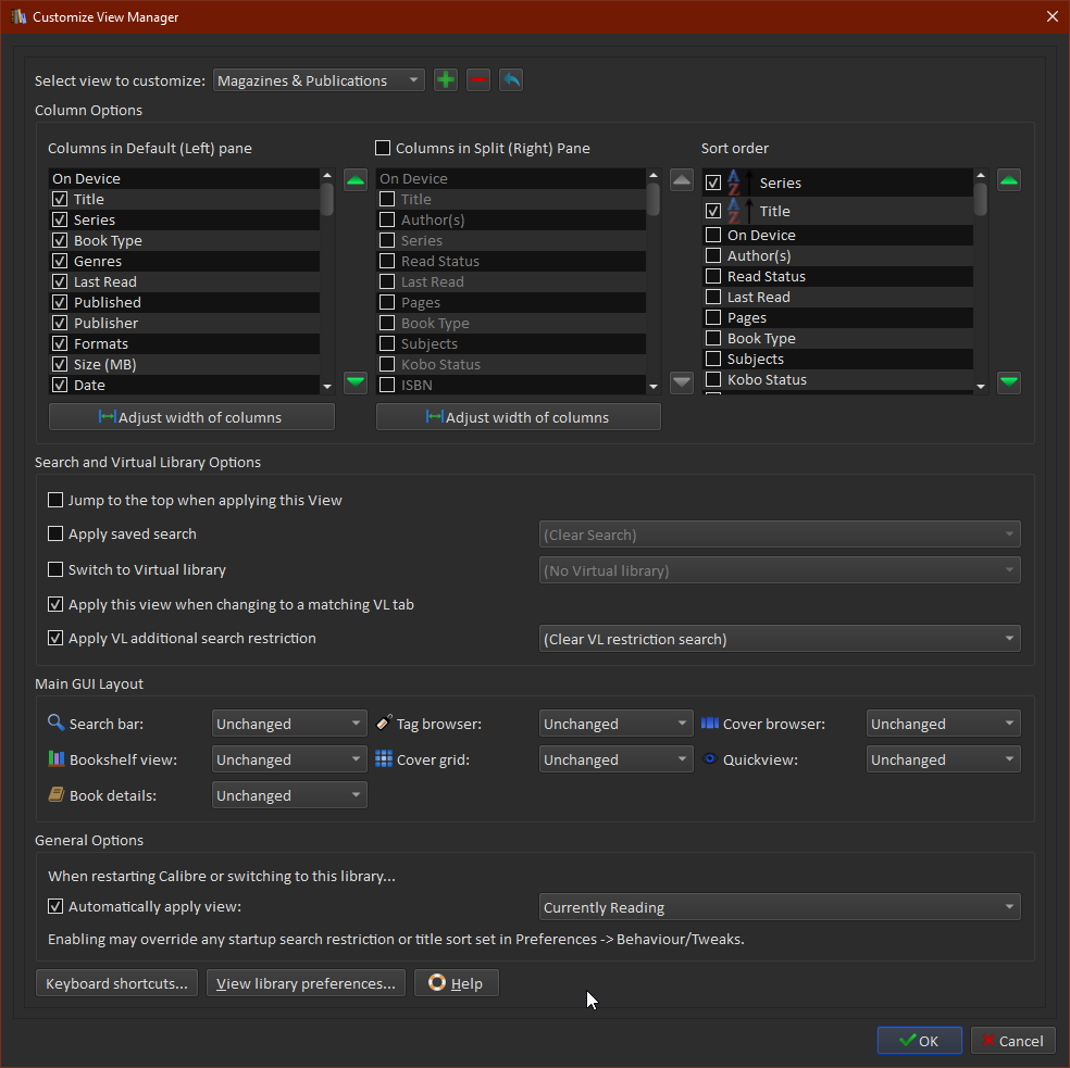

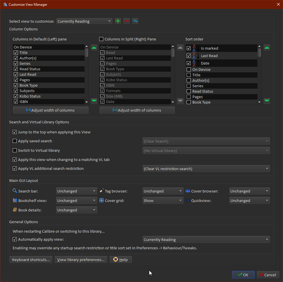

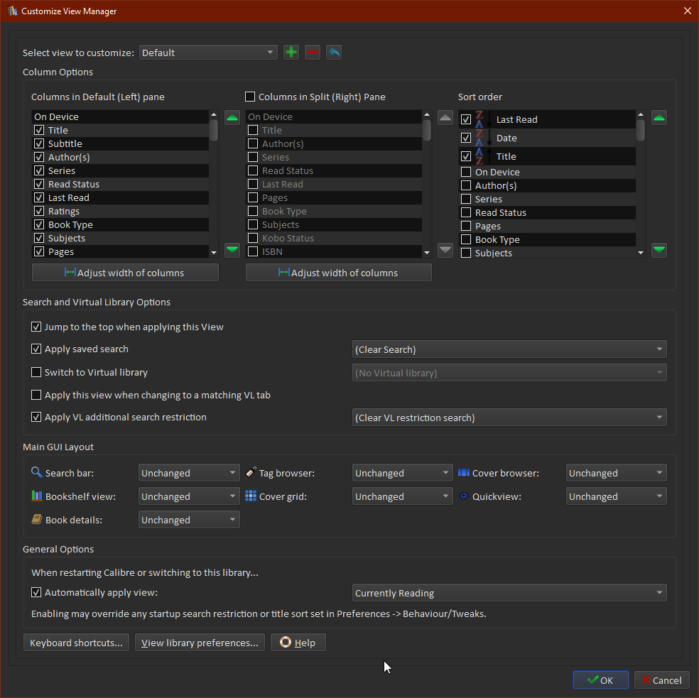

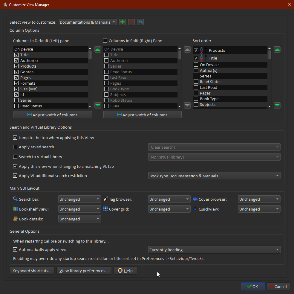

I have most of my view names (except Default and Series) match a virtual library. None work
ID:	226946   Click image for larger version
ID:	226947   Click image for larger version
ID:	226951   Click image for larger version
ID:	226952   Click image for larger version
ID:	226953   Click image for larger version
ID:	226954   Click image for larger version
ID:	226955   Click image for larger version
ID:	226956   Click image for larger version
ID:	226957   Click image for larger version
ID:	226958   Click image for larger version
ID:	226959   Click image for larger version

@ownedbycats - it only makes sense to tick the "Apply this view when matching to a VL tab" to a *single* view that has no VL switch setup for it. Shown above you have it ticked for both Star Trek and Cozy Mystery, but neither of those is actually associated with a VL (by using the "Switch to this Virtual Library" dropdown).
I havent looked through your previous post screenshots yet to see if that has a similar issue (after 1am here) but will look tomorrow. I did contemplate whether to put some sort of dialog prompt warning or have it "untick" silently where there is a conflict in views like your second post but opted not to as yet to see how it went without it. As I described in my "logic" post above, it finds the "first" view (with the expectation that there is only one for that criteria) - if you have multiple you can end up with the one you don't expect as you saw.
EDIT: Just from a quick skim at a couple of screenshots in your previous post I see the same issue. Looks like I should add the dialog warning to the plugin to explain what is going to happen when you try to click the checkbox on a second view with the same "scope" (i.e. second view with no VL switch dropdown selection, or second view with a Switch VL selection to the same VL name). If the user proceeds from my warning dialog it will have to untick that checkbox on your other view that has the conflict. Also I will of course have the Help page to try to explain this if it isn't clear.
