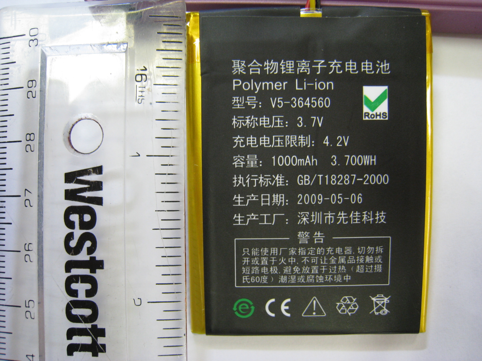

there should be a 6 digit number similar to 503456 (This is the number off of my cybook battery). This number tells you what physical size the battery is - in the cybook's case the battery is 5mm deep x 34mm wide x 56mm long. .
The number is "v5-364560" based upon the picture in the thread about the colour peeling off.
I checked the website of the company that manufactures these things and left them a message enquiring about getting batteries for what they call the eReader V5.
http://www.jinke.com.cn/Compagesql/E...tail.asp?id=42
We'll see if they respond.

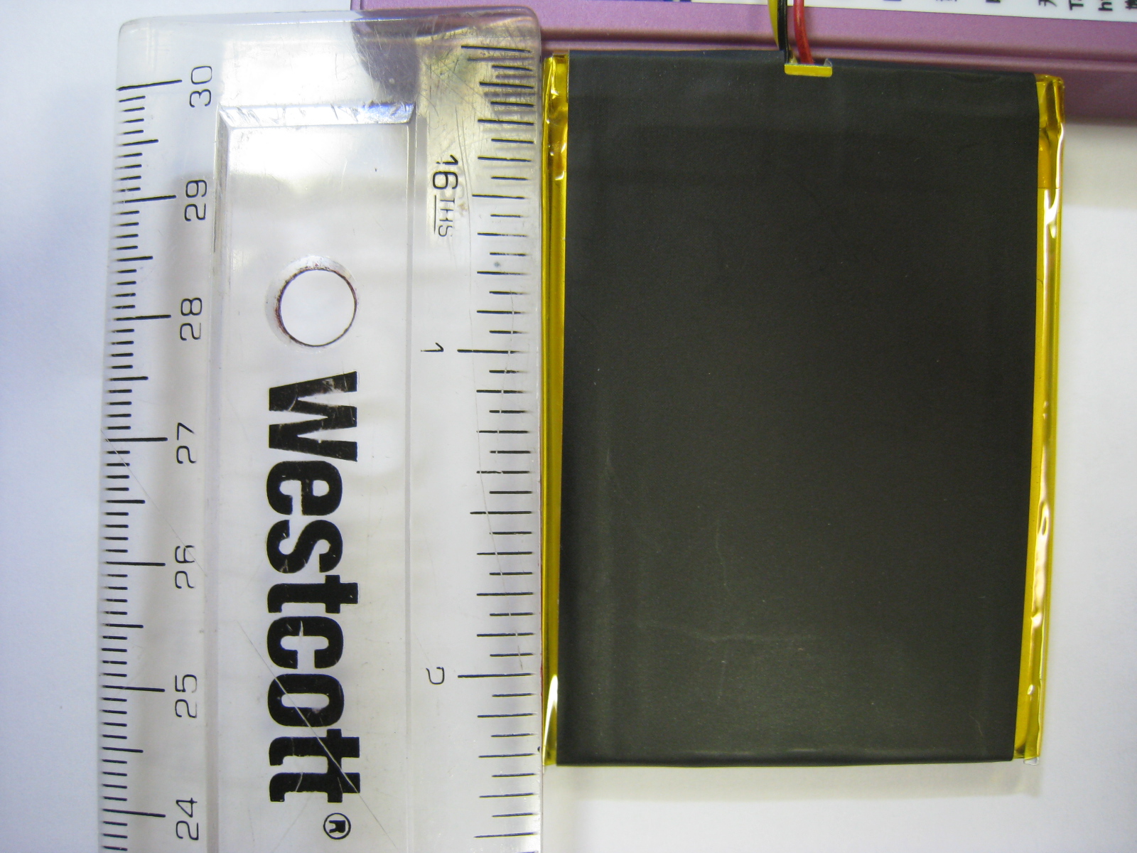

Dear ALL:
I have attached two shots of the battery to facilitate finding it online. We have forty in stock; but welcome your efforts.
Name:	Pocket PRO battery  and writing.jpg
ID:	36343   Click image for larger version
Name:	Pocket PRO battery with ruler.jpg

The key is GB/T18287-2000. That's your battery right?
I think it was said before that that number is a generic number

Originally Posted by Xerxes View Post
Googling brought up this based on Amy's email.
http://www.amazon.com/dp/B001P13RSK/...SIN=B001P13RSK
Folks
Technician mode on:
Voltage, Discharge capacity and (power) cell technology are NOT the only specification when buying a replacement battery.
Other factors are Form Factor (shape), Terminal or Lead-connector configuration-size.
If you have a lot of specialized electronics assembly tools, you might be able to modify an existing battery pack.
I don't recommend you try it. You do it wrong and you may damage your PEZ or create a fire.
Those Laptop battery fires in the news, were Li-ion batteries that charging monitoring failed.
The battery in the PEZ is physically larger than that LG phone battery (I have that battery in my phone)
Technician mode off:
I am disappointed that Jinke chose a non-common battery pack for the re-supply problems you have noted.
