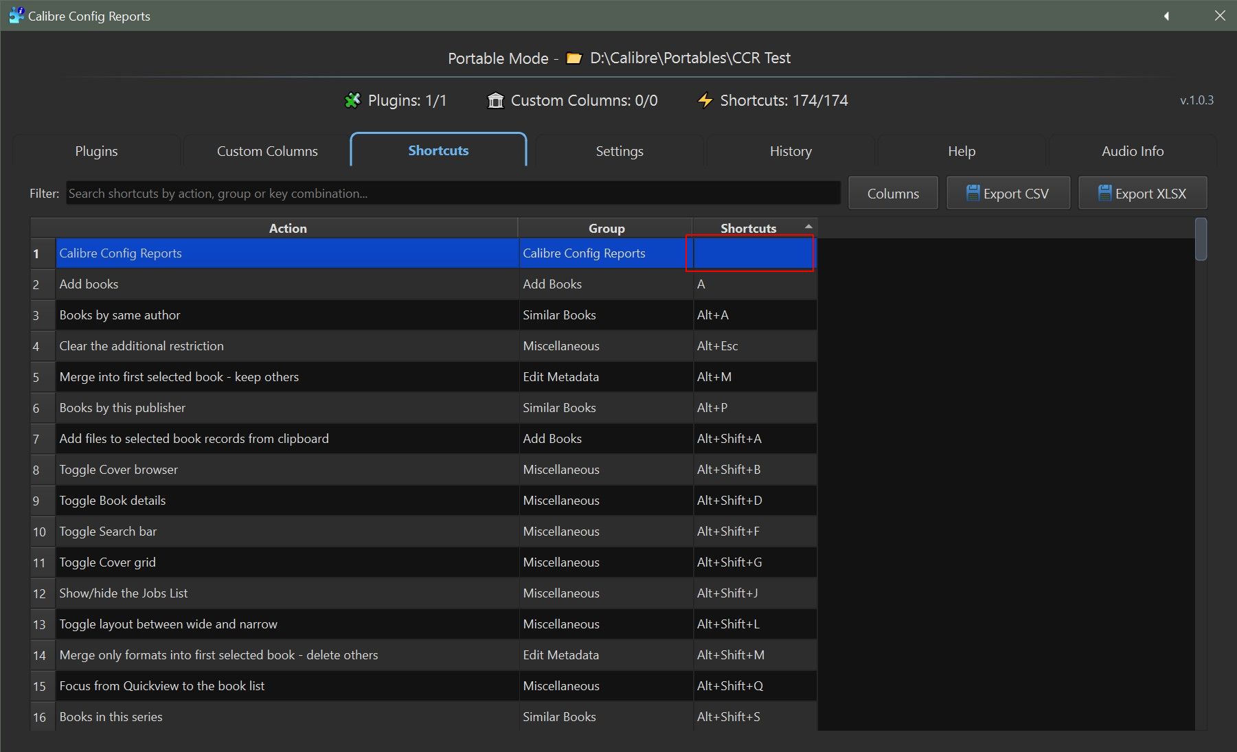

I like shorcuts tab A LOT, thank you.
However, the plugin's shortcuts are hard coded
Name:	Screenshot 2025-08-25 122513.jpg

Originally Posted by Comfy.n View Post
BR, please, what shortcut would you suggest for the main action. I'm having trouble leaving it unassigned
Leave it to the user.

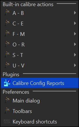

If I install CCR on my 'production system' I won't give it one and if you give it one I'll change it to "None". I might put it Favourites or Book list context menu, but more likely I'll get at it via All Actions (for me that's Ctrl+Alt+A).
Name:	Screenshot 2025-08-25 124050.jpg
I only use kb shortcuts for frequently used actions, for the rest I prefer menu's I can traverse with arrow keys… that's why I like MS ribbons - I can drive them with one finger

1.0.3 fixes that blank/none issue. And I left the CCR shortcut correctly unassigned now.

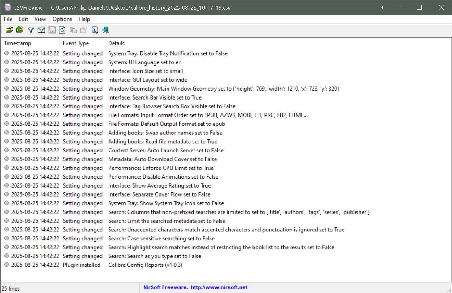

If I Tab into any of the lists to give it keyboard focus, the Ctrl+Tab and Ctrl+Shift+Tab keys do the light fandango on the list.
I changed the toolbar icon size to Small, that event was logged in History, but when I checked "Use two lines for . . ." that event wasn't logged. And there are events logged that I didn't and would never do, e.g. "Interface: Show Average Rating set to True" — BR, Ratings

Regarding the history events: I chose to add some historically troublesome settings like "Search: Highlight search matches instead of restricting the book list to the results changed from False to True"
It's possible that I add more settings on demand to be tracked. But, of course, I added just a small subset of Calibre Settings. There are what, like a thousand settings?
I will remove the average rating setting. This never happened during my tests but I have indeed focused on plugin upgrades and downgrades

In the following list, the Event Type "Setting changed" confused me. I didn't change any of them at the time indicated, I changed a couple (Hide Tag browser and moving BD) before installing CCR - they are the "CCR install time settings".
Name:	Screenshot 2025-08-26 104818.jpg
I suggest you only report events that happen after CCR is installed or change the install time Event Type to "Initial setting"
I think CCR creates this file "plugin_updates.json", in the Calibre Settings folder. IMO it should be in the Calibre Settings/plugins/calibre_config_reports folder
