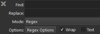

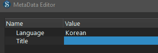

In other windows there is no problem.
The cursor changes to block and then it is OK.
ID:	211720   Click image for larger version

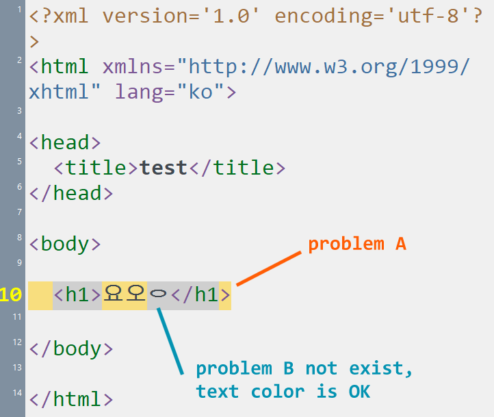

Ad Calibre Editor.
It's a bit more complicated than that.
a) the problem with the strange marking of matching tags in calibre also occurs (one might suspect that this is related to the miscounting of characters when there is a "composing string" glyph between tags while typing).
b) the problem of greying does not exist, because both when typing and the finished mark are in one colour (white in dark mode and black in light mode).
c) outside the editor (e.g. the "Find" window) it behaves as Sigil does, i.e. correctly.
BeckyEbook is offline   Reply With Quote

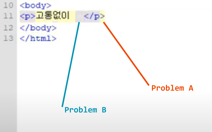

I am confused. So there are two issues?
A. When highlight matching tags the highlight of the ending tag is "off" because of the "composing string" glyph.
and
B. The "composing string" glyph is somehow rendered in a colour that does not show up against the black background, white background, or line highlight color.
Problem A can be made to go away by disabling the highlight matching tag pair. Right?
Why can't problem B be made to go away by just changing the line highlight colour?
I keep looking at the OP's video but he/she types so fast I can not see the Problem B happening at all just Problem A.
What am I missing?

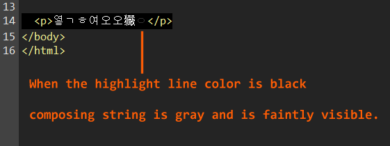

Yes, in Sigil, once the highlighting of matching pairs of tags is turned off, the A problem stops bothering.
However, it is not possible to specify a line highlight colour that does not interfere with reading the content and is neither white nor black nor grey, as this will in any case prevent the text being typed/typed from being read.
ID:	211724   Click image for larger version

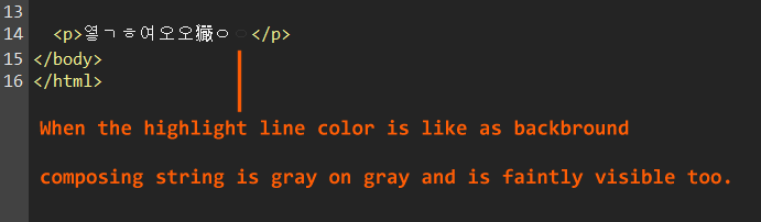

So what happens if we turn off the line highlight colour by setting it to match the background colour?
Is the lack of a line highlight colour and no matching tag highlighting the only reasons that Find and MetaEditor are okay?
Two images in dark mode.
ID:	211726   Click image for larger version

The funny thing is that as far as I know, there is no way for CodeView to detect that someone is in the middle of a "composing string" and then they pause.
To map tag pairs, CodeView grabs the entire source of the CV as text and then parses it to create a list of tag beginning and end (matching) starting positions and ends so it knows where to highlight.
But when in the middle of composing a character, a placeholder for the "composing string" is not added because the total number of char16 (QChars) are not known fully until the actual character to be input has been fully formed.
Qt and the IME really should not be injecting parts of a incomplete character into the document until the actual fully formed character is ready.
So there really is nothing we can do about Problem A.
Old 10-28-2024, 01:04 PM   #45
KevinH
Sigil Developer
Posts: 9,073
Karma: 6361556
Device: many
Problem B is strange too. Why is it rendered so faintly? Is it because it is rendering an incomplete "composing string"? Is the colour meant to indicate it is incomplete? I wonder where in the Qt code the colour is determined? Is it taken from a Windows setting?
