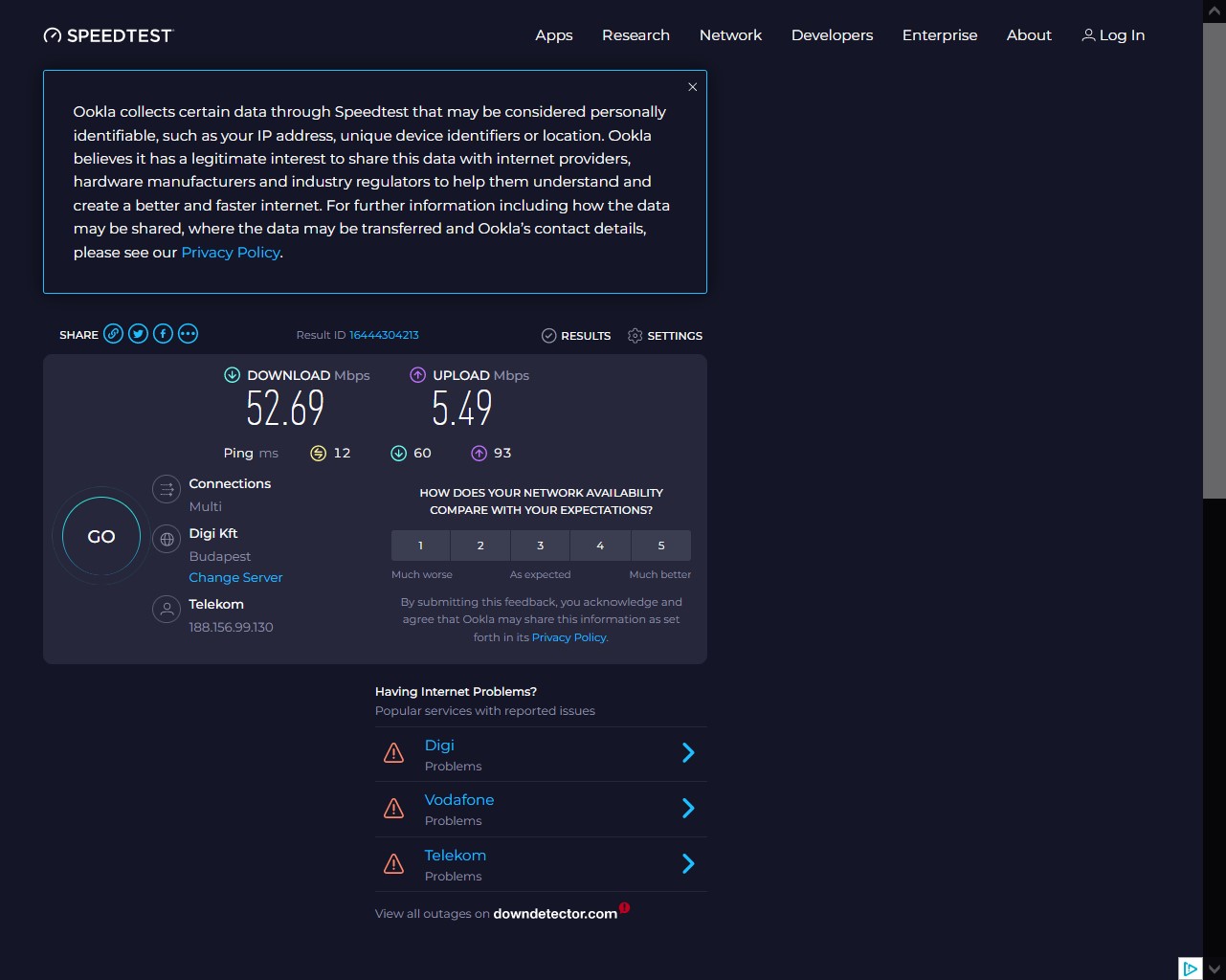

Has your regular web access speed / responsiveness improved or is it still slow?
Have you tried shutting off both the PC and any modem / router between the PC and the internet?
Sent from my Pixel 7a using Tapatalk
No overall speed issues that I know of -- see screenshot of the test from a couple of minutes ago.
Maybe there's a speed problem specific to calibre? At times it takes minutes to fetch a new issue of small size (<0.5 MB), at others a big one (15 MB+) downloads in a blink of an eye. But even those long fetches end up downloaded.
As for the rooter used by this computer, it's been a while since it was last shut down. Still, the issue with liberation.fr has been around for 2+ years now, which is to say there have been quite a few shutdowns (due to, e.g., blackouts) in between. The modem is turned off for most nights.
This is getting weird... Should we perhaps ask also Kovid?
