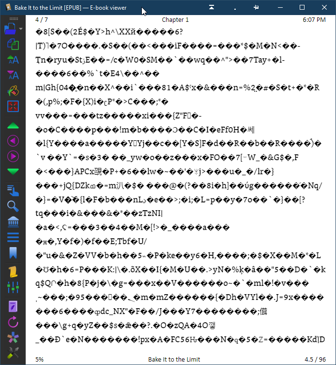

Maybe you unintentionally tried to de-DRM it, the process failed and it deleted rights.xml and encryption.xml while leaving it all encrypted. The fact that the bad file has useless compression on everything indicates something wrong. If it thought that it had decrypted the chapters then Zip compression would have been useful. Still, the images are compressed which never makes sense.

Yes, I imported into Calibre which automatically runs DeDRM.
And it didn't find that XML attribute which left it confused.
So it said, "this isn't encrypted" and deleted the two XML files.
Do you still have a copy of the original file anywhere?
Could you try a standalone decoder, ineptepub.py
That doesn't actually look for the XML attribute passHash, just a 64 char encryptionKey.

I'm seeing a DeDRM failure after re-downloading a book from the Nook app:
Attachment 208638
I'll be looking to deleting my B&N account. Useless to me now.
On the computer that has the nook Windows Store app installed, I was able to download some eBooks and they did not have the DRM removed.
I installed the latest DeDRM alpha release that computer and those two eBooks were then able to have the DRM removed. I saved the key file and was able to import it into the calibre I use most and it works to remove the DRM. So really, there's no reason not to be able to remove the DRM from B&NB ePub as long as you are using Windows 10 64-bit and have the nook Windows Store app installed.

After redownloading the same titles, I find there is a right and proper 'rights.xml' that works as expected with the existing DeDRM tools.
I can only speculate that some servers were generating corrupted key material.

You can remove the DRM. What version of calibre are you using? If you can install the alpha of DeDRM, you can remove the DRM. The alpha version is basically 10.0.9+.
When I updated DeDRM on the computer that has the nook app, I was then able to remove the new DRM no problem. After that, I saved the new key and imported that into DeDRM on the laptop and that worked for removing B&N DRM as well. So I'm good to go.

The truth is, the eBook's I downloaded do have that XML file and yes, I am able to remove the DRM. It did not break DeDRM. All you needed to do is make sure you have the latest version of DeDRM. That's what works for me.

Unfortunately, I uninstalled the Nook app shortly after the initial failure, which deleted all the downloads from appdata.
That's a shame since it still works and DRM can be removed.
