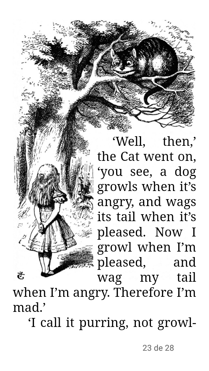

They break the cardinal rule to keep it as simple as possible.

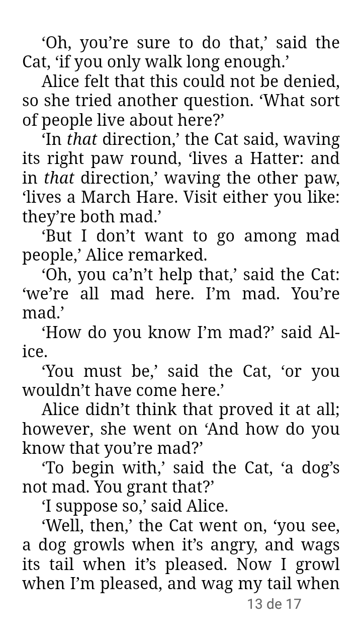

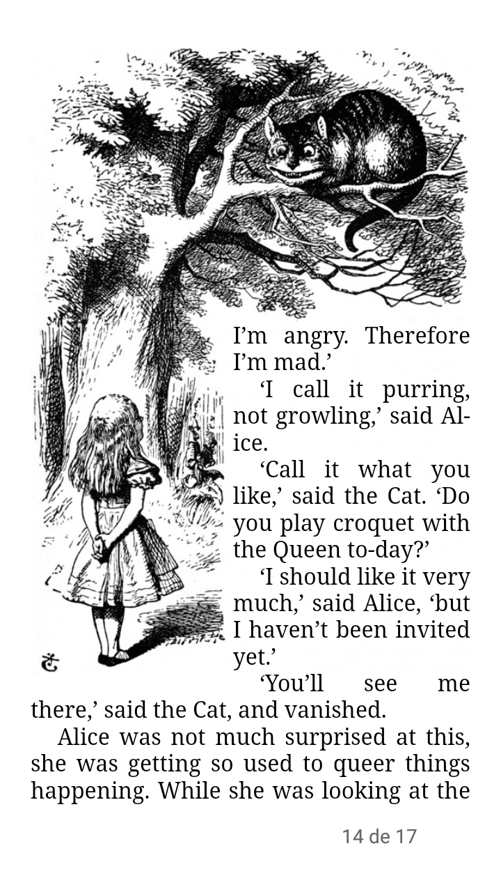

That rule doesn't exist; it was created for lazy men. Epubs must be epub3 with fallback code for epub2, so the users with a proper device can get the best reading experience. Look at these pictures:
ID:	207473 Click image for larger version
ID:	207474 Click image for larger version

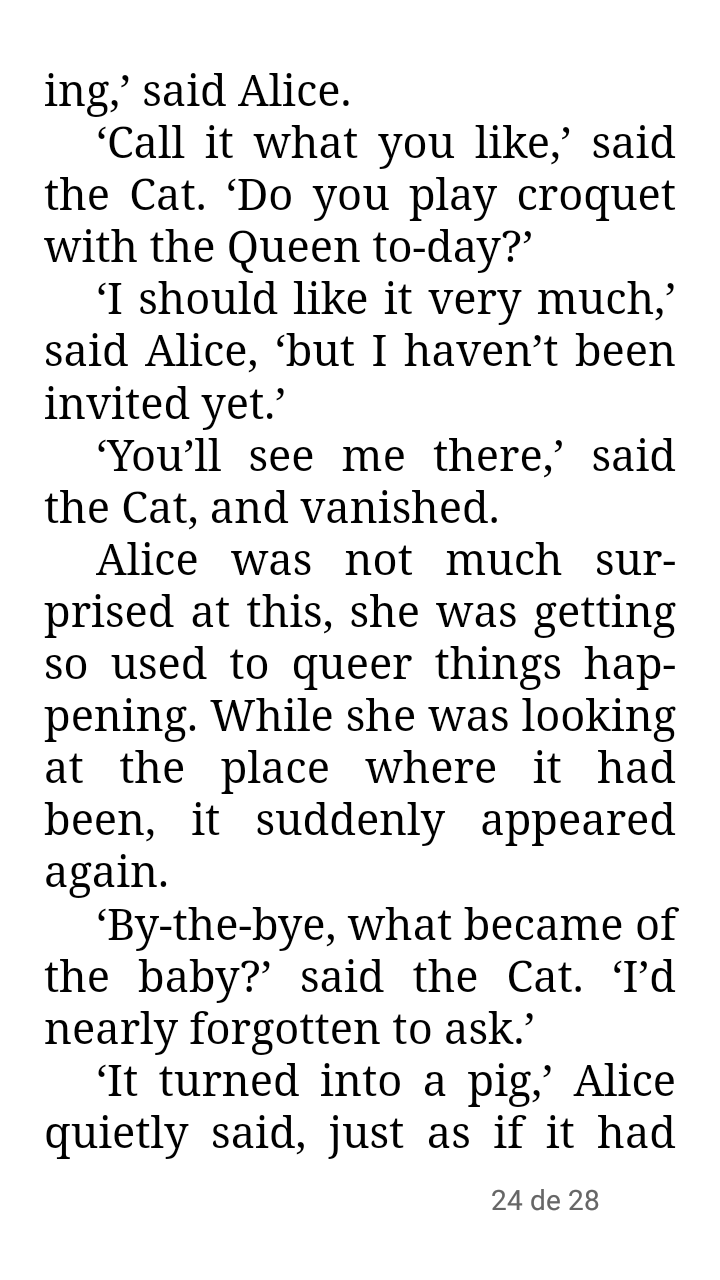

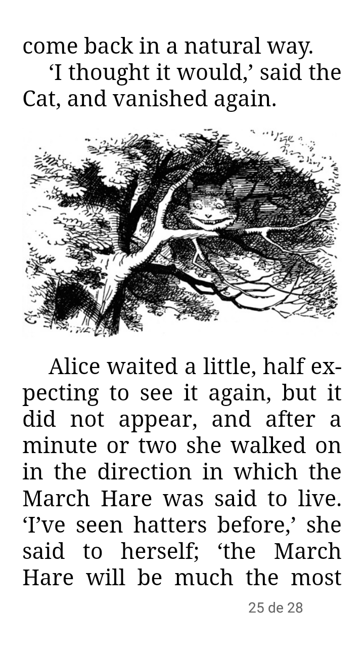

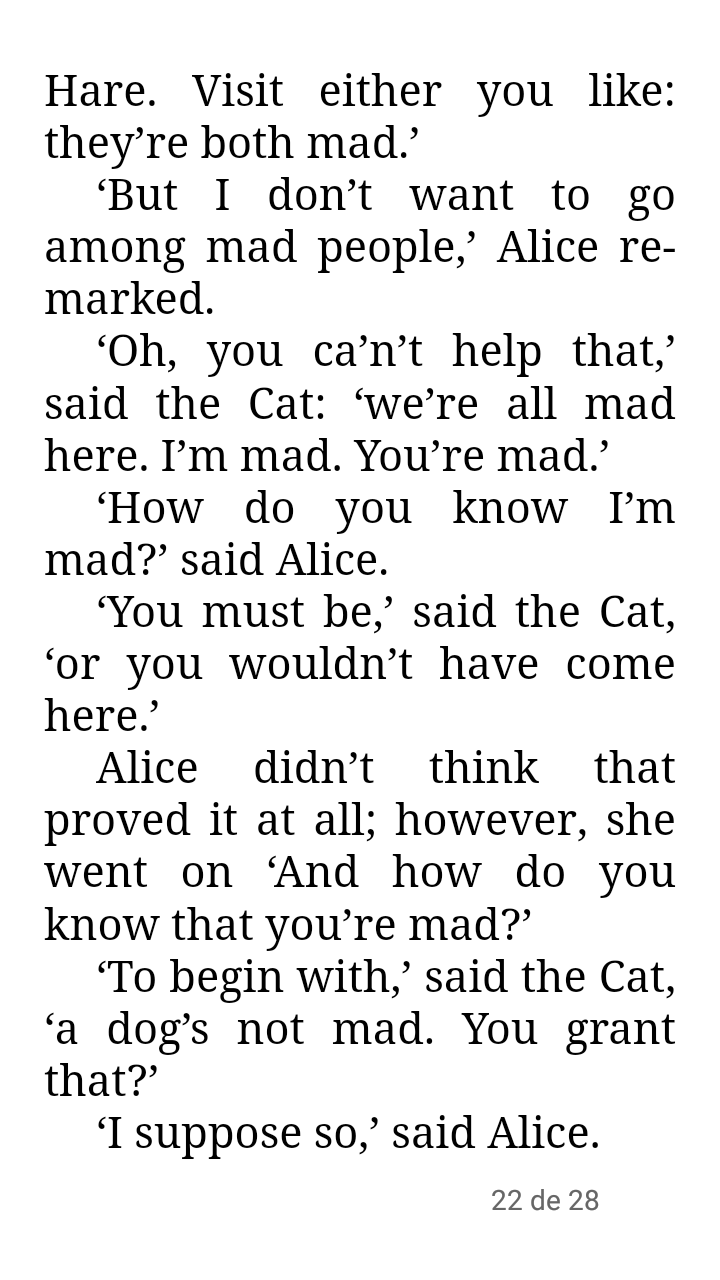

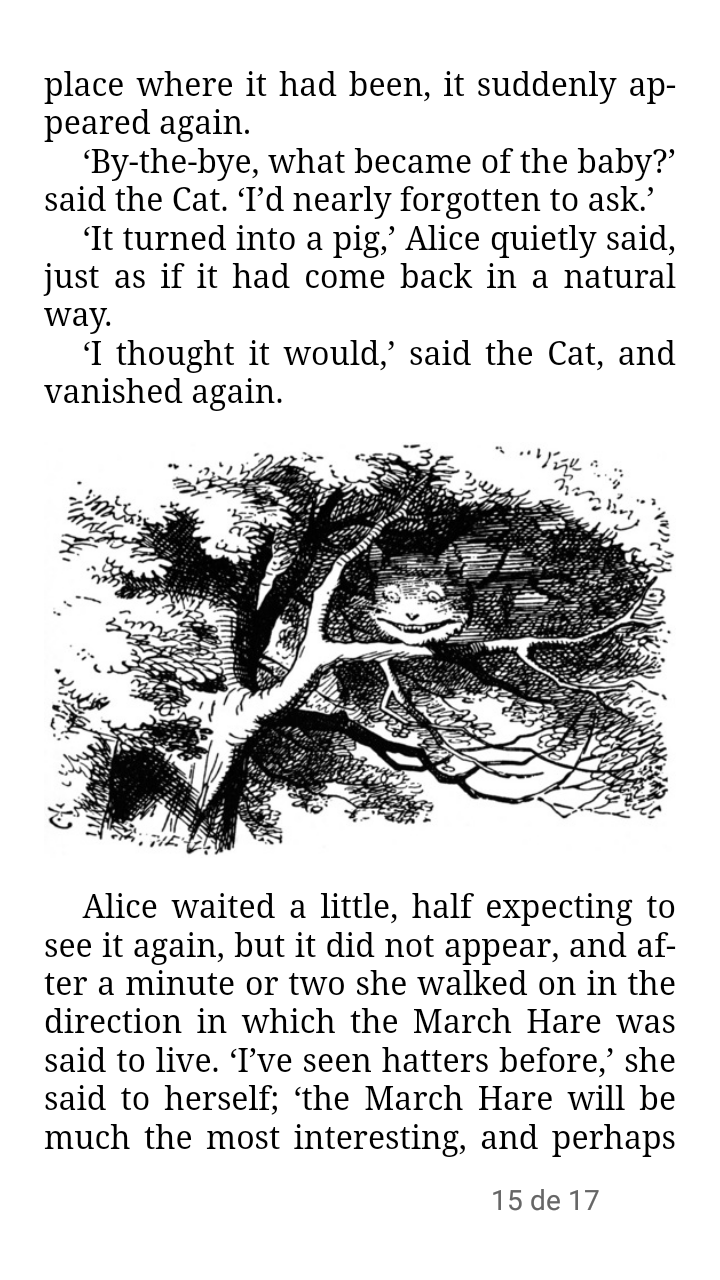

And now after increasing the font size:
ID:	207476 Click image for larger version
ID:	207479 Click image for larger version
Those pictures are from "Alice in wonderland" and belong to Kobo for Android. Try doing the same with basic css code; you won't be able; you'll have a lot of blank spaces here and there. The best reading experience can't be get with "KISS" code.

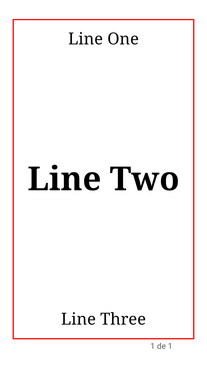

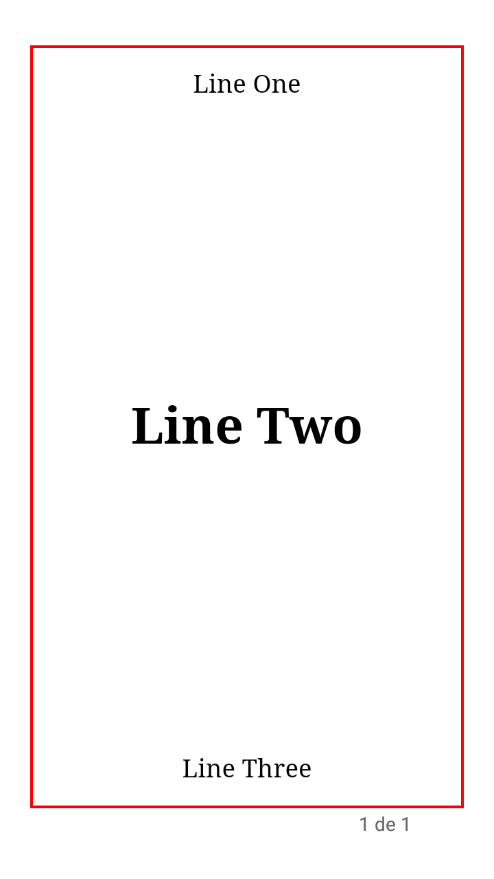

The eBook I mentioned and posted CSS from is simply formatted and does not need such complex code that StandardEbooks use. Also, you won't use more complex code where it's needed and not where it's not.
Yes, I can understand that, we are not going to kill a mosquito with a cannon. But even ebooks that are simply formatted, we can use advanced code with advantage. I give you an example, look at these pictures:
and after increasing the font-size:
Those pictures are taken from Kobo for Android. And they represent layouts very common. How do you code that in a simpler way? One line of text at top, one line at bottom and a perfect centered line (and the layout is retained no matter the font size). The simpler code is:
1) In the xhtml:
  <div class="block">
    <p>Line One</p>
    <p>Line Two</p>
    <p>Line Three</p>
  </div>
Simpler than that?
2) In the .css:
p {
   margin: 0;
.block {
   display: flex;
   flex-flow: column nowrap;
   justify-content: space-between;
   align-content: center;
   align-items: center;
   height: 99vh;
   border: 2px solid red;
   margin: 0;
.block p:nth-child(2n+1) {
   padding: 5% 0;
.block p:nth-child(2) {
   font-size: 2em;
   font-weight: bold;
With css2 properties you never can get the same perfect output. Even for simple layouts, you can use "advanced" (is not advanced at all) code to get optimal results.

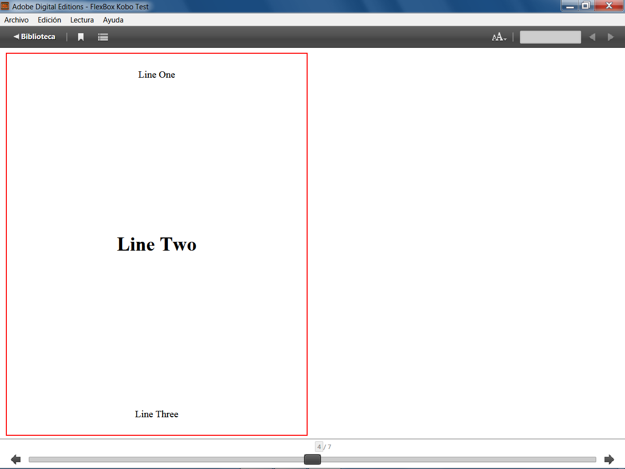

It doesn't work correctly in Thorium Reader for Windows.
You must have made a mistake. It DOES work in Thorium:
and also in ADE 4.x:
It works everywhere that supports flex-box.
But the point is not that. The point is that one can employ "fancy" code for simple layouts, so users with a proper device can get the best reading experience, and since you also have included fallback code, users with old device will get a suboptimal output. With flex-box, you'll get all perfectly spaced, no need to calc margins, no need to worry about anything. And all always perfect no matter if the font-size is increased. As I said, you can't get that with only css2 properties (of course, you'll have to employ them because of the fallback code, but the result won't be so good for all of them with old devices).
