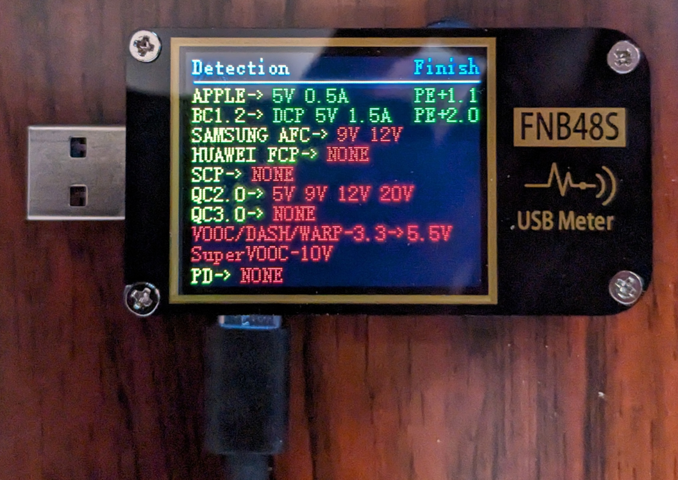

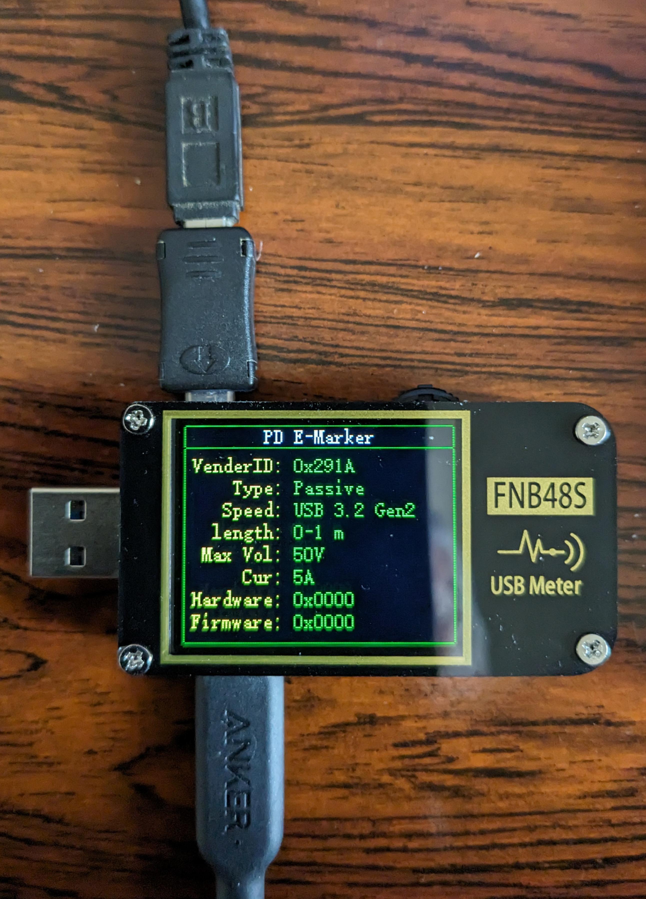

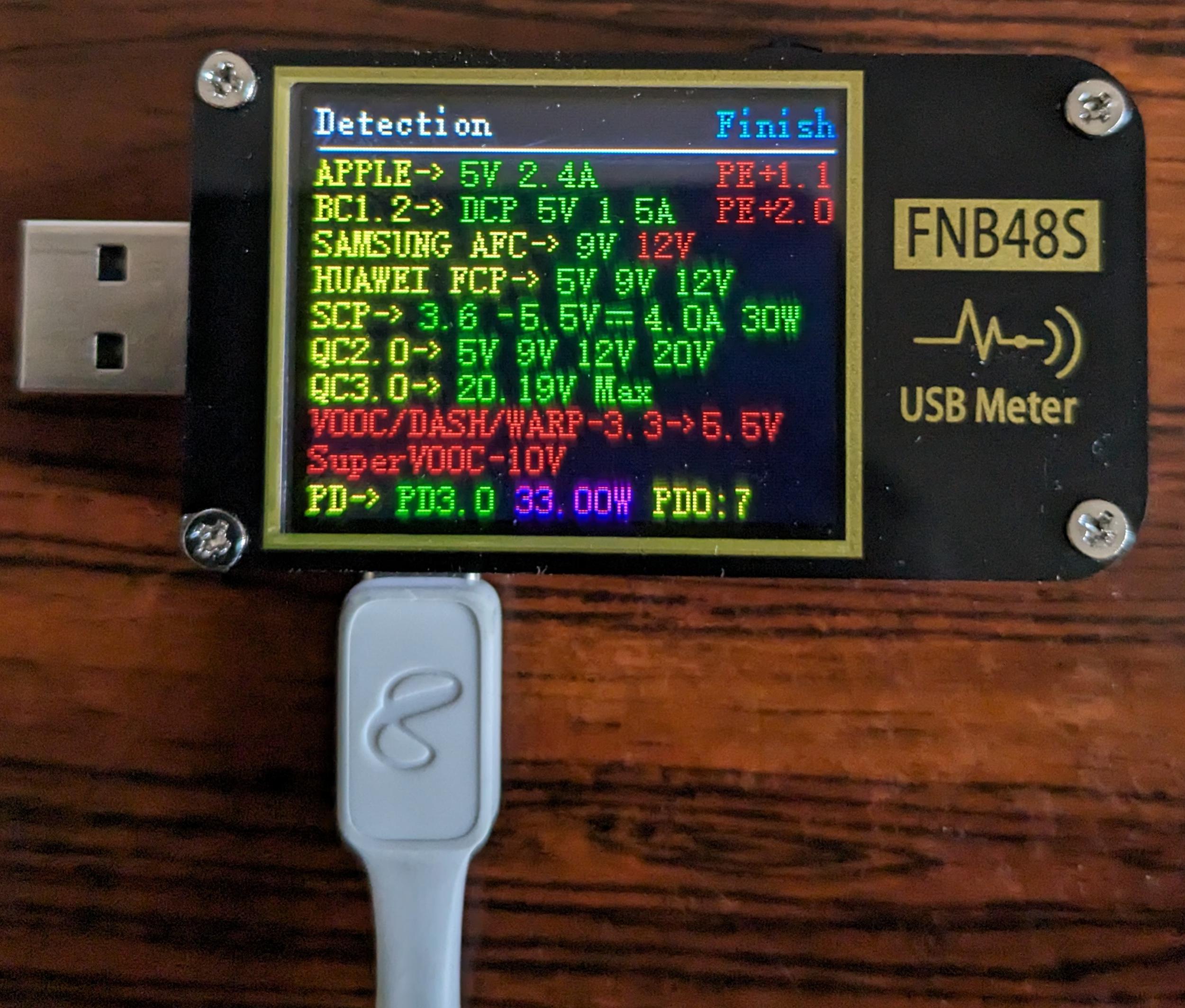

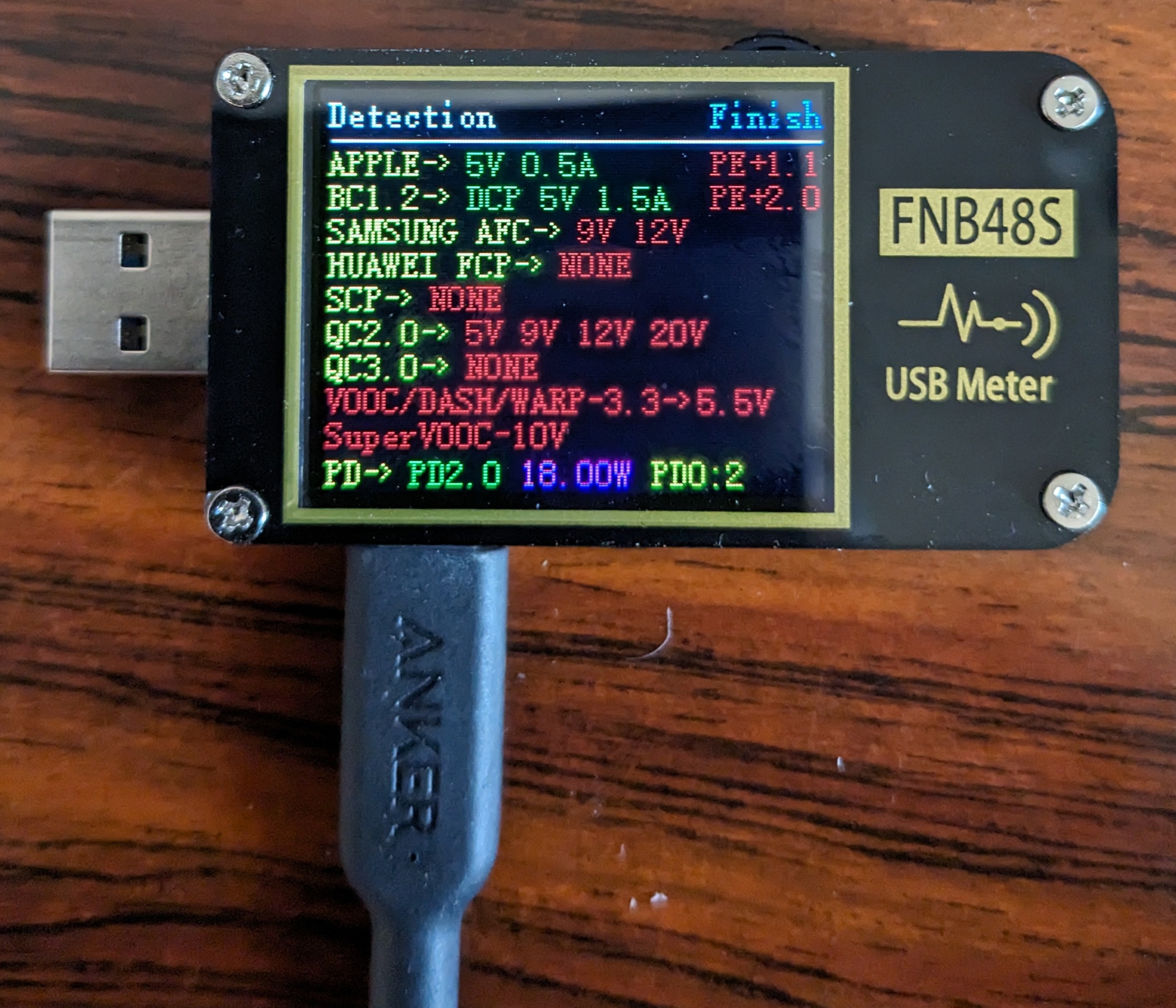

The "intelligence" I'm referring to is that it can be approached to reveal certain aspects. See attachment: I've a handy gizmo that reveals something of USB-C cables. I use it for example to see whether the cable I bought is indeed genuine (Vendor ID). Further, this gizmo can say something about the attached charger.
The 2nd picture provides the capabilities of the charger I mostly use for the Nxtpaper 11, while the 3rd picture lists the capabilities of the TCL provided charger. The 4th picture list the charger I use for all my smartphone as it has the most capabilities. (Green shows what can be got from the charger)

The 3rd pic doesn't show any 9V and 12V, which is marked on the charger. It can't be doing only 5V @ 1.5A.
Interesting gadget.

It is and can be had with amazon: FNB48S and its followup FNB58 (which is encased in aluminum).
Beware though: its information provided is to be regarded for indication only. Don't expect very precise details.
WARNING: the user manual is crap, and you can fry your Device Under Test when handling it wrong!
It does actually: QC version 2.0 can be delivered for 5V, 9V, 12V and 20V. However, it is not active as the device is just the USB meter itself, and no actual load (like a tablet) is present.
The USB meter just asks the charger what it can deliver for predefined protocols. That is what you see.
Funny fact: when I connected the NxtPaper 11 to a PD-only charger, the NxtPaper showed an info message, stating: Very slow charger. Please use another charger like the one provided with the tablet. The NxtPaper has power management beyond my smartphone
