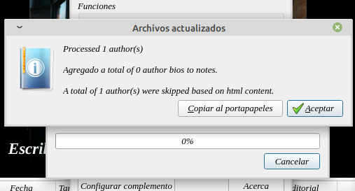

Thank you very much for the plugin, it's works ok for me but... what's the meaning of this when it's not able to download information about an author (book is in goodreads):
calibre, version 7.2.0
Updated files: Processed 0 author(s)
Added a total of 0 author bios to notes.
A total of 1 author(s) were skipped based on html content.
If you are a librarian on Goodreads you can add data on books with authors, I will leave it for you as information.

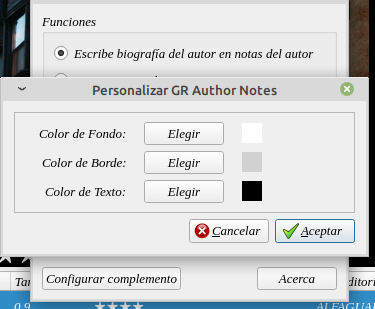

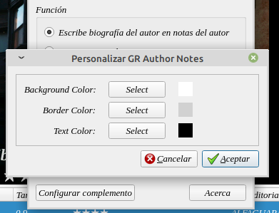

It is seen that by modifying the code some translations were lost.
There are some sequences that at first the translation took but now it doesn't.
The code paragraph is in main.py
  canceledtext = _(f'Process was canceled after updating {dlg.authorstotal} author(s) \n\n{event} a total of {dlg.authorstotal} author bios to notes.\n\n')
             processedtext = _(f'Processed {len(authors)} author(s) \n\n{event} a total of {dlg.authorstotal} author bios to notes. \n\n')
             return _(f'{text}A total of {dlg.skippedtotal} author(s) were skipped based on html content.')
I will not put the correction here, of what has already been translated until I can solve it.

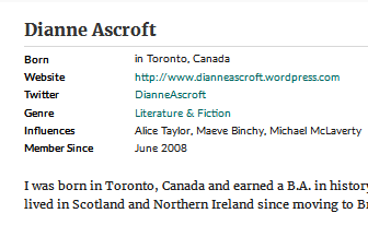

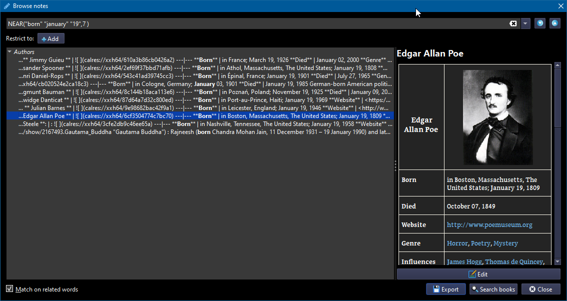

Hi @azuravian, thanks again for this awesome plugin. I'm using it also on the book details section via custom column, so I made a modification to its html to make the output more compact. Now there's a technical adjustment beyond my knowledge that you might be able to do, if you find it necessary: can the plugin get the Author birth data from the mobile page, instead of the desktop one?
Take this author for instance:
https://www.goodreads.com/author/sho...Dianne_Ascroft
Name:	desktop MWSnap 2024-03-29, 05_40_32.png
The plugin downloads this info:
Born in Toronto, Canada
However, the mobile page displays more complete data, which can be accessed on this link at the website footer: https://www.goodreads.com/toggle_mobile. At the end of the mobile page, on the right side, there's a spoiler-like expanding arrow that will show the full info on a section called "Author Details":
Born in Toronto, Canada on January 19, 1960.
Name:	mobile MWSnap 2024-03-29, 05_41_16.png
This info is useful to filter authors born on a given date, using the FTS-like Notes search, like this:
Name:	2024-03-29 05_39_28-Browse notes.png
Unfortunately, the URL is the same for both website versions, so this would need a cookie to be passed, as coders say here. The cookie name is mobvious.device_type, I've attached them in case you want to take a look.
