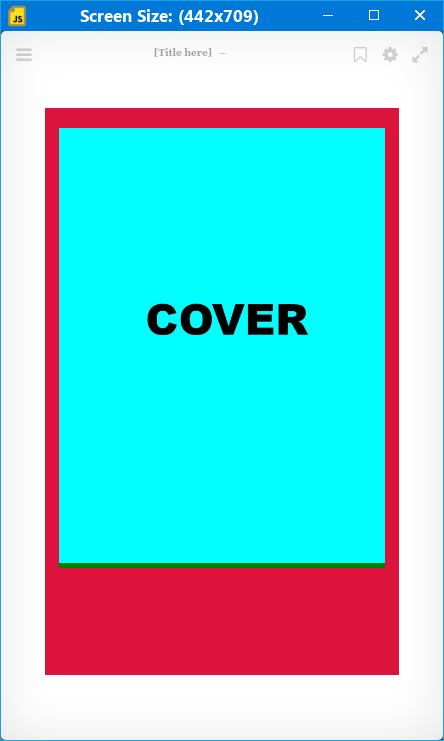

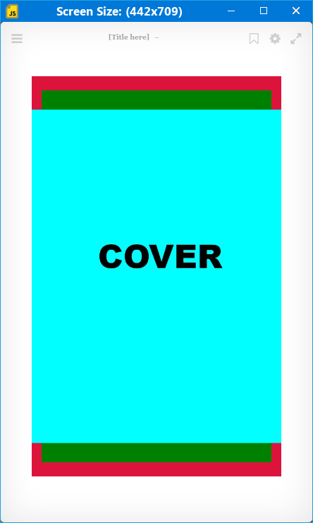

Why not to use a simple svg wrapper? If we were to use a simple svg wrapper, for example:
<body style="background: crimson">
  <div style="background: green">
	<svg
	xmlns="http://www.w3.org/2000/svg"
	height="100%"  width="100%"
	preserveAspectRatio="xMidYMid meet"
	version="1.1"
	viewBox="0 0 600 800"
	xmlns:xlink="http://www.w3.org/1999/xlink">
	<image width="600" height="800" xlink:href="../Images/Cover.jpg"/>
	</svg>
  </div>
</body>
the image would maintain the proportion but we can't have the cover vertically centered; watch the following screenshot of Readium and EpubJS Reader:
ID:	205481 Click image for larger version
In crimson color you can see the body space and in green you can see the space of the svg wrapper. And as the size of the svg wrapper (what is in green) is practically the same as the image, then the svg property preserveAspectRatio="xMidYMid meet" does not take place. We need to do the svg wrapper bigger and we do that with:

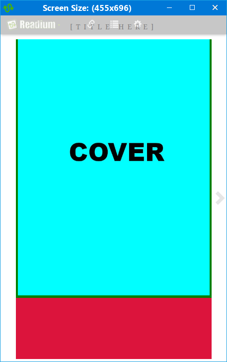

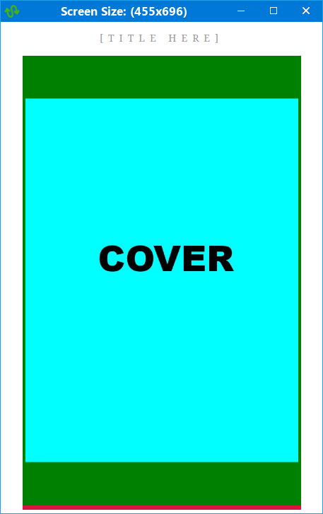

and putting the wrapper inside that space! If now we add a background color to our original code, we have:
<body class="cover" style="background: crimson">
  <div class="picWrapper" style="background: green">
    <svg class="pic"
    height="100%"
    version="1.1"
    width="100%"
      <image height="800" width="600" xlink:href="../Images/Cover.jpg"/>
    </svg>
  </div>
</body>
and here is how look the things under Readium and EpubJS:
ID:	205483 Click image for larger version
As you can see, now the svg wrapper (what is in green) take pratically all the body space (what is in crimson). and as the svg wrapper now is quite bigger than the image inside it, then the preserveAspectRatio="xMidYMid meet" property can take place and the cover is centered, that is the #3 condition that a cover must have (at least, to me ).
Well, that's all. The body space (what is in crimson) is bigger than the svg wrapper (what is in green) that is bigger than the cover (although in EpubJS the cover is so wide as the body, but that is a nice "drawback"). Of course, maybe this code may fail, but so far, is working everywhere
