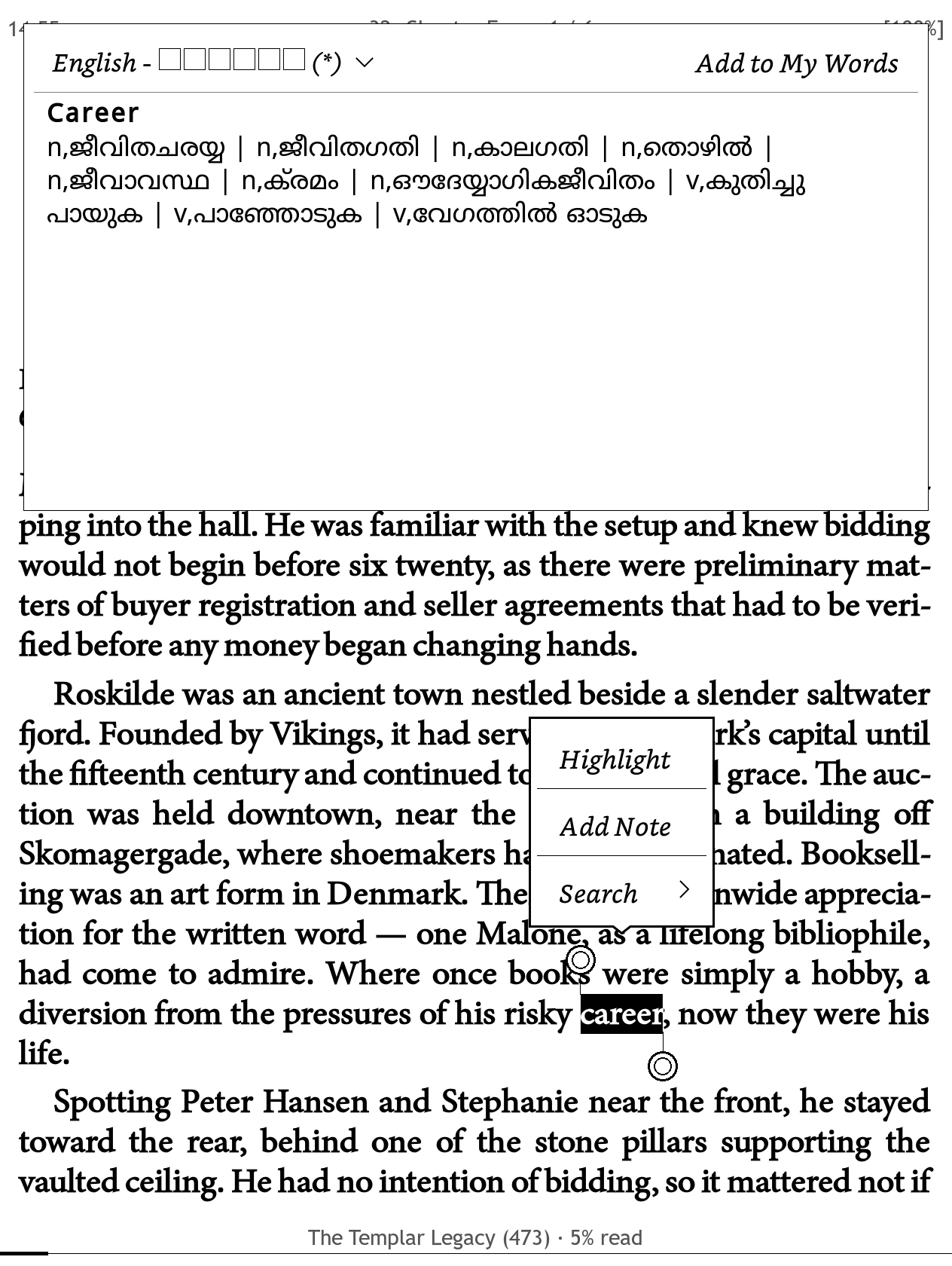

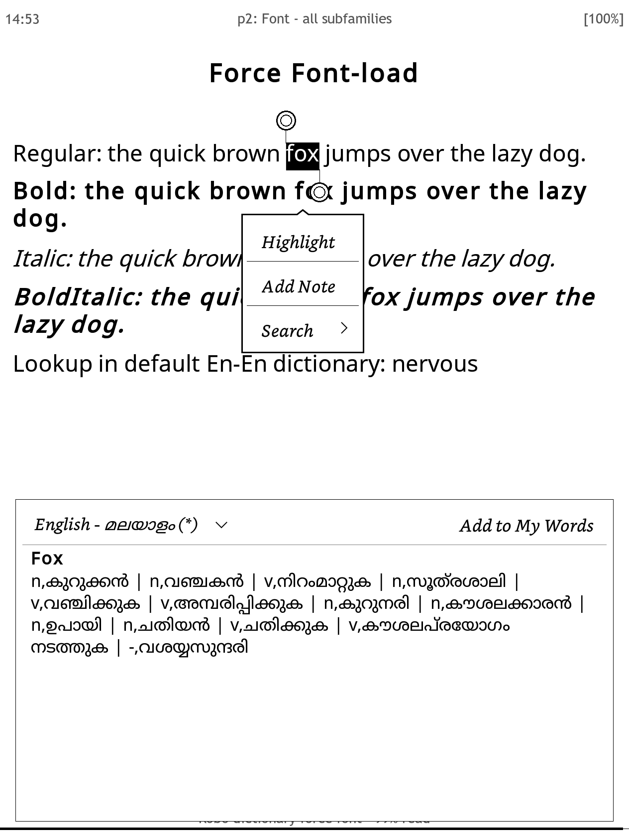

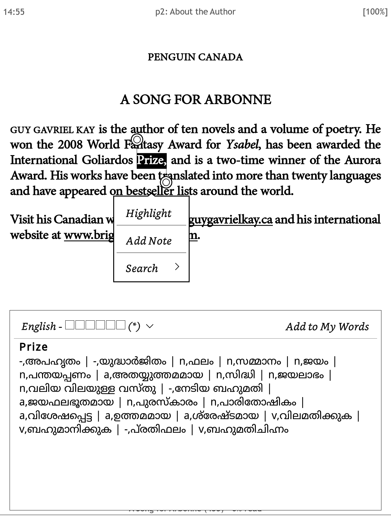

I've installed your 'Noto Sans Malayalam' font (regular only) and your dicthtml-en-ml.zip translation dictionary on my Libra2. I also customised the patch as you originally quoted:
  - ReplaceString: {Offset: 54, Find: "%4, serif            ", Replace: "'Noto Sans Malayalam'", MustMatchLength: yes}
If I follow the steps I outlined in post #30 after a reboot, everything appears to work as expected. See screenshots below. The only exception is the dictionary's name label on the top line of the pop-up (Pic2/Pic3).
It doesn't seem to matter which epub/kepub I open/re-open, if I do a dictionary lookup (any dictionary) the word definition uses the Malayalam Regular font for the parts of the definition which are intended to be displayed as Regular. I don't know how to fix the dictionary label's Malayalam characters but if it's a problem, a simple renaming of dicthtml-en-ml.zip may be the easiest workaround.
  • Pic1: The test kepub with its [Aa] font set/stored as 'Noto Sans Malayalam' and its dictionary set/stored as 'En-Malayalam'. I've attached a copy of the test kepub I use in case it's any help. You can just drag-drop it to your Kobo.
  • Pic2: A dictionary lookup using the 'En-Malayalam' dictionary in a random English KEPUB on the Libra2 with its [Aa] font set to my normal reading font.
  • Pic3: Same as Pic2 except using an EPUB.
