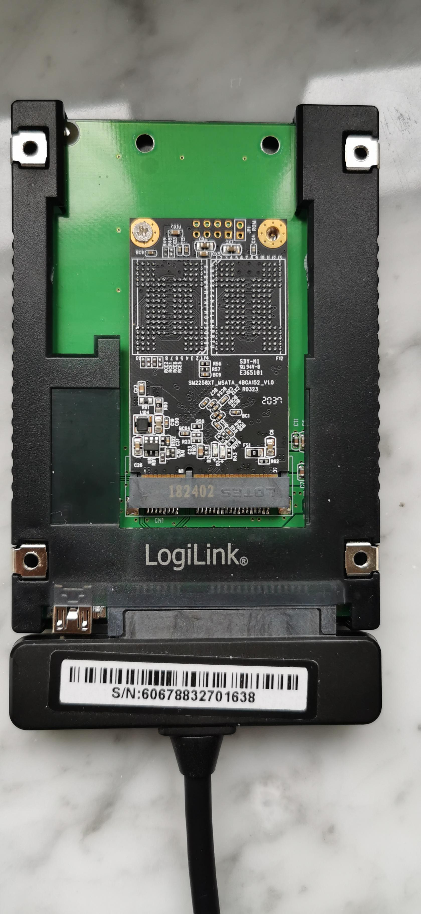

I'm just formatting a 128gb stick and a 500gb Dogfish SSD mSATA Shark I
If it would be better to put -eg - the system on the mSATA, I'll do that and start installing everything again from the beginning

looks like that

@huber70
Install the OS on the SSD or the USB stick (not both ;-) ).
Remove the SD card.
And I would use either the SSD or the USB-stick, not both.
I have never heard of Dogfish SSD's. It has a strange form factor, but it should work!

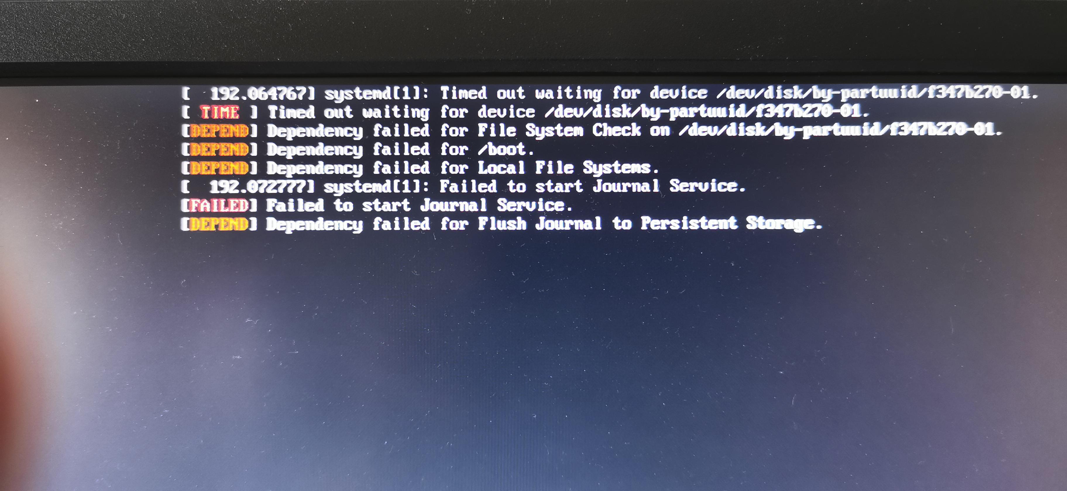

sorry, failed
