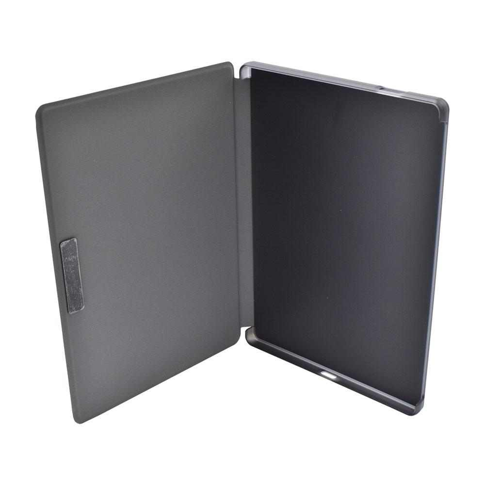

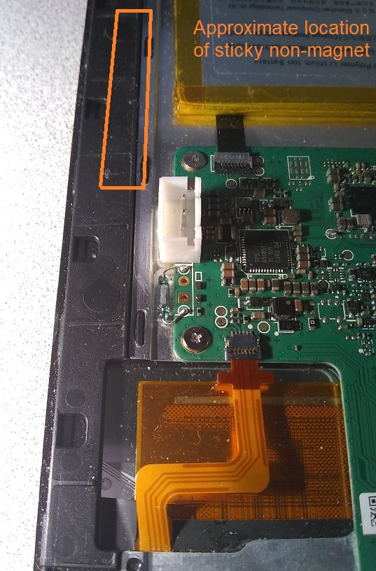

Originally Posted by CrazyCoder View Post
Yes, the cover has a magnet and it reacts on it.
Does it really have a magnet?
I'm puzzled by it. Neither the cover nor the Poke3 seems to have the least magnetic affinity.
I thought for a while that maybe the "sticky rectangle" on the cover was activating the edge of the capacitive sensing on the screen.
I have taken apart my Poke3 and I don't see anything on the PCB.
I didn't take up the PCB, but I'm still puzzled.
I'm thinking some kind of RF sensor, although a real Hall sensor would be lower power.
I dunno.
Yes, I checked with another magnet that there is one on the inside of the cover, at the bottom, this area probably aligns with a sensor below the buttons. If I put any magnet in that area, the device goes to sleep.

I've tried with magnetics. They don't do anything, either polarity.
The Poke3 has a little sticky like an anti-theft thingy in a store.
