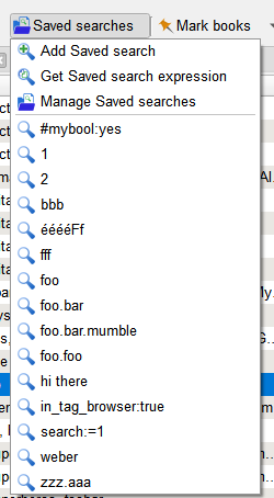

Built-in toolbar option. You'll need to run from source or wait for the next update.
EDIT: Here's a screenshit:
Attachment 197240
assuming that this is the build‐in «saved searches», how are you able to add folder to it?
Go to Preferences > Look & Feel > Tag Browser > Hierarchy and searching, and select "Saved Searches."
Then create a saved search named something like foo.bar — the period is what's important. 'foo' will appear as a folder. (If you also have a 'foo' search, it'll appear as a separate entry - see the 'recently added' entries on my screnshot.)

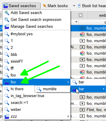

Since you brought this up: I have been debating with myself this case. Given a search "foo" and a hierarchy "foo.something", where should be "foo" search go?
This is what it does today. The "foo" search is on the upper level, followed by a menu containing the "something".

Here is an example where the "foo" search goes inside the menu at the top. It has a "search" icon and is suffixed by the word "Parent" to distinguish it from a possible search "foo.foo"

And here is an example where there is no "foo" search (in this case "zzz").
I really don't know which is better. Opinions?

That was also something I thought of (and then forgot before I made a ticket ). I like the second option - if feasible, it would look nice if it was divided from the 'subsearches' with a divider.
