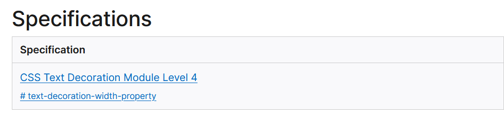

I can use text-decoration-thickness to change the thickness of that line and make it more visible. When I try, the Calibre editor "check book" function doesn't recognize it ("Unknown property").
To quote from the Mozilla page you linked to in the Specification section:
CSS Text Decoration Module Level 4
Yep. Sorry. I didn't see that note about the spec level. Also, even if I had seen it, I don't think I'd have realized what it meant. But, after doing a bit more searching on text-decoration-width (which, as Turtle91 pointed out was the earlier term for text-decoration-thickness), I came across this 2016 issue in Github about it:
https://github.com/w3c/csswg-drafts/issues/239
Blood was flowing a bit in there. That issue was closed in 2017 because the proposed text-decoration-width solution was accepted into the draft spec of the next css version:
https://drafts.csswg.org/css-text-de...kness-property
It's also interesting that the 2017 issue referenced a 2012 message on the same problem:
https://lists.w3.org/Archives/Public...2Jul/0445.html
Regardless, I don't think there's any way around this until either something is fixed with kepubs or the next css version goes live.

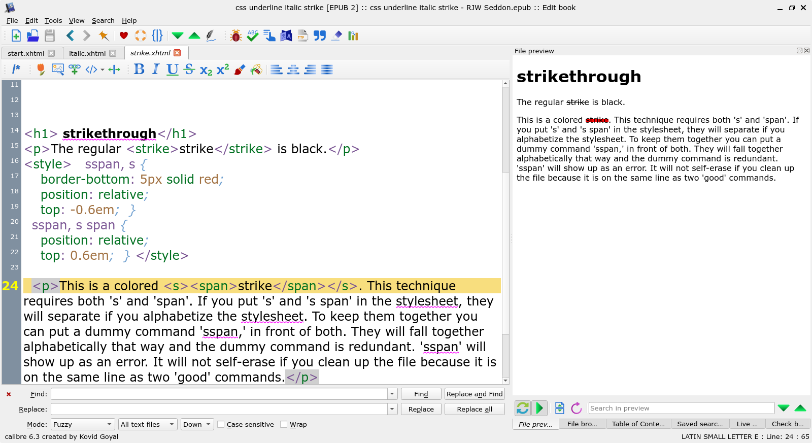

strikethrough any font, any thickness, any color
this is a work around which is a lot of trouble to go to.

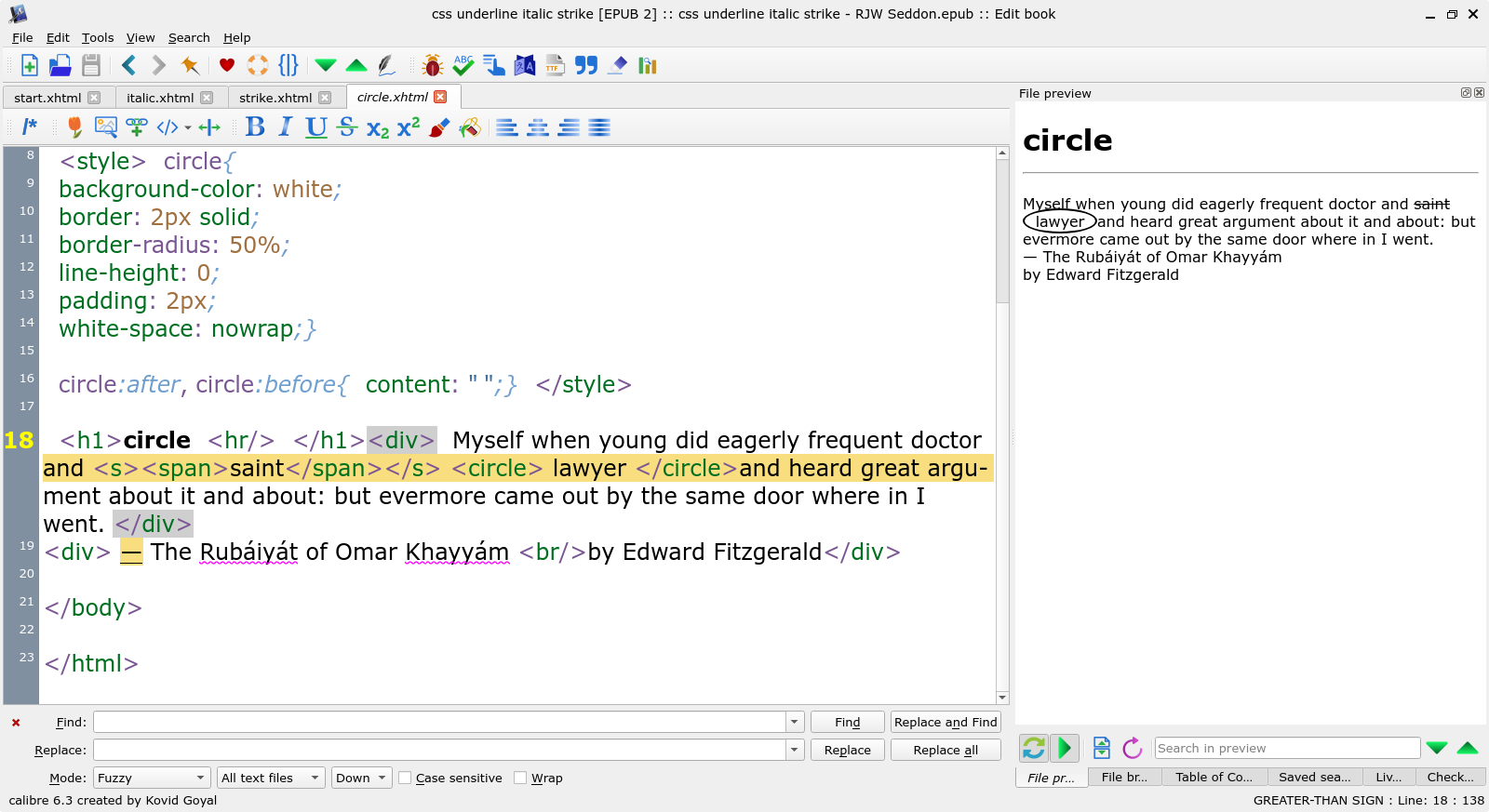

After doing a strikethrough sometimes there will be new text replacing it. Here is an emphatic way of doing that. Pop
rjwse@aol.com is offline   Reply With Quote

The circle looks terrible and I've never seen that. Colour is a bad idea for ebooks as about 1/2 are consumed on eInk.
