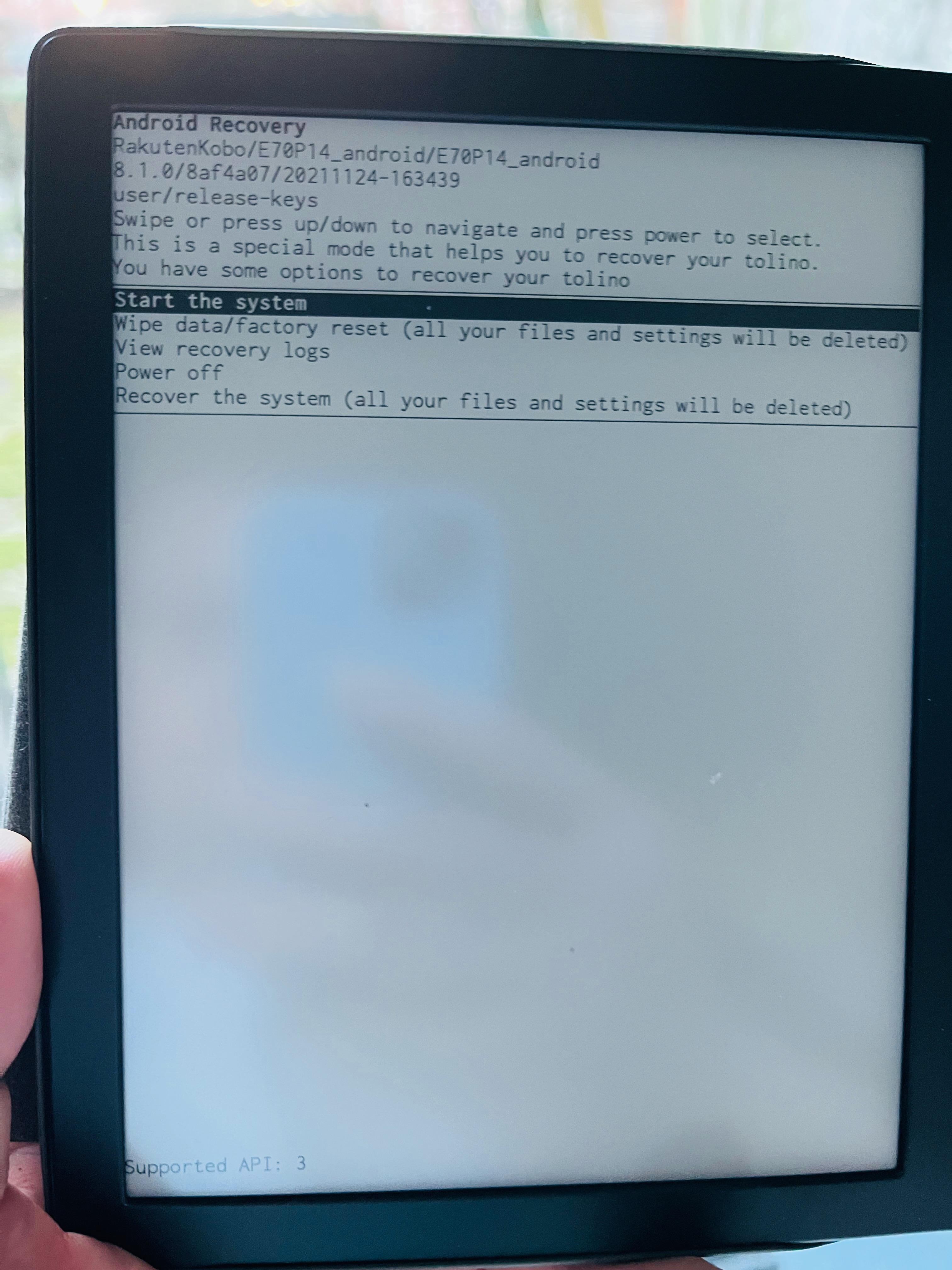

Sorry for the fast writing with quite a few mistakes, new keyboard, no background light on the keys.... etc etc.
Calibre 5x is up and running, connecting with the tolino Vision 6 was supposed to be solved and working, but mine is not recognised.
Wether it is due to changes in latest Firmware Update for the tolino Vision 6 or the Mac, I am not sure. Also not sure what system the person (Forrester?) used to write the driver.
openMTP worked after a fresh download&installation. But not tested long, just copying epubs.
Also I had the very first hard crash. Was on a page of a bought epub (Bloodless - Agent Pendergast, Preston&Child), with DRM, when the tolino Vision 6 froze. Had to press off+button for a long time, then the screen blinked, and got a text screen from android with reboot / whipe as a choice, warning me that whiping the system would erase every book, every setting etc. .
Chose reboot and that worked. Picture was taken, will try to upload.

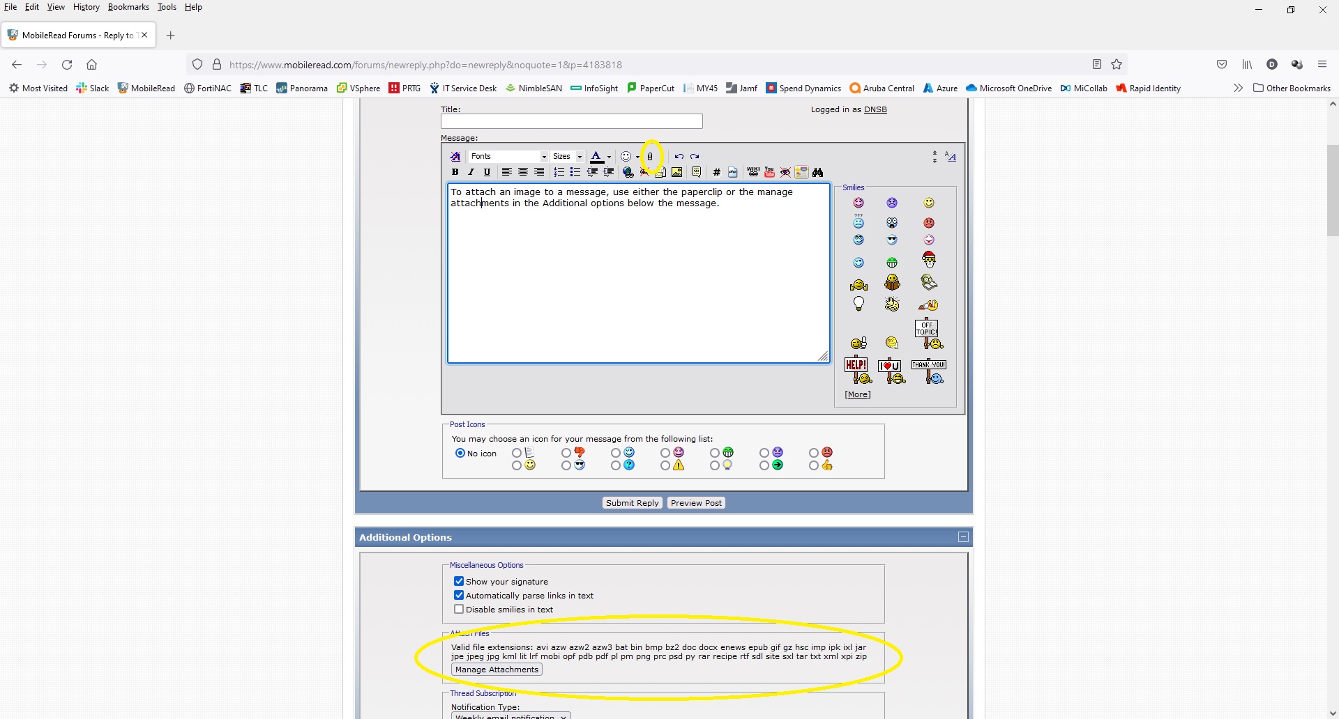

Ok, no upload, as it wants a URL. Sorry too much work today.
justloveebooks is offline   Reply With Quote
Old 12-26-2021, 10:15 AM   #44
Posts: 51,365
Karma: 179640714
To attach an image to a message, use either the paperclip or the manage attachments in the Additional options below the message.
Old 01-01-2022, 07:22 AM   #45
justloveebooks
justloveebooks began at the beginning.
justloveebooks's Avatar
Posts: 28
Join Date: Oct 2011
Location: World
Device: Tolino Vision 6, Kindle Voyage 2x,Sony PRS-T1 rooted,Sony Prs-505
Tanks for the help, did not scroll down and never saw the options...
Here is the picture, screen after the tolino Vision 6 crashed.
