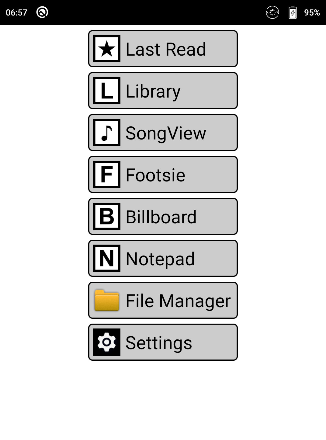

Originally Posted by Grorom View Post
Is there a launcher you suggest being good with black & white screens
I'm boring and don't use a lot of apps on my eReaders (and the ones I do, I wrote). This is my launcher, but it wouldn't suit you as the links are fixed and soon I'll be ready to delete Footsie.
